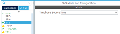

just give it (select in Cube...) a timer , you anyway not need for your program, i took TIM6 :
Then it uses this and adjust it...you dont need to care about it.

2024-06-28 1:52 AM
Hmmm...
1. you can only select timers, that are not used (by you), state : grey, unused on left side.
2. timers (in clock tree need a clock...) check in clock tree, you have clocks everywhere:
