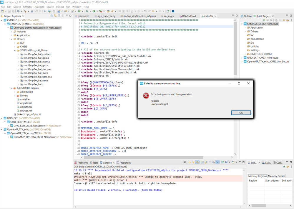

I'm trying to build CM0PLUS_DEMO for STM32MP257x-EV1 for the cortex-M0 core.

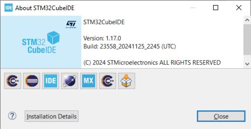

I got planty of errors when trying to build it with STM32CubeIDE Version: 1.17.0 Build: 23558_20241125_2245 (UTC):
Failed to generate command line.
reason: Unknown target.

Just tested and it works fine at my end on Windows.
Are you on windows or Ubuntu station ?
Can you share logs and screenshots ?

Which version of en.stm32cubemp2 and CubeIDE are you using?

Just clicking C/C++ Build --> Settings --> MCU/MPU Settings..... produce the same errors screens as when building:
   Error during command line generation
   Reason:
   Unknown target
