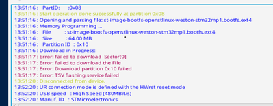

I'm using a STM32MP157F-DK2 and I don't know if this could be your problem: I was having intermittent problems when trying to flash. The STM Linux Device was told to disconnect and would not reconnect. I would have to restart the DK2 because that port was dead.
What fixed my problems was disconnecting the cable from the USB Micro port.

@smanger It does look like our devices are getting deconnected. But yours seems to be working correctly for a few partitions dl. While mine seems to be deconnected at the very beginning (for the first partition dl).
You say what fixed your problem was disconnecting a micro USB cable ? But on my board (MP135F), I have only 2 USB-C cables (one for power and one for image flashing). Maybe our boards differ on that point idk.
