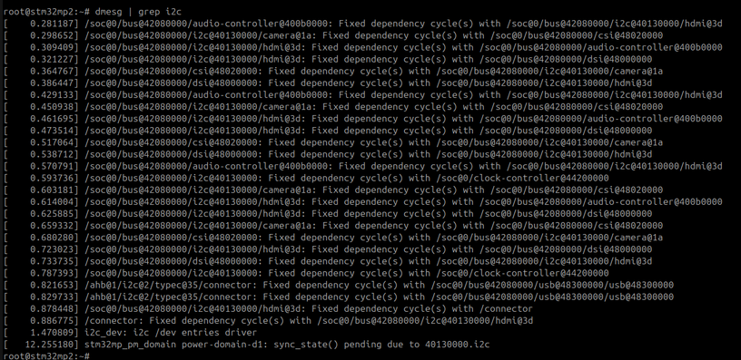

I'm working with the STM32MP257F-DK using the Yocto Project, and I'm trying to enable I2C in my custom Device Tree.
However, I’m facing an issue where the I2C controllers remain stuck because of power-domain pending states.
Here is the relevant dmesg output showing the problem:
It looks like the D1 power domain never reaches sync_state(), which prevents the I2C drivers from probing correctly.
I suspect a configuration issue in the power-domain hierarchy or in my SoC/board Device Tree, but I haven’t found the root cause yet.
Could someone help me understand what is missing to properly enable the I2C controllers and bring the D1 power domain out of the pending state?
Thanks in advance for your support.

Hello @Duc ,
Thank you for your response.
I tried enabling it in the configuration file, but it still doesn’t work. I would like to enable it using my custom Device Tree instead.
Here is the relevant dmesg output showing the power-domain pending states.
root@stm32mp2:~# dmesg | grep i2c
[ 0.281228] /soc@0/bus@42080000/audio-controller@400b0000: Fixed dependency cycle(s) with /soc@0/bus@42080000/i2c@40130000/hdmi@3d
[ 0.298683] /soc@0/bus@42080000/i2c@40130000/camera@1a: Fixed dependency cycle(s) with /soc@0/bus@42080000/csi@48020000
[ 0.309435] /soc@0/bus@42080000/i2c@40130000/hdmi@3d: Fixed dependency cycle(s) with /soc@0/bus@42080000/audio-controller@400b0000
[ 0.321240] /soc@0/bus@42080000/i2c@40130000/hdmi@3d: Fixed dependency cycle(s) with /soc@0/bus@42080000/dsi@48000000
[ 0.364726] /soc@0/bus@42080000/csi@48020000: Fixed dependency cycle(s) with /soc@0/bus@42080000/i2c@40130000/camera@1a
[ 0.386389] /soc@0/bus@42080000/dsi@48000000: Fixed dependency cycle(s) with /soc@0/bus@42080000/i2c@40130000/hdmi@3d
[ 0.429089] /soc@0/bus@42080000/audio-controller@400b0000: Fixed dependency cycle(s) with /soc@0/bus@42080000/i2c@40130000/hdmi@3d
[ 0.450863] /soc@0/bus@42080000/i2c@40130000/camera@1a: Fixed dependency cycle(s) with /soc@0/bus@42080000/csi@48020000
[ 0.461610] /soc@0/bus@42080000/i2c@40130000/hdmi@3d: Fixed dependency cycle(s) with /soc@0/bus@42080000/audio-controller@400b0000
[ 0.473417] /soc@0/bus@42080000/i2c@40130000/hdmi@3d: Fixed dependency cycle(s) with /soc@0/bus@42080000/dsi@48000000
[ 0.516910] /soc@0/bus@42080000/csi@48020000: Fixed dependency cycle(s) with /soc@0/bus@42080000/i2c@40130000/camera@1a
[ 0.538549] /soc@0/bus@42080000/dsi@48000000: Fixed dependency cycle(s) with /soc@0/bus@42080000/i2c@40130000/hdmi@3d
[ 0.570608] /soc@0/bus@42080000/audio-controller@400b0000: Fixed dependency cycle(s) with /soc@0/bus@42080000/i2c@40130000/hdmi@3d
[ 0.593522] /soc@0/bus@42080000/i2c@40130000: Fixed dependency cycle(s) with /soc@0/clock-controller@44200000
[ 0.602962] /soc@0/bus@42080000/i2c@40130000/camera@1a: Fixed dependency cycle(s) with /soc@0/bus@42080000/csi@48020000
[ 0.613774] /soc@0/bus@42080000/i2c@40130000/hdmi@3d: Fixed dependency cycle(s) with /soc@0/bus@42080000/audio-controller@400b0000
[ 0.625640] /soc@0/bus@42080000/i2c@40130000/hdmi@3d: Fixed dependency cycle(s) with /soc@0/bus@42080000/dsi@48000000
[ 0.659052] /soc@0/bus@42080000/i2c@40130000/camera@1a: Fixed dependency cycle(s) with /soc@0/bus@42080000/csi@48020000
[ 0.679986] /soc@0/bus@42080000/csi@48020000: Fixed dependency cycle(s) with /soc@0/bus@42080000/i2c@40130000/camera@1a
[ 0.722688] /soc@0/bus@42080000/i2c@40130000/hdmi@3d: Fixed dependency cycle(s) with /soc@0/bus@42080000/dsi@48000000
[ 0.733389] /soc@0/bus@42080000/dsi@48000000: Fixed dependency cycle(s) with /soc@0/bus@42080000/i2c@40130000/hdmi@3d
[ 0.787003] /soc@0/bus@42080000/i2c@40130000: Fixed dependency cycle(s) with /soc@0/clock-controller@44200000
[ 0.821260] /ahb@1/i2c@2/typec@35/connector: Fixed dependency cycle(s) with /soc@0/bus@42080000/usb@48300000/usb@48300000
[ 0.829353] /ahb@1/i2c@2/typec@35/connector: Fixed dependency cycle(s) with /soc@0/bus@42080000/usb@48300000/usb@48300000
[ 0.878013] /soc@0/bus@42080000/i2c@40130000/hdmi@3d: Fixed dependency cycle(s) with /connector
[ 0.886332] /connector: Fixed dependency cycle(s) with /soc@0/bus@42080000/i2c@40130000/hdmi@3d
[ 1.469779] i2c_dev: i2c /dev entries driver
[ 12.254738] stm32mp_pm_domain power-domain-d1: sync_state() pending due to 40130000.i2c
root@stm32mp2:~#
