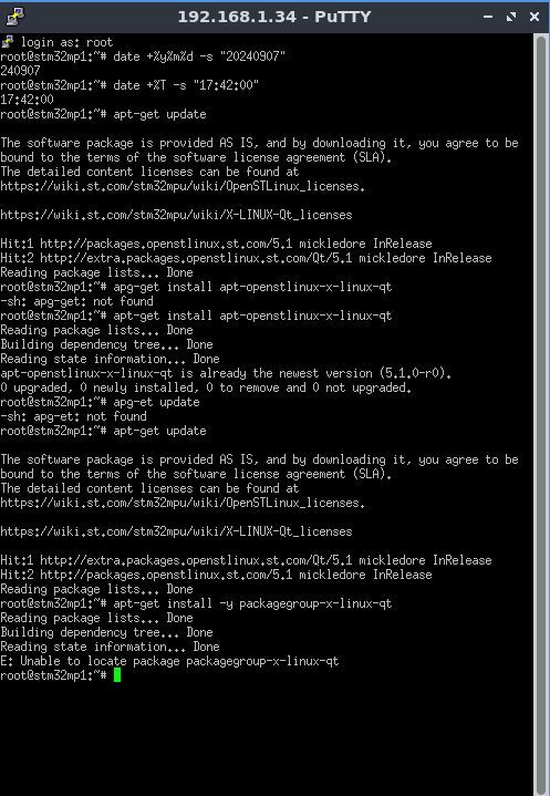

I tried to install QT
apt-get install -y packagegroup-x-linux-qt
But I got the error
E: Unable to locate package packagegroup-x-linux-qt
I have followed this
https://wiki.st.com/stm32mpu/wiki/X-LINUX-QT_Expansion_Package

2024-09-09 10:22 AM - edited 2024-09-09 10:25 AM
Still the same error as above. I think there might be an issue with the apt-get?
Notice that I'm using STM32MP1 starter package. Not STM32MP2 starter package.

Hi Daniel,
Starter Package for MP1 is not yet distributed. You will need to start from the X-LINUX-QT Distribution Package for the MP1 devices, then build the full image for it.
Please note that MP1 devices are still under testing internally so performances are not fully guaranteed to match the expected ones.
