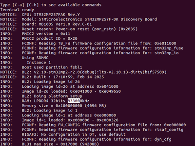

Hi
I was able to change the frequency in arm trusted firmware but it is still not changed in kernel.
Here the 933MHZ frequency is set, but in kernel when I read clk_rate for ck_icn_ddr it is still 600MHz.
What am I missing and how can i set it properly?
