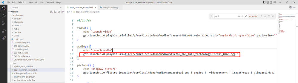

weston@stm32mp1:/home/root$I watched the weston demo that comes with the development board. But I didn't find the statement to switch to the user weston. May I ask how it calls the audio framework with the root user?
