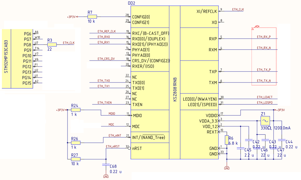

Could you share your HW Setup around KSZ8081RNB ?
Do you have 25MHz crystal on XI/XO pins or XI connected to ETH_CLK ?
Is the KSZ8081RNB REF_CLK pin connected to STM32MP15x REF_CLK pin ?
What is the config of KSZ8081RNB SW setting between 25MHz and 50MHz mode ?

Hi, Patrick.
The fragment of schematic is attached.
There is no crystal, XI is connected to ETH_CLK, REF_CLK is connected to STM32MP153.
I wrote my device tree as said in wiki, the ethernet fragment is shown in the first message. As I can see, my settings satisfy requirements from AN5031.

Did you check that your PHY is correctly setup to use 50MHz on XI ?
I understand from KSZ8081RNB datasheet that driver need to set internal KSZ8081RNB registers 0x1F bit 7 to enable that.
Did you check that the 50MHz output is present on pin PG8 ?

When I use ETH_CLK at 50 MHz all works perfectly, so I think the PHY is set up correctly.
I checked PHY setup when ETH_CLK was at 25 MHz and it seems that it also get correct setup (I added printf to kernel code and this register was set it should be).
Unfortunately I cannot test signals directly on STM32 pins because of BGA package. So I tested ETH_CLK on the R3 resistor and KSZ8081 input pin. At 50 MHz the signal is correct, but at 25 MHz there is no clock.

I tested ETH_REF_CLK when 25 MHz was absent and got a signal of about 28 MHz. As I cannot test in on STM32 BGA package I tested in using PCB via in the middle of the signal.
At the same time Ethernet worked in U-Boot but I don't know how.
