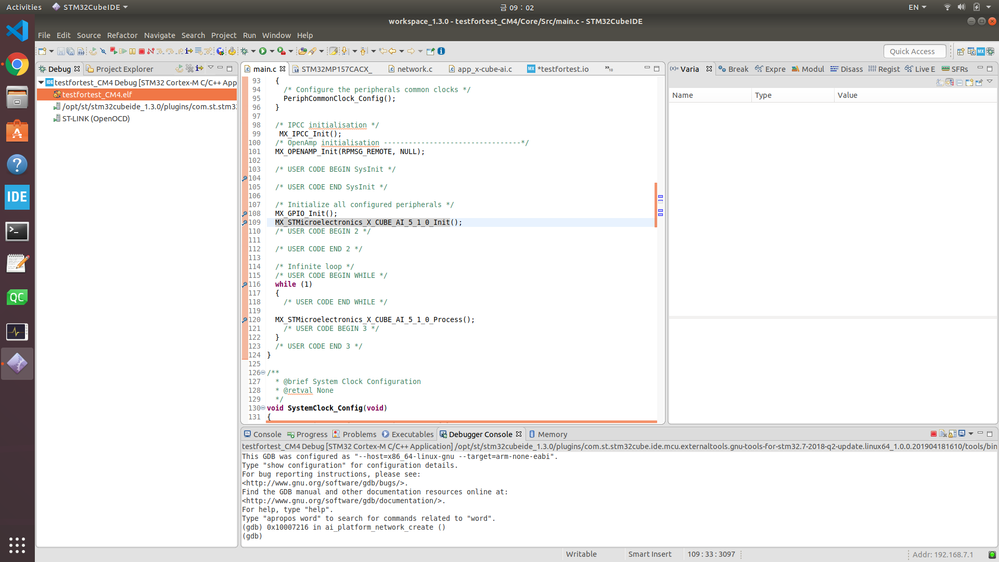

A project created by X-Cube-Ai 5.1.0 on STM32MP157-DK2 is stuck in an infinite loop.
MCho.1
Associate
I just made a pure x-cube-ai project with no user code included, and it is stuck at creating network object... I couldn't analyze this problem because it seems to be related to the network library.(prefix .a). Willing to help me out?
