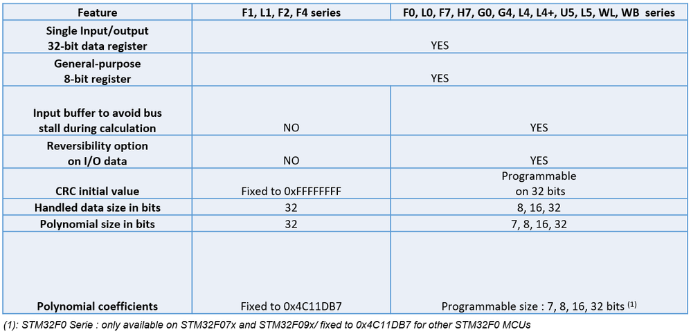

2. What are CRC features in STM32 MCUs?
The hardware CRC peripheral features vary from one STM32 to another, the main features are listed in table below:
If the feature “Reversibility option on I/O data” is enabled, each input and/or output byte is reflected before being used in the calculation. Bits of the input or/and output byte are used in reverse order.
Refer to the products’ Reference manual for detailed functional description of the CRC peripheral.
