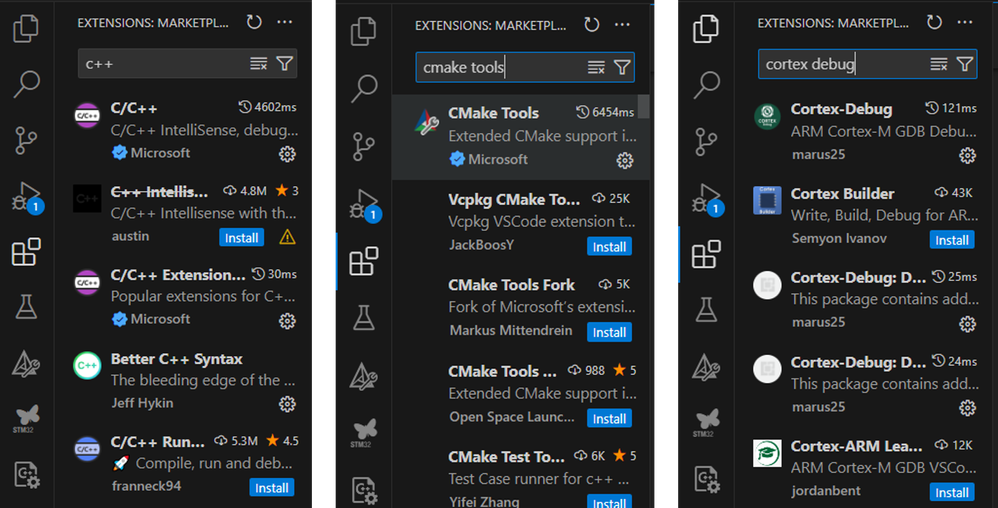

To work with FreeRTOS™ projects in VS Code, you need the following extensions:
  1. C/C++ extension: This extension provides C++ language support, including syntax highlighting and IntelliSense. This extension can be downloaded in the VS Code IDE.
  2. CMake tools extension: This extension provides a full-featured, convenient, and powerful workflow for CMake-based projects in visual studio code.
  3. Cortex®-Debug extension: This extension allows you to deploy and debug your FreeRTOS™ application on your target device. It supports various hardware debuggers and software.

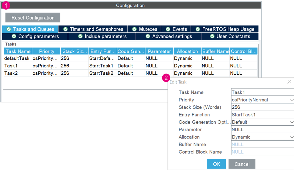

  • In [Tasks and Queues], create 2 tasks besides the default task as follows.

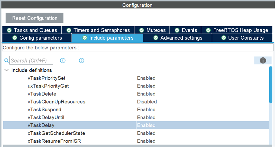

  • Make sure that [vTaskDelay] is set to [Enabled] in [Include parameters].
vTaskDelayvTaskDelay

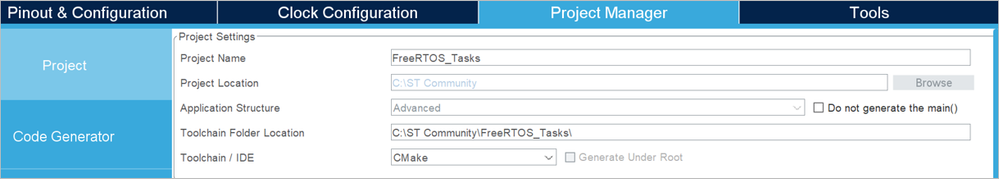

  • To generate the code for VS Code IDE go to the [Project manager] tab and select [CMake] as toolchain/IDE.
Project generationProject generation

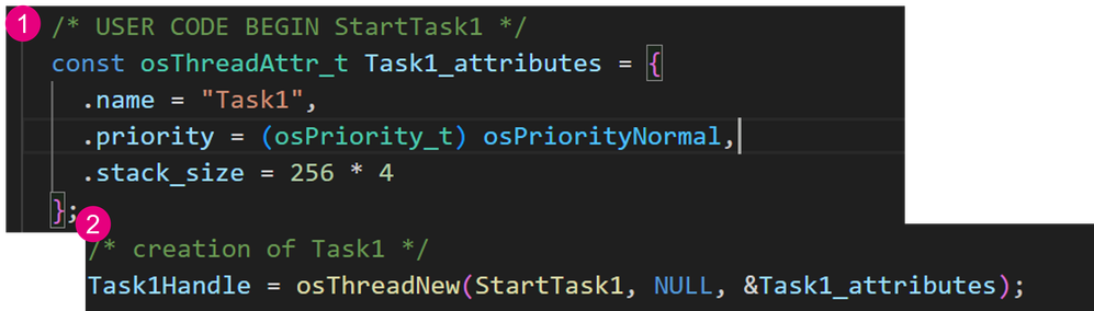

We can create already defined tasks and other OS components before the scheduler is started (it is possible to create and delete tasks within working OS as well).
Modifications in main.c are needed:

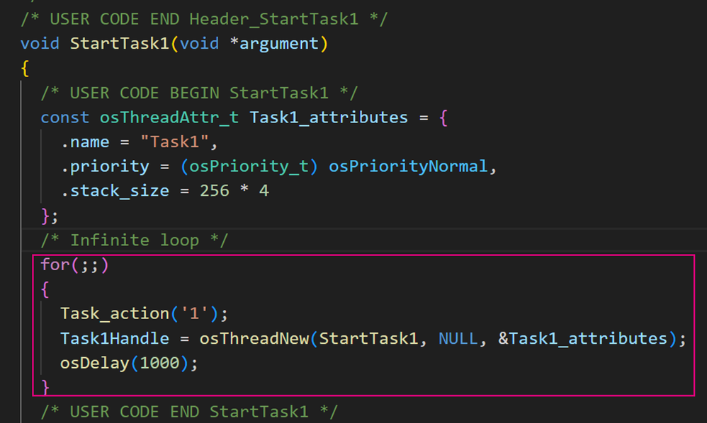

  • Once the scheduler selects a task for execution, an assigned function is called. In the case of Task1 it is StartTask1().  Add Task_action() and osDelay() functions like below:
Similar code should be added for defaultTask and Task2.

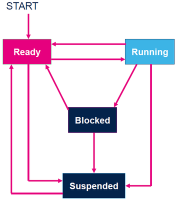

The tasks created can exist in several states, each a different stage of execution or waiting, the primary states are shown in the figure below:
RTOS statesRTOS states

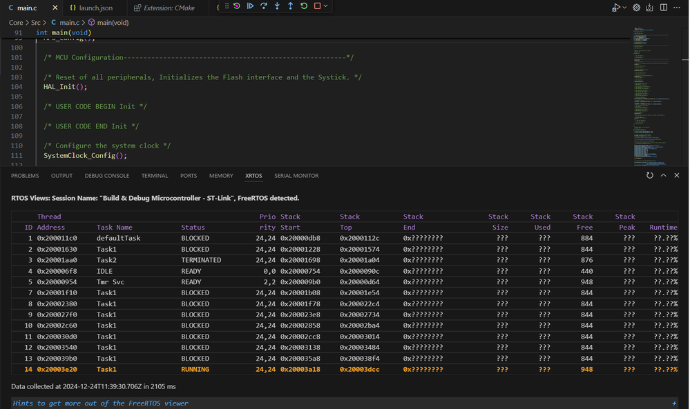

The XRTOS view in VS Code provides a comprehensive visualization of these task states. When debugging your FreeRTOS™ application, the XRTOS view allows you to see the status of each task in real time. You can monitor which tasks are running, which are ready to run, and which are blocked or suspended. This detailed insight helps to understand the behavior of your application and diagnose issues related to task scheduling and synchronization.

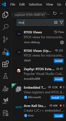

You can download the RTOS Views extension that allows you to deploy and debug your FreeRTOS™ application on your target device. It supports various hardware debuggers and software. This extension automatically detects the presence of an RTOS by looking for specific global variables.
RTOS Views downloadRTOS Views download

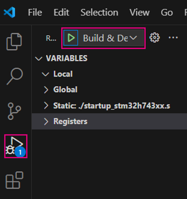

To start a debug session, click on (Ctrl+Shift+D) and start debugging:
To use this view, you need to launch a debugging session and use the XRTOS view to monitor your RTOS tasks and system rate, this also could be used to monitor the stack usage.
XRTOS viewXRTOS view
