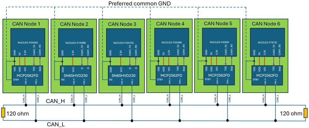

Figure 1. The opted hardware while running the examplesFigure 1. The opted hardware while running the examples
As shown in  figure 1, six nodes are connected on the CAN bus based on Nucleo boards. Two of the six nodes (2 and 3) use SN65HVD230 transceiver while the rest of the nodes are using MCP2562FD transceiver.
A common ground is also considered while testing. It is not a connection that must be put in place, but it's better to do it.

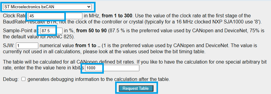

The settings of the CAN bit timing web tool will be as shown by figure 2. The APB1 clock is set at 45 MHz. The sample point is set at 87.5% and the CAN bitrate is set at 1 Mbit/s (1000 kbit/s).
Figure 2. CAN bit timing web tool for 1 Mbit/sFigure 2. CAN bit timing web tool for 1 Mbit/s
After clicking the [Request Table] button (see figure 2), the tool generates a table containing different CAN timing configuration as shown by figure 3.
Figure 3. Different timing configuration proposed by the toolFigure 3. Different timing configuration proposed by the tool
The yellow row highlights the recommended settings. The CAN prescaler = 3, the bit segment 1 = 12 and the bit segment 2 = 2. The sample point is set at 86.7%, which is a good position of the sample point.

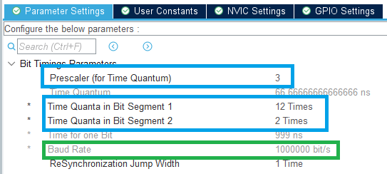

In the STM32CubeMX, we set these values as shown by figure 4 in the CAN parameter settings.
Figure 4. Setting the CAN timings parameter in STM32CubeMXFigure 4. Setting the CAN timings parameter in STM32CubeMX

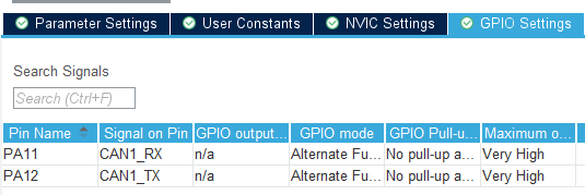

Now, it is time to configure the CAN GPIO pins. The default pins set by STM32CubeMX are PA11 and PA12 for respectively CAN_Rx and CAN_Tx as shown in figure 5.
Figure 5. Default pins selected by STM32CubeMXFigure 5. Default pins selected by STM32CubeMX
In the example, we decided to select PD0 and PD1 for respectively CAN_Rx and CAN_Tx.
In the [Pinout View], we set PD0 as CAN1_Rx and PD1 as CAN1_Tx as shown by figures 6 and 7.

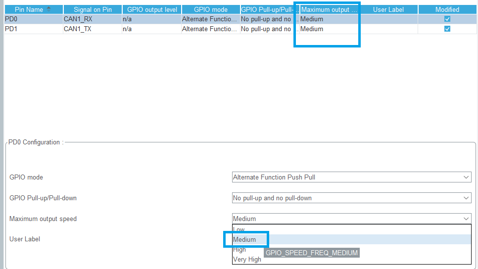

Change the I/O speed to “Medium” instead of “High” or “Very High” as it is not necessary to high speed levels. See figure 8.
Figure 8. Setting CAN I/Os speedFigure 8. Setting CAN I/Os speed

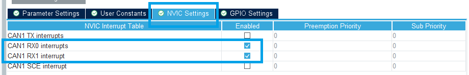

Enable the NVIC interrupts for the reception of FIFO 0 and FIFO 1 as shown in figure 9.
Figure 9. Enabling CAN NVIC interrupt lines for RxFigure 9. Enabling CAN NVIC interrupt lines for Rx

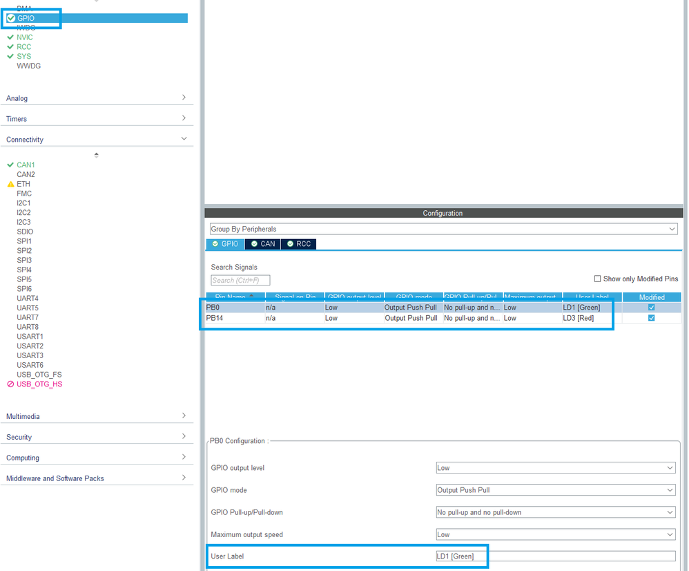

Now, we configure two LEDs (green and red) to indicate the CAN communication operation.
LD1 (green LED) to indicate a good CAN operation when it is toggling.
LD3 (red LED) to indicate that, when it is toggling, something went wrong in the program including the CAN operation.
Figures 11, 12, 13 and 14 show the GPIO configuration of these LEDs.
Figure 11. PB0 for LED1 configurationFigure 11. PB0 for LED1 configuration
Figure 12. PB14 for LED3 configurationFigure 12. PB14 for LED3 configuration
Figure 13. LD1 and LD2 GPIO pins settingsFigure 13. LD1 and LD2 GPIO pins settings

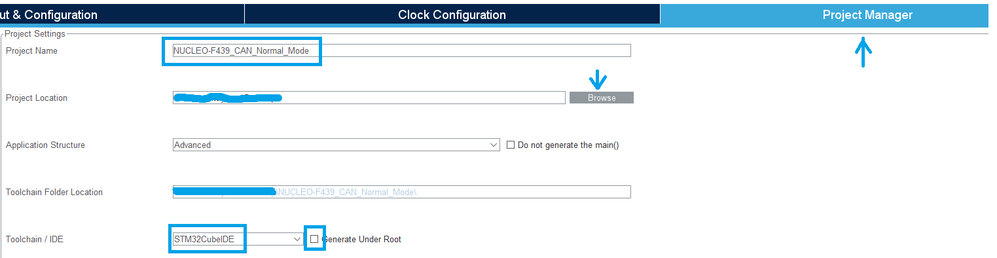

At this stage, the needed application configuration is finished. Now, we need to give a name to the project, set its path, and select the toolchain to be used. So, we need to use STM32CubeIDE in our example. See figure 14.
Figure 14. Configuring the projectFigure 14. Configuring the project

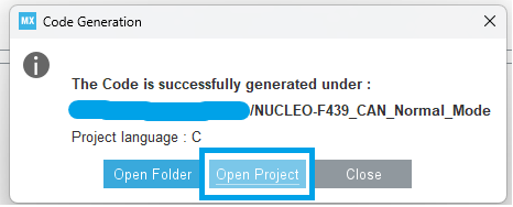

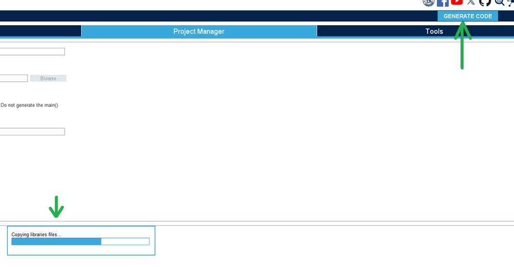

It's time to generate the CAN project. STM32CubeIDE is used as the toolchain.
As shown by figure 15, click the [Generate Code] button. Click on [Open Project] as shown by figure 16 then finally click the [Launch] button to open the project as shown by figure 17. Figure 18 shows the project explorer in STM32CubeIDE and what files that need to be available in the project.Figure 15. Generate the projectFigure 15. Generate the project
Figure 16. Open the projectFigure 16. Open the project

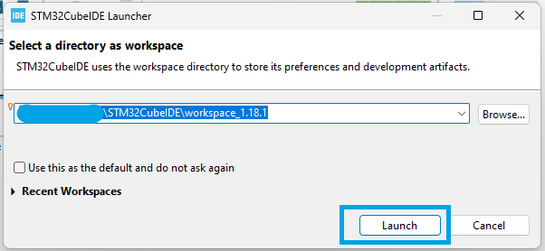

Figure 17. Launch the STM32CubeIDE workspaceFigure 17. Launch the STM32CubeIDE workspace

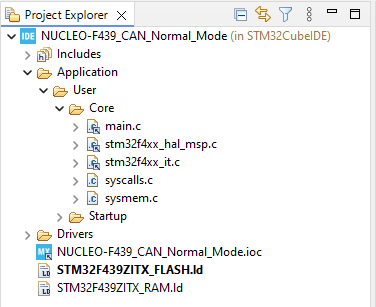

Figure 18. The STM32CubeIDE project explorer showing the generated projectFigure 18. The STM32CubeIDE project explorer showing the generated project

The reception is handled with interrupts. Figure 20 shows how to enable the interrupt for CAN Rx FIFO1 and FIFO0 in STM32CubeMX. Both callbacks are used for that purpose, as each callback correspond to a specific FIFO reception:

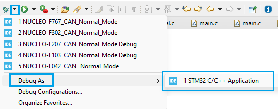

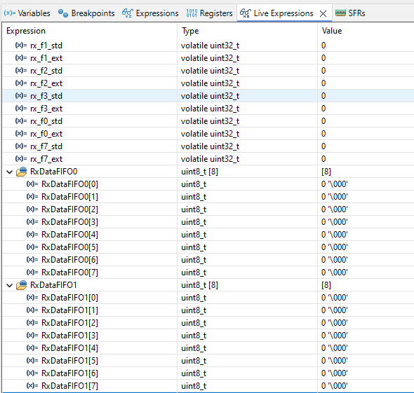

We upload all the examples to their corresponding platforms one by one (all other ST-LINK are disconnected). We keep the NUCLEO-F439 board as the last one to upload its program, and start a debug session (figure 20) of the application.
Figure 20. Starting a debug session for the current projectFigure 20. Starting a debug session for the current project

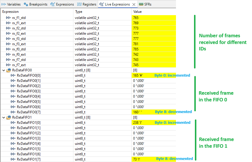

In the [Live Expression] we can add all the variables related to the CAN reception operation (Figure 21).
Figure 21. Variables related the CAN Rx operation are added to the Live ExpressionFigure 21. Variables related the CAN Rx operation are added to the Live Expression
It's time to run the application. Click on the run button shown by figure 22.
Figure 22. Running the example buttonFigure 22. Running the example button
Figure 23 shows the different variables related to the CAN Rx operation, including the data received in the CAN frame. Additionally, their corresponding number of CAN IDs received in live by the NUCLEO-F439 board.
Figure 23. Live expression showing the RX variables contentFigure 23. Live expression showing the RX variables content

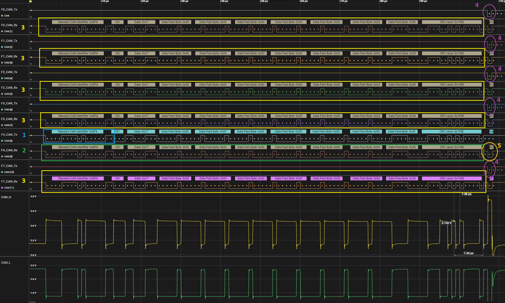

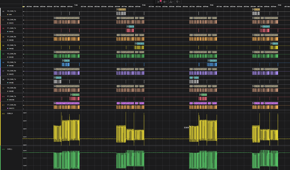

3.2 CAN frame analysis using a Logic analyzer
For more analysis, we can use a logic analyzer featuring a CAN analyzer like Saleae Logic Pro 16.
Each of the CAN_Tx and CAN_Rx pins of all nodes are probed by the analyzer.
For example for NUCLEO-F042, CAN_Tx is probed by the digital channel 0 while CAN_Rx is probed by the digital channel 1.
NUCLEO-F103: CAN_Tx probed by the digital channel 2, CAN_Rx is probed by the digital channel 3, and so on.
The CAN analyzer is configured in CAN mode at 1 Mbit/s. For more details about how to configure the Logic analyzer in CAN mode, refer to the article: Guide to CAN (bxCAN/CAN2.0) configuration in Loop back mode on STM32 MCUs section 4. Running the application and tests.
Figure 24 provides a global view of the frames captured by the CAN analyzer of all nodes on their corresponding CAN_Tx and CAN_Rx pins. CAN_H and CAN_L lines are also probed using two analog channels.
Figure 24. A screenshot of the captured frame by the Logic analyzerFigure 24. A screenshot of the captured frame by the Logic analyzer
3.3 Discussion on the captured CAN frames
Figure 25. Zoom in on what happens when STM32F439 sent a CAN frameFigure 25. Zoom in on what happens when STM32F439 sent a CAN frame
1. The box in blue color shows that the STM32F439 is sending a standard ID frame = 0xF4. This is seen on its Can_Tx pin probed by a digital logic analyzer channel that we named “F4_CAN_Tx”.
2. The box in green color shows that STM32F439 is listening on its CAN_Rx pin what is sending on its CAN_Tx pin. This is used for the arbitration mechanism as well as for error detection (bit modification etc).
3. The box in yellow color shows that the rest of the nodes are seeing the same CAN signal on their CAN_Rx pins. This shows that the CAN frame is broadcasted to all the CAN nodes connected to the bus.
4. The box in purple color shows that there was a reception acknowledgment of that frame (sent by STM32F439) in the acknowledgment slot. No one knows which CAN node has acknowledged the frame. May be one node, may be all the nodes. But at least one node has acknowledged the frame and the acknowledgment bit was asserted on one of the CAN_Tx pin nodes. Note that the acknowledgment bit is not intended to be asserted by the intended recipient.
5. The box in orange color shows that the STM32F439 sees its frame acknowledged on its CAN_Rx pin. Therefore, it knows that the frame it sent has been well received by at least one node on the CAN bus. This is why at least two nodes connected to the CAN bus are needed to complete the acknowledgment mechanism.
For your reference, attached a compressed .sal file that contains the captured CAN frames by the Saleae Logic analyzer in the demo.
