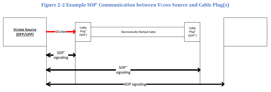

It is a USB Power Delivery communication with Start of Packet (SOP) for source to sink signaling and SOP’/SOP ’' for cable addressing.
USB-IF: USB Power Delivery Specification, Revision 3.2, Version 1.1, 2024-10, page 58USB-IF: USB Power Delivery Specification, Revision 3.2, Version 1.1, 2024-10, page 58
