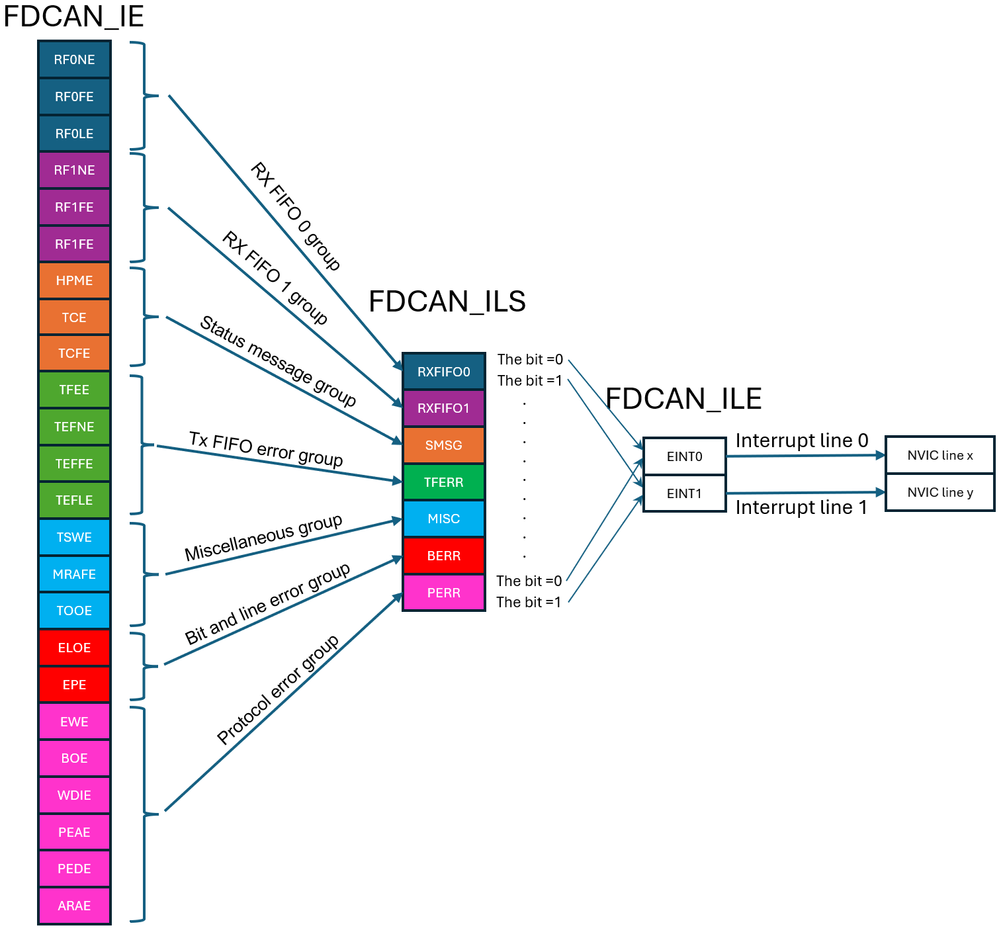

1. FDCAN interrupt grouping in some STM32 MCUs
STM32 devices provide two FDCAN interrupt lines to enable flexible and prioritized interrupt management. The FDCAN_ILE register allows independent control over these lines. Interrupt sources can be assigned to either Line 0 or Line 1 depending on the application’s priority requirements. For example, if the Rx FIFO 0 interrupt needs to have a higher priority than the Rx FIFO 1 interrupt, this can be configured by software using this scheme. The interrupt grouping is adopted in the optimized version of FDCAN.
1.1 How interrupt grouping was implemented in some STM32 MCUs
In the optimized FDCAN implementation, the bits in the FDCAN_ILS register act as “parent” bits that group, by category, the related interrupt sources defined in the FDCAN_IE register. Essentially, interrupts enabled in FDCAN_IE are categorized and grouped under a single bit in FDCAN_ILS according to their interrupt category.
Example: grouping of FIFO0 related interrupts
All FIFO0-related interrupts in FDCAN_IE are grouped under one parent bit in FDCAN_ILS called RXFIFO0. In other words, this parent bit corresponds to three “child” interrupts activation in FDCAN_IE:
  • RF0NE: Rx FIFO 0 new message interrupt enable
  • RF0FE: Rx FIFO 0 full interrupt enable
  • RF0LE: Rx FIFO 0 message lost interrupt enable

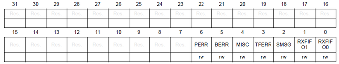

The following is the FDCAN_ILS register implementation in the optimized version of FDCAN peripheral:
Figure 1. Overview of the FDCAN_ILS register in the optimized FDCAN peripheral
 Figure 2. Overview of FDCAN interrupt grouping
By default, all FDCAN interrupts are mapped to FDCAN interrupt line 0. If you do not need to split the interrupts and want them all to trigger on the default line 0, simply keep the FDCAN_ILS register at its reset value. In this case, you only need to enable the corresponding interrupt bits in FDCAN_IE and enable the FDCAN line 0 interrupt by setting the EINT0 bit in the FDCAN_ILE register to 1.

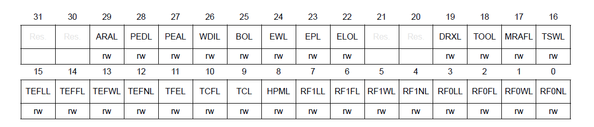

FDCAN_ILS register differences in the superset version of FDCAN (for example, STM32H743):
Unlike the optimized version of FDCAN, the superset version (such as the one embedded in the STM32H743 MCU) does not use interrupt grouping. Each FDCAN interrupt can be independently mapped to either line 0 or line 1. The FDCAN_ILS register in the superset version is implemented as shown below:
Figure 3. FDCAN_ILS register overview in the superset version of the FDCAN peripheral
This implementation is more flexible than the optimized version of FDCAN, allowing all 27 interrupts to be mapped individually to any FDCAN interrupt line. There are no “parent” bits grouping interrupts together, enabling full control over interrupt routing.

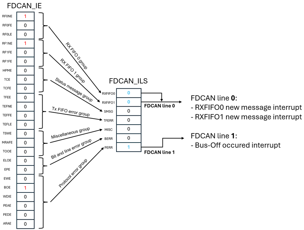

1.2 Example of both FDCAN interrupt lines usage
Suppose that we want to use three interrupts:
  • FIFO0 New Message
  • FIFO1 New Message
  • Bus-Off Status
We want to map FIFO0 and FIFO1 interrupts to FDCAN interrupt line 0, while the Bus-Off interrupt is mapped to FDCAN interrupt line 1. Additionally, FIFO0 and FIFO1 interrupts should have higher priority than the Bus-Off interrupt.
1.3 Step-by-step configuration
Step 1: Set interrupt priorities in NVIC
Assign a higher priority to FDCAN line 0 interrupts (FIFO0 and FIFO1) than to FDCAN line 1 (Bus-Off). This can be done by setting a lower priority value for line 0 interrupts in NVIC, either in preemption priority or sub-priority, depending on the application requirements.
Step 2: Enable the interrupts in FDCAN_IE
  • Set RF0NE (bit 0) to enable the Rx FIFO 0 new message interrupt.
  • Set RF1NE (bit 3) to enable the Rx FIFO 1 new message interrupt.
  • Set BOE (bit 19) to enable the Bus-Off status interrupt.
Step 3: Map interrupts to FDCAN interrupt lines using FDCAN_ILS
  • The parent bit for FDCAN_IE.RF0NE is FDCAN_ILS.RXFIFO0. To map Rx FIFO 0 interrupt to line 0, keep FDCAN_ILS.RXFIFO0 = 0.
  • The parent bit for FDCAN_IE.RF1NE is FDCAN_ILS.RXFIFO1. To map Rx FIFO 1 interrupt to line 0, keep FDCAN_ILS.RXFIFO1 = 0.
  • The parent bit for FDCAN_IE.BOE is FDCAN_ILS.PERR. To map the Bus-Off interrupt to line 1, set FDCAN_ILS.PERR = 1.
Step 4: Enable both FDCAN interrupt lines in FDCAN_ILE
  • Set both EINT0 and EINT1 bits to 1.
Figure 4 summarizes each content of FDCAN interrupts registers for the described scenario.
 Figure 4. Example of FDCAN_IE and FDCAN_ILS register values for interrupt line mapping
This example is implemented using the HAL API in section 2.
