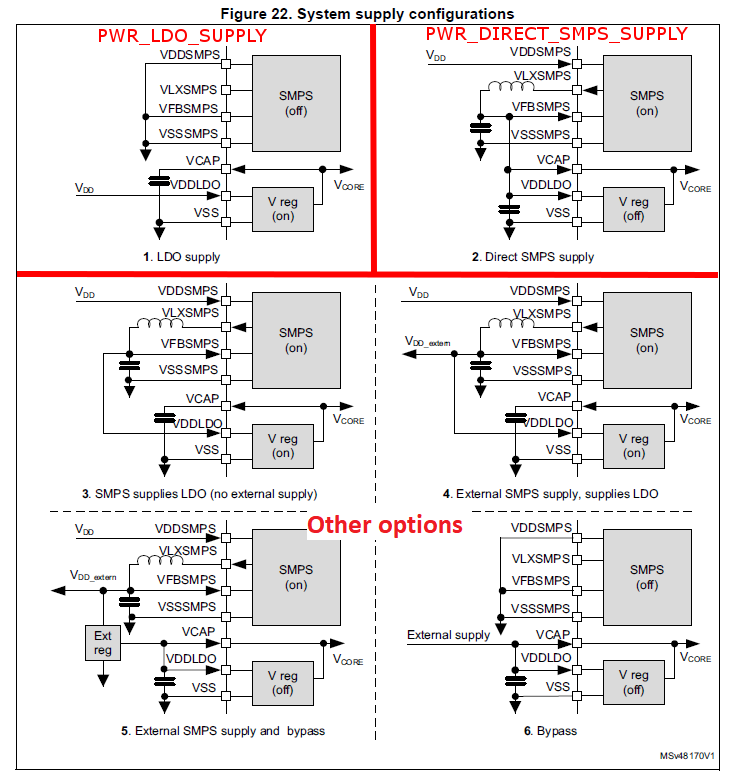

Below is a diagram from a reference manual showing different hardware configurations for the power supply.
The MCU contains a protection mechanism that prevents setting higher voltage from internal SMPS to VCORE (1.8 or 2.5 V). This should prevent damaging the MCU due to misconfiguration.

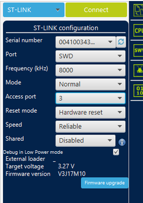

  1. Plug the board to the power supply, while the reset button is being held low (or NRST pin in general).
  2. Keep the reset button low.
  3. Connect via STM32CubeProgrammer. When the program starts connecting, release the reset button. Although this requires quite precise timing, it should be easy to achieve.
  4. Perform mass erase.

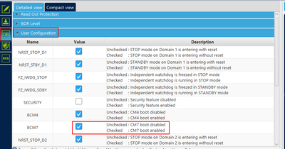

3. Possible root cause two (Cortex®-M7 boot disabled)
This applies to all STM32H7 devices with dual-core feature.
Other possibility is that the option bytes are configured in a way that only Cortex®-M4 boots after reset (BOOT_CM7/BCM7=0, BOOT_CM4/BCM4=1). Then you need to connect the debugger to Access port 3 (Cortex®-M4), instead of Access port 0 (Cortex®-M7).
For STM32CubeProgrammer versions 2.2.0 and older this does not seem to work. Please use a recent STM32CubeProgrammer version.
For development it is recommended to keep booting from both cores enabled, otherwise some tools/IDEs might not be able to work with the device.

/* Exported types ------------------------------------------------------------*/
/* Exported constants --------------------------------------------------------*/
/* Set this define to 1 to OverClocking the system clock to 480MHz*/
#define USE_VOS0_480MHZ_OVERCLOCK 0
!!!Attention!!!
Over clocking the system clock to 480MHz is only available with LDO PWR configuration
by default The NUCLEO-H745ZI-Q board comes with DIRECT_SMPS configuration
in order Over clock the system clock to 480MHz to the nucleo board must modified
to change the PWR path to LDO instead of DIRECT_SMPS
to do so please change the following solder bridges :
- LDO config :
Mount : SB25, R33(0R), SB74
C58 & C54 = 2.2uF instead of 100nF
Removed : SB92, SB79, R35(0R), SB75, SB76
- Direct SMPS config (default config):
Mount : SB92, SB79, R35(0R), SB75, SB76
C58 & C54 = 100nF
Removed : SB25, R33(0R), SB74
Note that the Board HW configuration must match with the FW config
if not will face a deadlock (can't connect the board any more)
the FW PWR configuration correspond in the main.c to the following :
Function SystemClock_Config :
- case of LDO config : HAL_PWREx_ConfigSupply(PWR_LDO_SUPPLY);
- case of Direct SMPS config : HAL_PWREx_ConfigSupply(PWR_DIRECT_SMPS_SUPPLY);
Thanks

I somehow managed to brick my Nucleo STM32H755 board. Although I can connect to the second core (access port 3), I can't connect to port 0. I think I disabled the M7 core by accident through option bytes. Unfortunately, if I try to restore factory reset of the option bytes, I am getting an error "Device 0x450 not supported for factory reset operation" (while connected to the M4 core using the STM32CubeProgrammer talking to the on-board ST Link interface).
I've tried rebooting while holding BOOT0 high, but that seems to have no effect (or perhaps I don't quite understand the right sequence).
Adam BERLINGER
Hello @etl17 ,
This issue should be possible to solve with the STM32CubeProgrammer (v2.21, but older should work as well) and setting the BCM7 bit. I tested and used following configuration to connect to Nucleo-H755 board while Cortex-M7 is disabled.
Then I can change the option bit back in option bytes:
As you mention, the factory reset is not supported for STM32H755. Maybe there could be situations where the factory reset is not possible, or setting the option bytes to default could lead to issues.

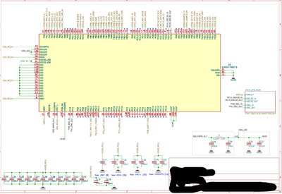

this is my customized board board schematic
@Adam BERLINGER
@Tesla DeLorean
@Andrew Neil

Hello @kavyamm ,
from the first log of the CubePogrammer, it looks like the programming went ok and the error appears after. Maybe this could be related to power supply configuration during startup of the firmware. In latest CubeFW/CubeMX, this is done as well in the system_stm32h7xx.c (or similar) startup file in function ExitRun0Mode. This is based on global macro definition, but it might be possible that this is not correctly generate by CubeMX.
Regarding the schematic, the BOOT0 pin needs to be connected somewhere. Leaving it floating will lead to non-deterministic behavior, since HW can detect 0 or 1 at random during startup. However, I doubt this is the root cause, since entering bootloader shouldn't affect the debug capability.
In the power supply I don't see any major issues. I think the C31/C32 should be 100nF in SMPS configuration. In any case, I would recommend checking AN4938: https://www.st.com/resource/en/application_note/an4938-getting-started-with-stm32h74xig-and-stm32h75xig-mcu-hardware-development-stmicroelectronics.pdf
Maybe it would be best to create support ticket at ST support: https://ols.st.com/s/

could u please clarify Why am I getting the following error when using 3 V?
ST-LINK FW: V2J46S7
Board: —
Voltage: 2.79 V
Error: Unable to get core ID
Error: No STM32 target found!

Also, would it be possible to share the connection to debug connector? If you don't want to share schematic on public forum, you can create OLS ticket here: https://ols.st.com/s/.

Hi sir ,
I am using the same STM32H755ZIQ board and facing the same issue where the target is not detected by ST-Link after uploading the program.
This is the code link: https://github.com/kavyammengineer/stm32debug/tree/main/led_on_off
The code works correctly on the Nucleo-H755ZIQ board, but when I upload it to my customized board, the target gets stuck and is no longer detected by ST-Link.
 this is what i  am used in custom board direct smps supply i used .
this is my sysclk 64Mhz  internal HSI
