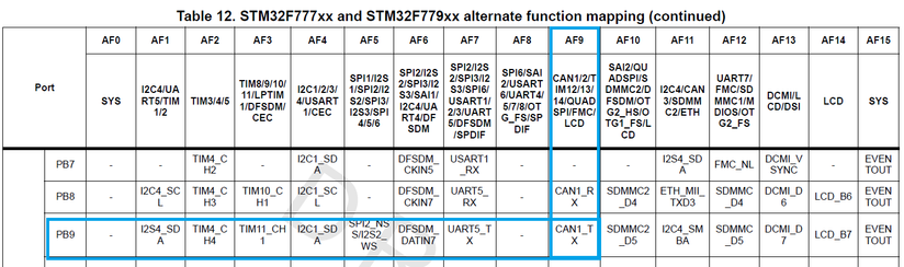

2.1. Wrong GPIO configuration
It could be either a GPIO not set to the correct mode, that is, in GPIO alternate function push-pull mode (GPIO_MODE_AF_PP) or the GPIO alternate function is not correctly configured. In that case the user needs to check the alternate function mapping table provided in the product datasheet.
STM32F7xx as example:
If the user selects PB9 GPIO for CAN1_Tx, they need to select AF9 as an alternate function.
In the software, the CAN1_Tx pin configuration needs to be:
GPIO_InitStruct.Alternate =  GPIO_A9_CAN1;
