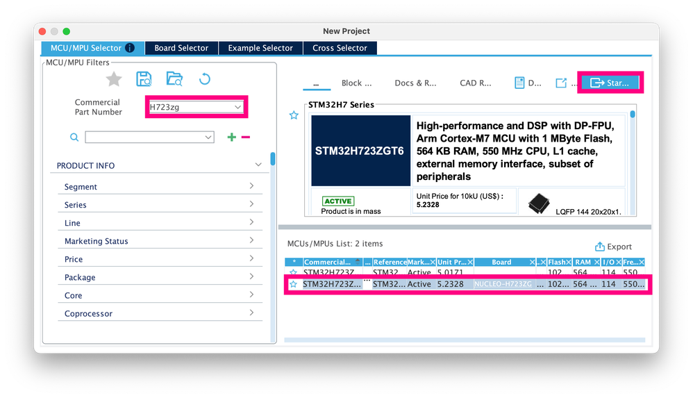

Open STM32CubeMX. In File → New project, type "H723ZG" in the part number field, select the microcontroller from the list at the bottom, and click [Start project] at the top right.

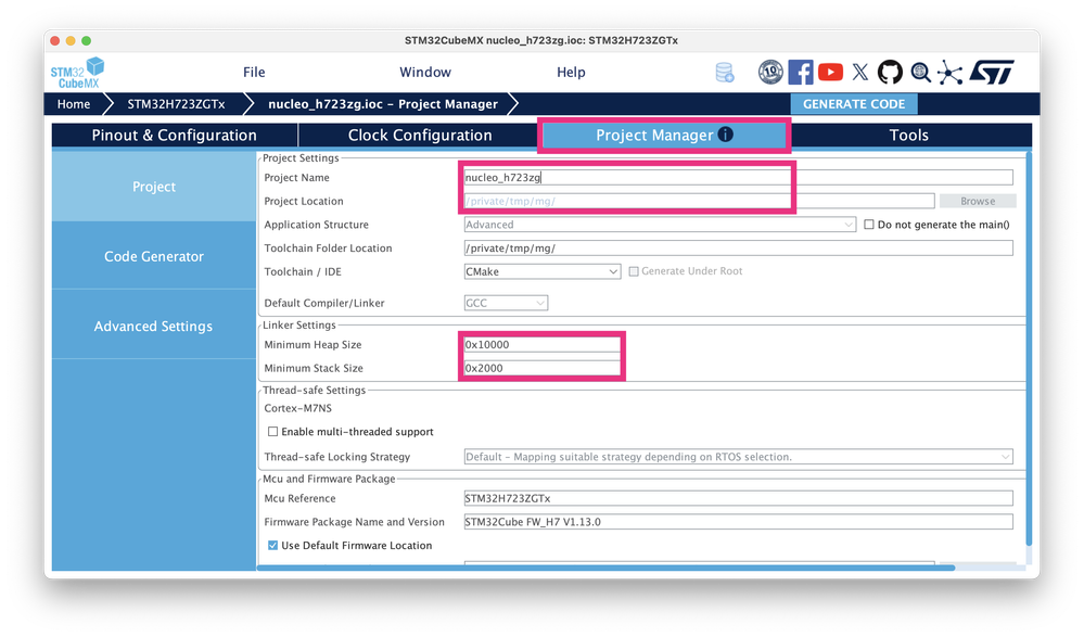

When the memory protection unit dialog appears, click [Yes]. In the "Project Manager" tab, select the project directory and enter a project name. Set heap size to 64Kb, and stack size to 8Kb:

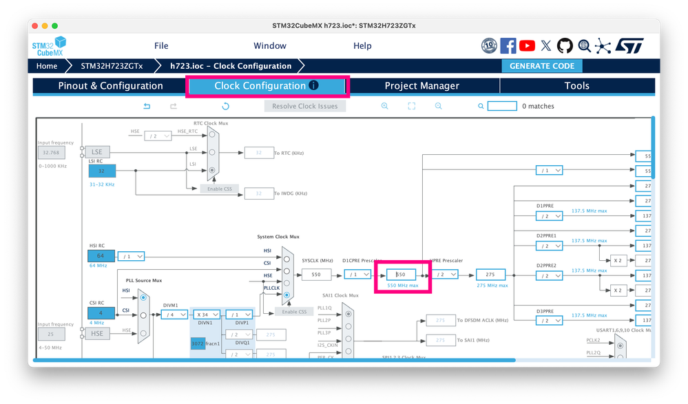

In the "Clock Configuration" tab, select the maximum system frequency and press Enter to auto-configure it.

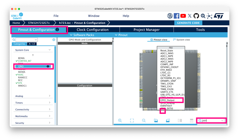

In "Pinout & Configuration" → "System Core" → "GPIO", configure the LED pins as [GPIO_Output].

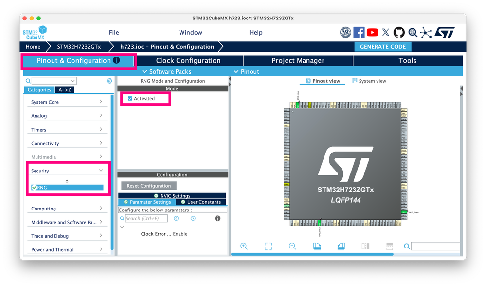

In "Pinout & Configuration" → "Security", select RNG and set the mode to [Activated].

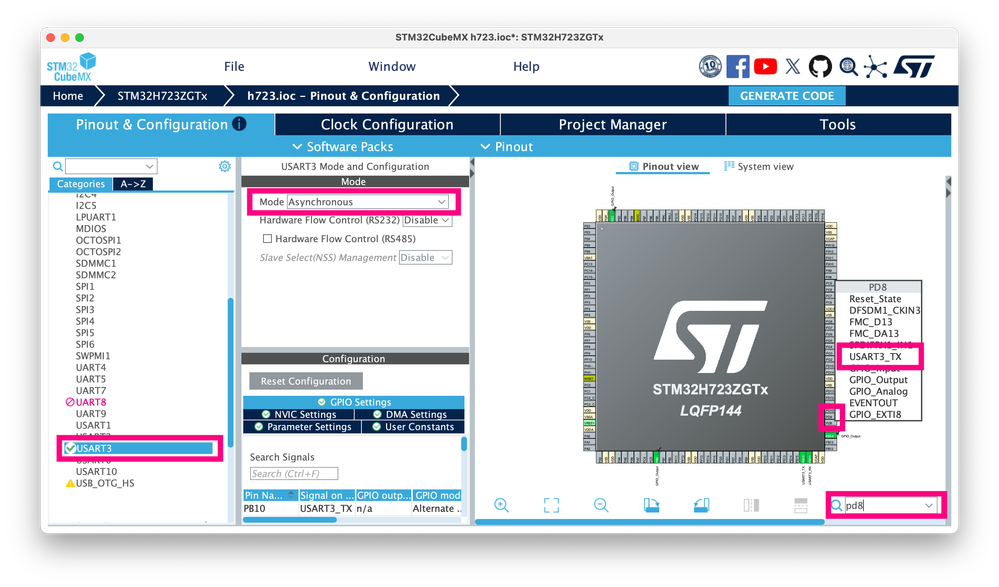

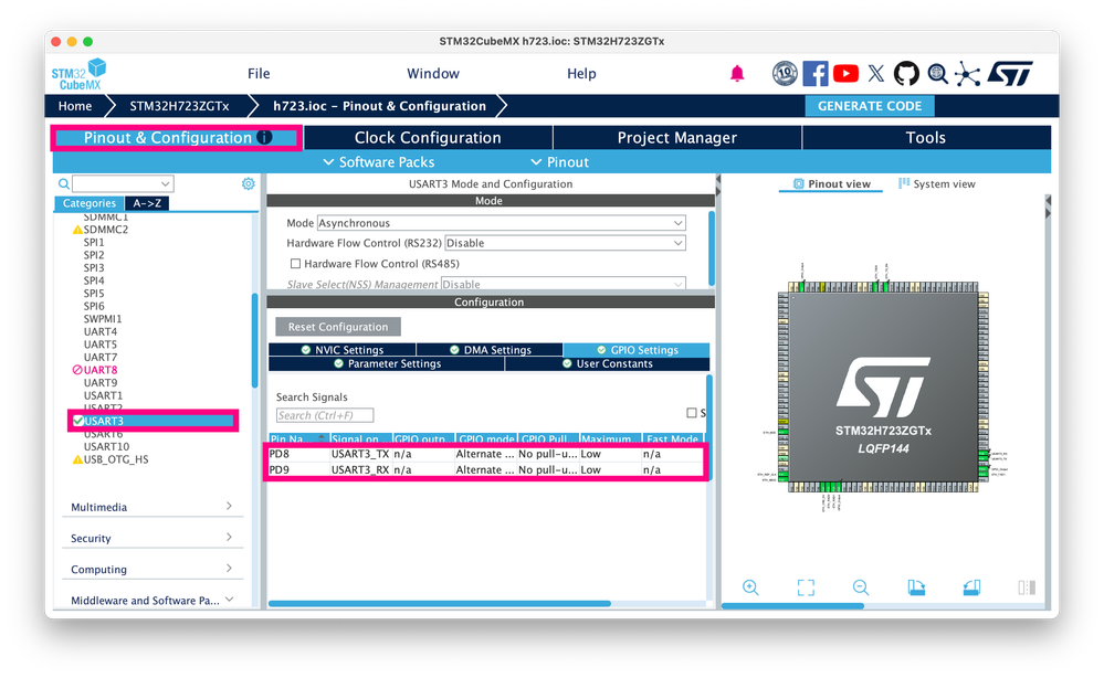

In "Pinout & Configuration" → "Connectivity", set USART to [Asynchronous mode] and configure the Tx and Rx pins.

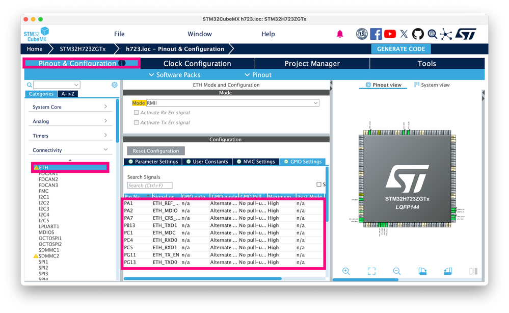

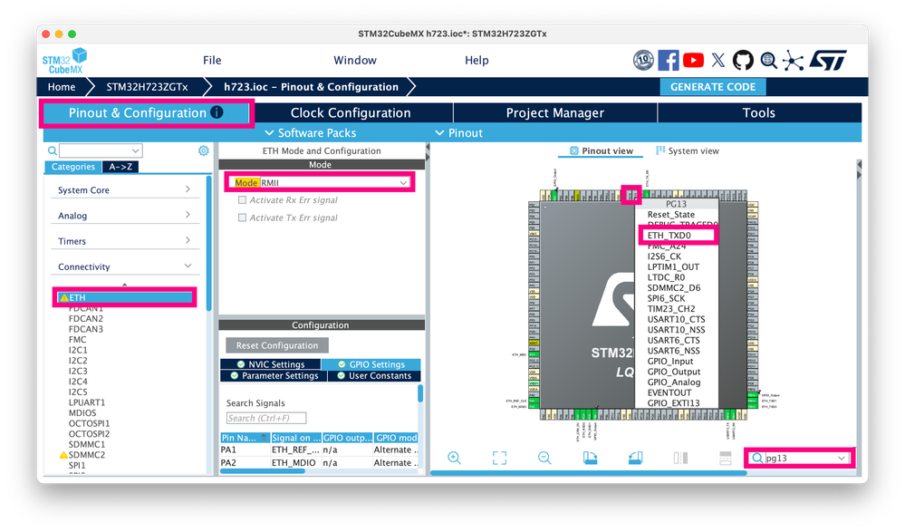

In "Pinout & Configuration" → "Connectivity", set "ETH" to [RMII mode] and configure the Ethernet pins.
BMontanari_6-1777043670871.pngEnsure your pin mapping matches the table above. For NUCLEO-H723ZG, this is the pinout for USART and Ethernet you should obtain.

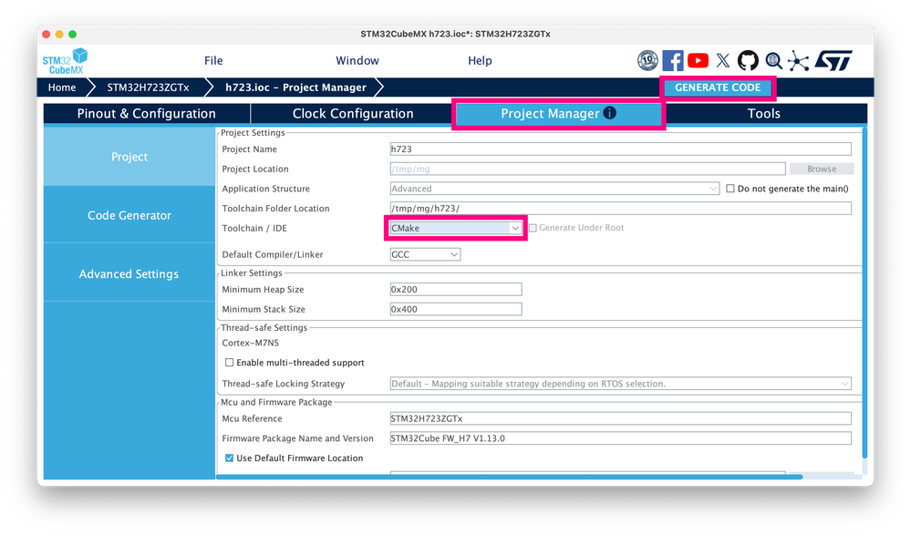

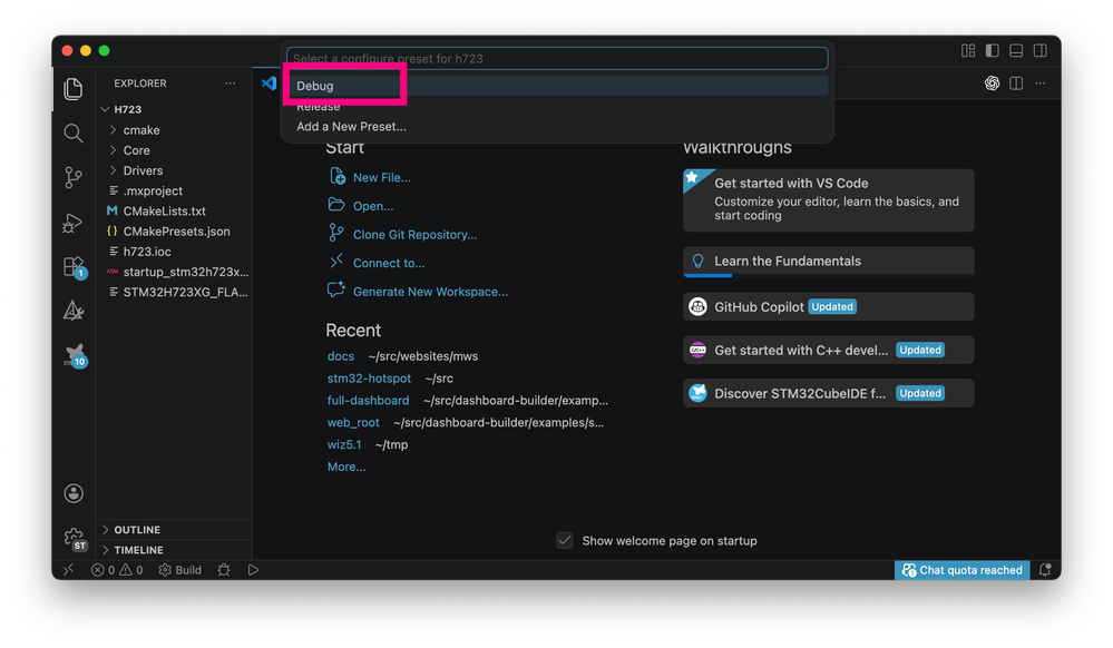

In the Project Manager tab, choose the target IDE and click [Generate Code]. You can select any available option, such as CMake or STM32CubeIDE. This guide uses VS Code STM32, so select CMake.
After the project is generated in your target directory, open that directory in VS Code.

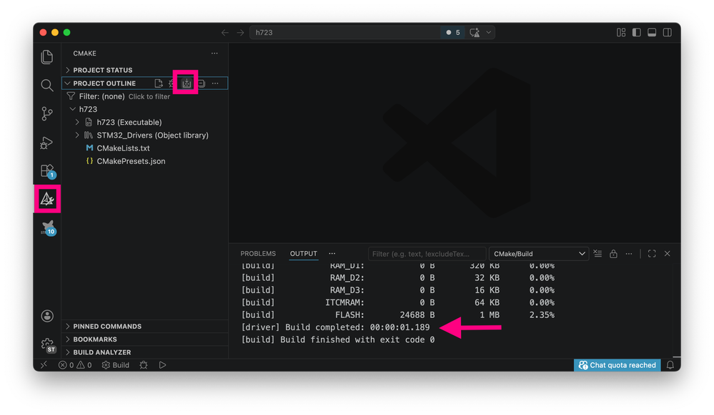

BMontanari_10-1777043843761.pngBuild the project to ensure that it builds with no errors.

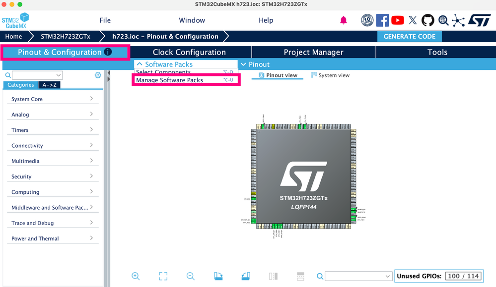

In STM32CubeMX, click "Pinouts & Configuration" → "Software Packs" → "Manage Software Packs."

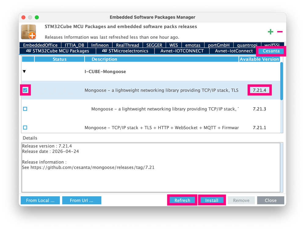

In the window, click [Cesanta], then click [Refresh]. Install the latest "I-CUBE-Mongoose" pack. Ensure it is version 7.21.4 or later.

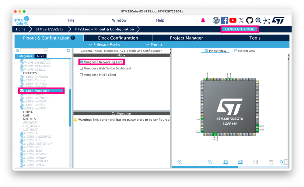

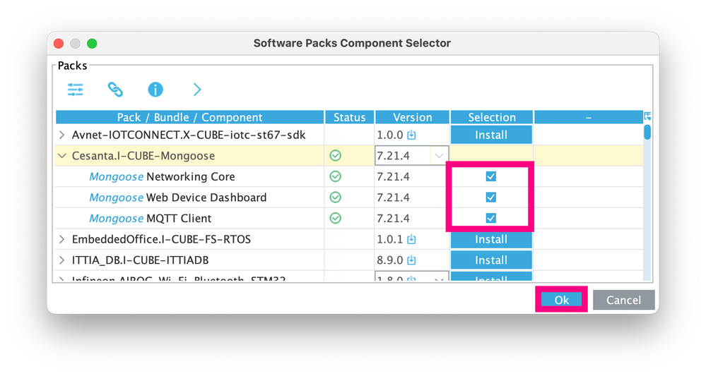

BMontanari_13-1777043973887.pngClick "Software Packs" → "Select Components" and choose all Mongoose components. BMontanari_14-1777044004816.pngIn "Pinouts & Configuration" → "Middleware and Software Packs", click [I-CUBE-Mongoose], enable [Mongoose Networking Core] and click [Generate Code].

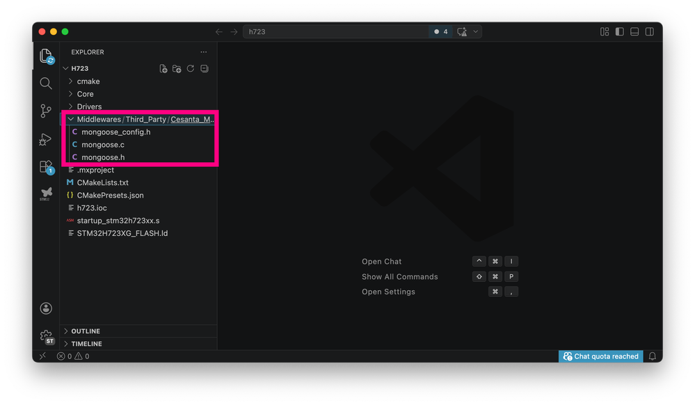

This action adds the Middlewares/Third_Party/Cesanta_Mongoose/ directory with three files: mongoose.c, mongoose.h, and mongoose_config.h.

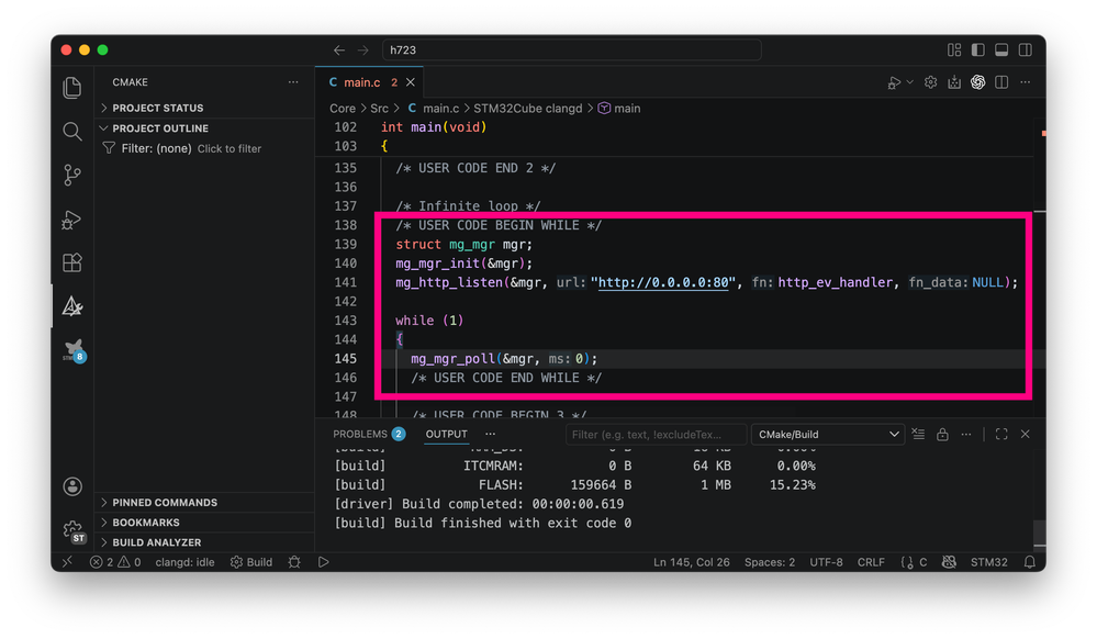

Add the following to the main function to initialize and run Mongoose. This runs the TCP/IP stack and the web server:
  /* USER CODE BEGIN WHILE */
  struct mg_mgr mgr;
  mg_mgr_init(&mgr);
  mg_http_listen(&mgr, "http://0.0.0.0:80", http_ev_handler, NULL);
  while (1)
    mg_mgr_poll(&mgr, 0);
BMontanari_17-1777044195229.pngMongoose uses an event-driven model to handle connections. This makes it easy to manage multiple connections within a single task.

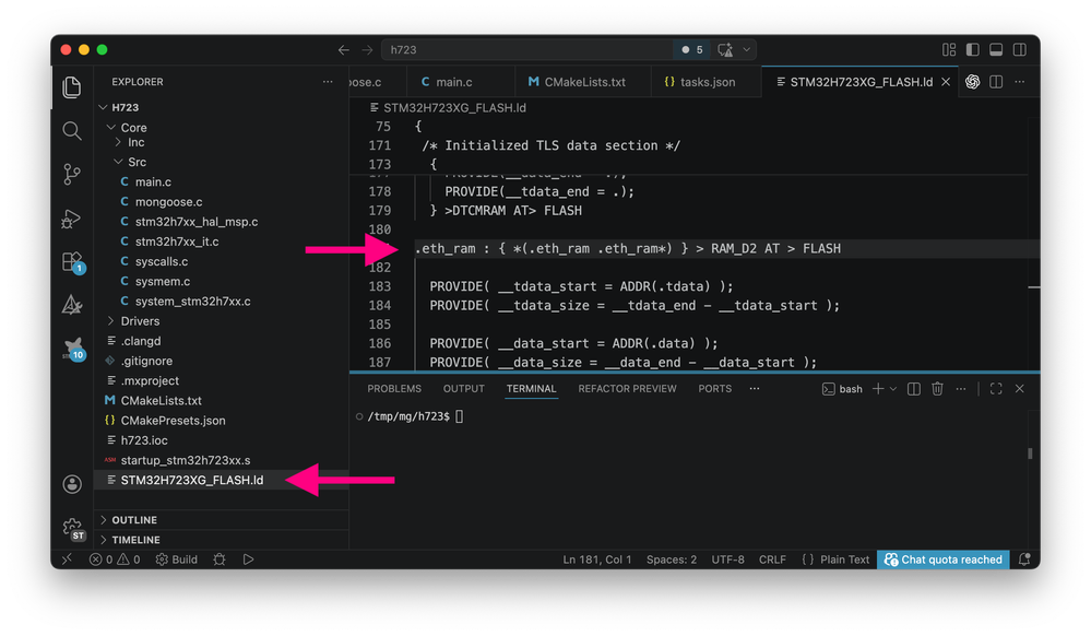

Open STM32H723XG_FLASH.ld and add the following line before the .bss (NOLOAD) line:
.eth_ram : { *(.eth_ram .eth_ram*) } > RAM_D2 AT > FLASH
BMontanari_18-1777044280874.pngThe Ethernet MAC uses a DMA controller to transfer data. The Ethernet driver defines DMA buffers using the .eth_ram ELF section. Therefore, in the linker script, .eth_ram must be placed in a memory region accessible by the Ethernet DMA controller.
If this is not done, .eth_ram ends up in the same region as .bss, which might not be accessible by the Ethernet DMA. The memory regions and their accessibility are described in the reference manual.
For STM32H723, see RM0468, section 2.4.

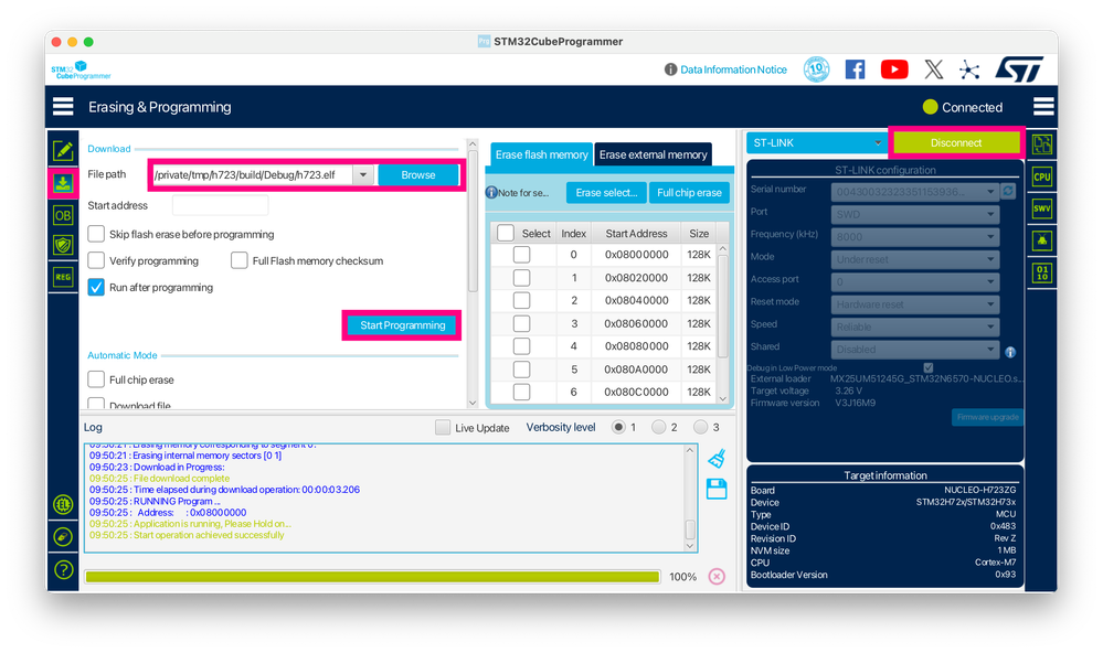

Start STM32CubeProgrammer and flash the firmware.

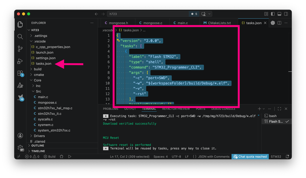

BMontanari_19-1777044497044.pngAlternatively, this integration can be done in VS Code by creating a custom task.json:
  "version": "2.0.0",
  "tasks": [
      "label": "Flash STM32",
      "type": "shell",
      "command": "STM32_Programmer_CLI",
      "args": [
        "-c", "port=SWD",
        "-w", "${workspaceFolder}/build/Debug/*.elf",
        "-v",
        "-rst"
      "problemMatcher": []
To use it, press Ctrl+P, then select Run Task and choose "Flash STM32".

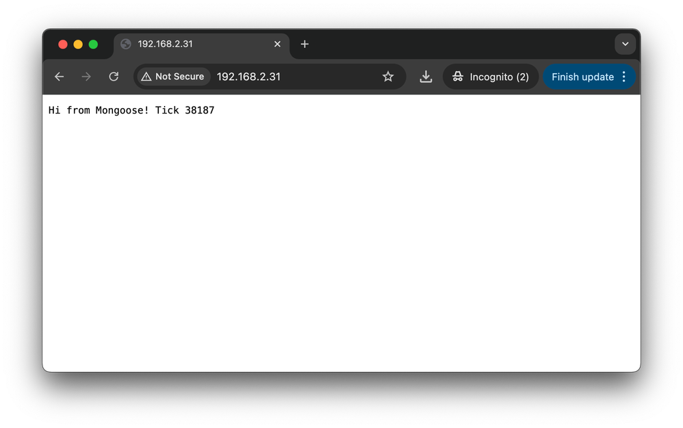

 Open the IP address in your browser. You should see the output from the web server.
