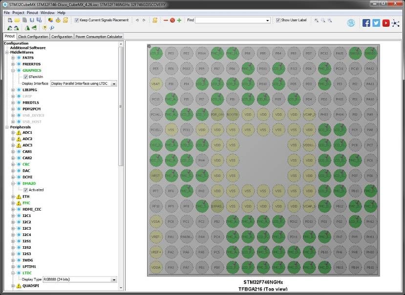

1. Open STM32CubeMX (v.4.26 at least) and load this STM32F746-Disco_CubeMX_4.26.ioc project file.
You can notice on the left side of the screenshot that the required graphic peripherals are enabled (DMA2D, LTDC, SDRAM, STemWin).
Note also that the CRC peripheral is required, it is mandatory when using the STemWin library.

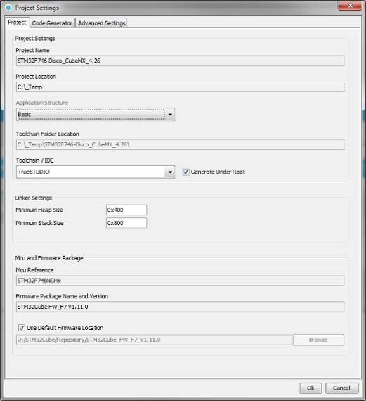

2. Open the project properties and check that you have the correct firmware installed

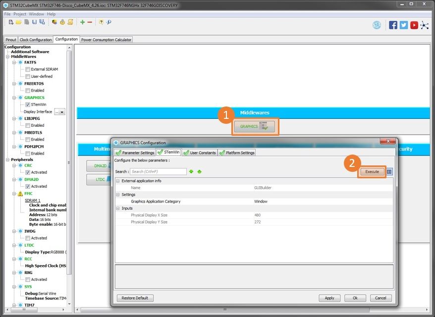

3. Switch to the "Configuration" tab and click on the "GRAPHICS" button to open the graphics configuration dialog box

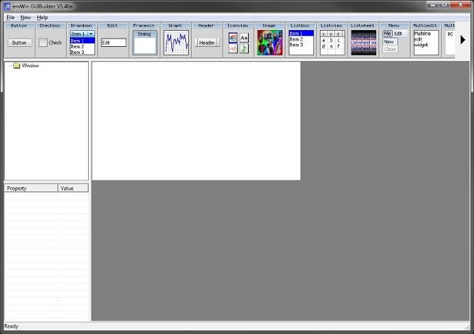

4. In the "STemWin" tab click on "Execute" to launch the GUIDesigner tool
Note that this tool is mainly used to create the skeleton of the GUI (i.e. define and set location of the main widgets and main refresh loop implementation).
To actually implement the GUI interactions or advanced/custom widgets the user will directly edit the source code.

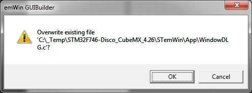

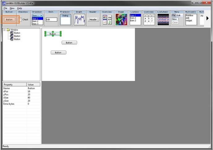

5. Click on the "Button" to create some buttons and save,
You can ignore the warning by clicking "Ok"

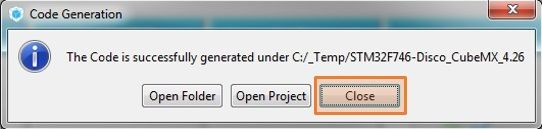

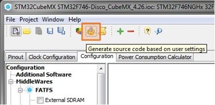

6. Generate the entire project source code
7. Do not click on "Open", it may open System Workbench instead of Atollic depending on which one is installed on your computer, click "Close"

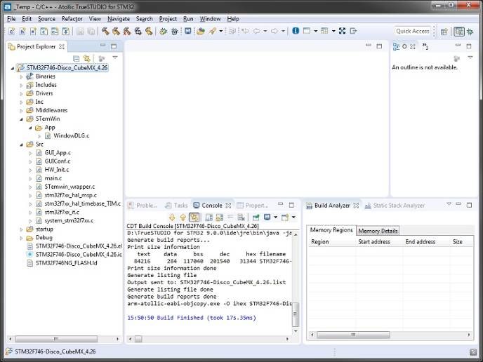

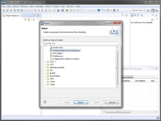

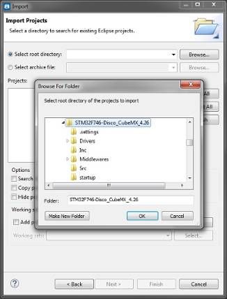

8. Open Atollic IDE and import the generated project by selecting the top folder (i.e. the one that contains the ".project" file)
9. Launch the build

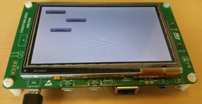

10. Launch a debug session, then click on the "run" button
11. You now have a functional graphical application running !
The graphic stack initialization is now handled and the stack is running without typing any piece of additional code !

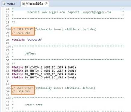

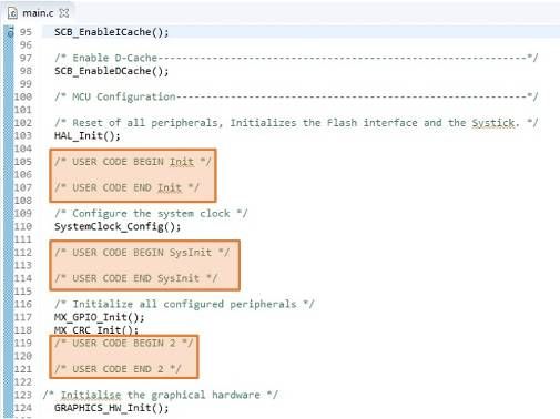

Note that any manually edited C code placed between /* USER CODE BEGIN ... */ and /* USER CODE END ... */ will be kept as is when re-generating the code from STM32CubeMX.
To apply the same principle to the WindowDLG.c file (containing the GUI skeleton) put user code between //USER START and //USER END.
