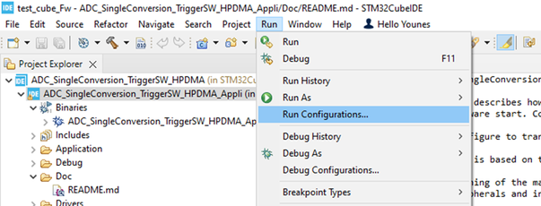

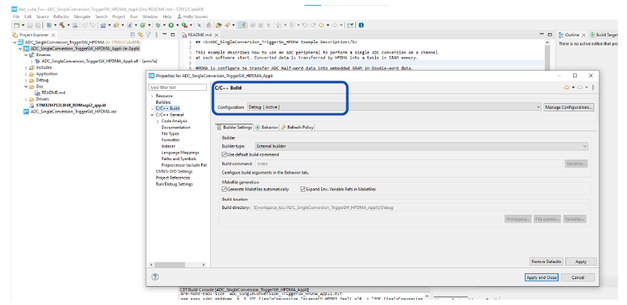

Compile the example/application. The elf file is required to configure the debug profile (the “active configuration” must be “debug”, else only assembly debug is available)

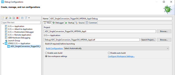

  • Open the menu [Run][Debug configuration] and double-click on [STM32 C/C++ Application].
    It creates a default debug configuration for the current project selected.

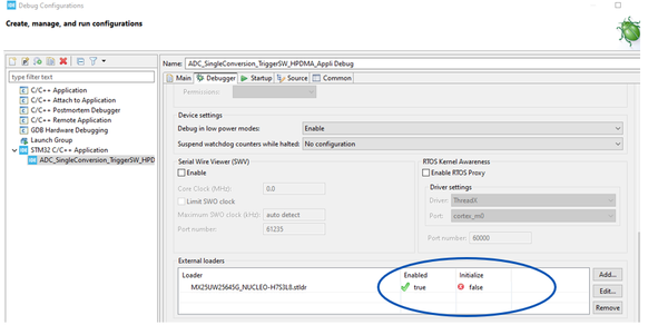

In the [Debugger] tab, section [External loaders] add the external loader corresponding to your Board/Memory as described below

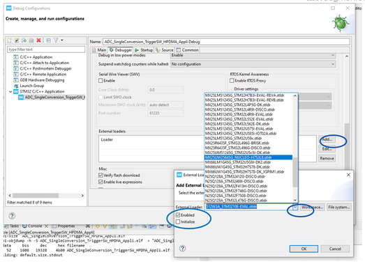

  • In the [External loaders] section, click on [Add]
  • Select the loader among the available list [MX25UW25645G_NUCLEO-H7S3L8.stldr or MX66UW1G45G_STM32H7S78-DK.stldr]
  • Check the option [Enabled] and uncheck the checked and option “Initialize” unchecked.
  • If these settings are not configured by default, double-click to change them.

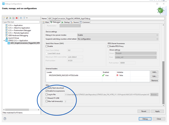

  • In the [Misc] section, uncheck the option [Verify flash download].

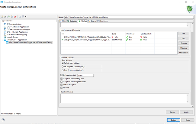

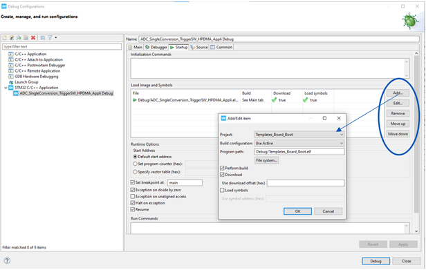

In the [Startup] tab, section [Load Image and Symbols]:
  • Click on “Project” and then select the boot project.
    • Click on "Build configuration" and select “Use active”.
    • Select the following options:
      • [Perform build] checked.
      • [Download] checked.
      • [Load symbols] unchecked.
    • Click on [Add].

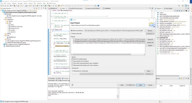

If your project contains a boot project, you can import the boot project into workspace as shown below:
    • Select the added boot project and build/compile it first.
    • Click on the [Add...] button and proceed as shown below:

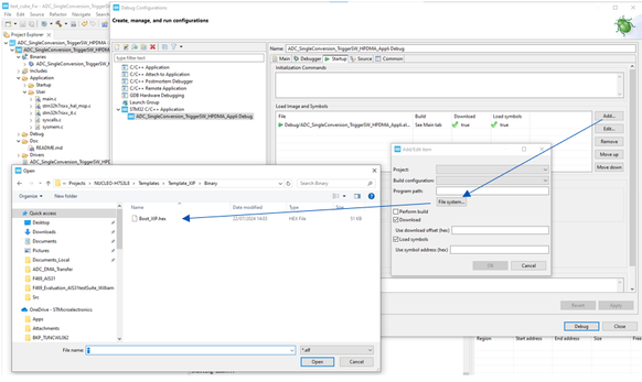

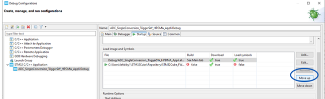

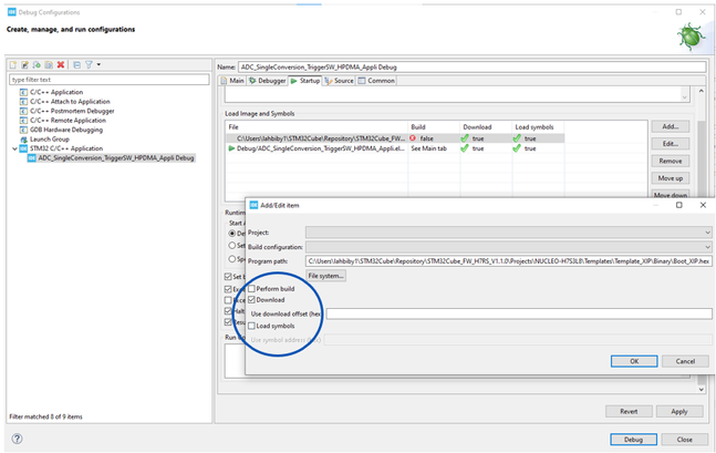

    • If your project does not contain a boot project:
Click on the [File System] tab and select the boot HEX file corresponding to your board. Find the Boot_XIP.hex in the [Binary] folder on each Template_XIP project. You may need to force the capability to select a .hex file by typing " * " and pressing the [Enter] key in the file name dialog.
Select the following options by double-clicking on the hex file to change the options
  • Click [Ok]

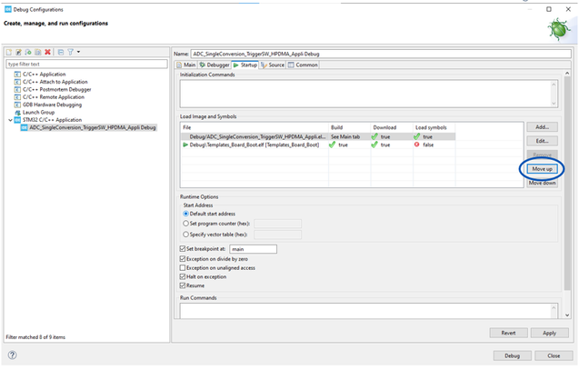

In the [Startup] tab, move the boot project down so it is in the second position. You can do this by selecting the [appli.elf file and click on the [Move up] button.CMYL_13-1730240642890.png

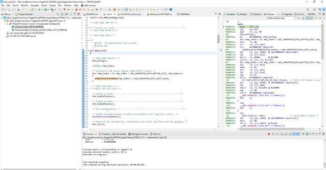

Our debug configuration is ready to use. In the screenshot below our application is executed from the flash external memory @0x70000000.
