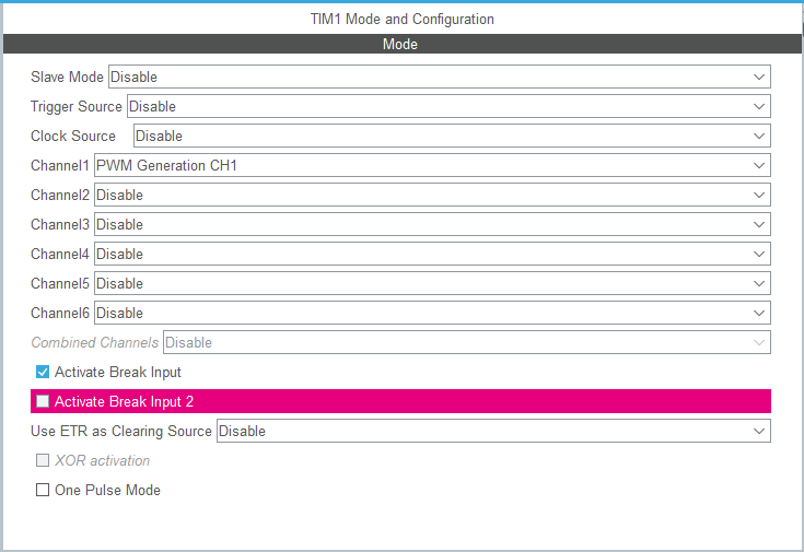

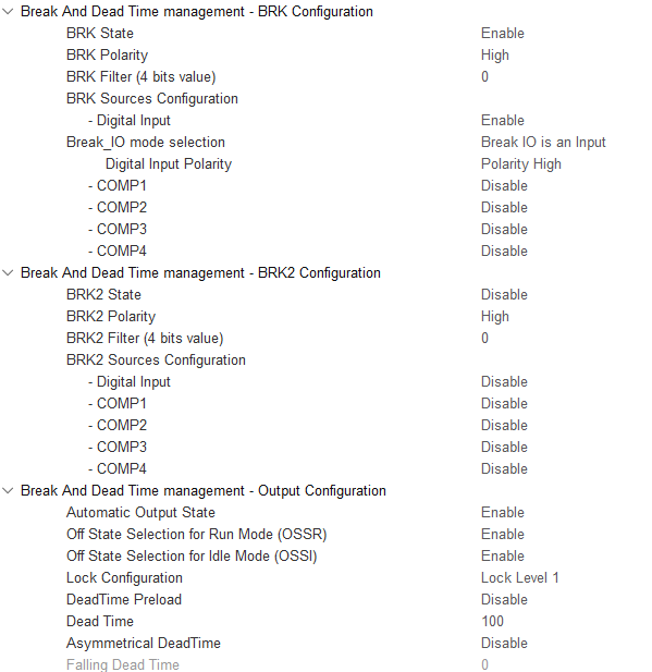

4.3 STM32CubeMX configuration
For STM32CubeMX configuration, to enable the break input feature, click on "Activate break input" after choosing an advanced timer.
After enabling the break input, you can configure these three modes as shown below:
