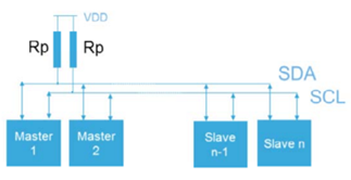

The I2C IO pins must be configured as open drain mode. The logic high level is driven by external pull-up resistor.
Typical value of I2C pull-up resistors (from practice) is between 2.2kOhm up to 10kOhm whereas customers implemented 100kOhm observing the wrong I2C bus timing. Internal pull-up resistor typical value is 40kOhm so external one must be populated.
The timing of I2C must be in line with I2C specification. You should measure and check the signal integrity on the bus.
(Figure 1: Pull-ups on I2C bus)

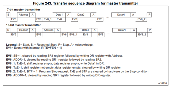

2.2 Register’s access
If you write your own I2C driver based on register access, you must always follow Reference Manual of STM32 device. There are figures "Transfer sequence" for each type of communication (master receiver, master transmitter, slave receiver, slave transmitter) with event description (EV). Each EV must be handled by the driver. Here is an example from STM32F407 - Reference manual :
 (Figure 4: Example of transfer sequence)
