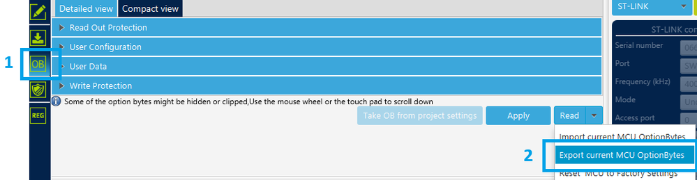

  1. Go to the option bytes menu “OB”.
  2. Click the arrow behind the [Read] button then click [Export current MCU option bytes].
  3. Browse to the location where you need to save the option file config. The file format is JSON.
  4. Give a name to the file and click [Save].
Figure 1. Exporting option bytes in the “OB” menuFigure 1. Exporting option bytes in the “OB” menu
Figure 2. Saving the option bytes file configFigure 2. Saving the option bytes file config

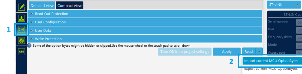

  2. Click the arrow behind the [Read] button then click [Import current MCU option bytes].

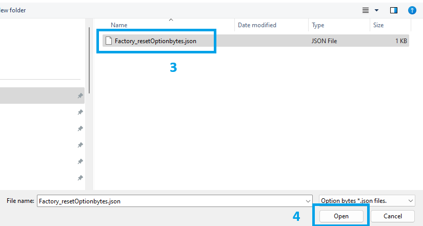

  3. Browse to the location where you saved the option file config (the factory values).
  4. Click [Open].

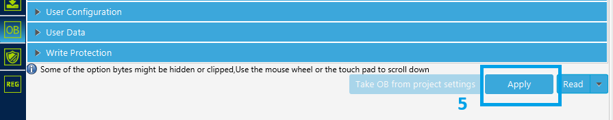

  5. Click [Apply].
Figure 3. Importing option bytes in “OB” menuFigure 3. Importing option bytes in “OB” menu
Figure 4. Opening the option bytes file configFigure 4. Opening the option bytes file config
Figure 5. Applying the new option bytes config (factory values)Figure 5. Applying the new option bytes config (factory values)
At this stage, the option bytes have been restored to their factory values.

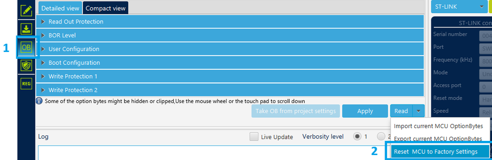

All you need to do is to connect the MCU to the STM32CubeProgrammer,
  1. Go to the option bytes menu “OB".
  2. Click on [Reset MCU to Factory Settings].
  3. Click on [Start Factory Reset].
  4. Wait until all operations are complete.

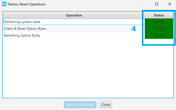

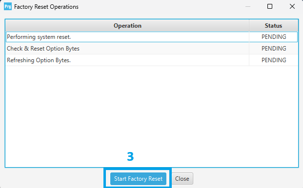

Figure 6. Using “Reset MCU to Factory Settings” optionFigure 6. Using “Reset MCU to Factory Settings” option
Figure 7. Applying the option factory settingsFigure 7. Applying the option factory settings
Figure 8. Waiting for the operations to completeFigure 8. Waiting for the operations to complete
