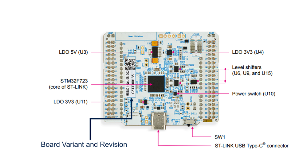

To identify your board revision, refer to the image below.
