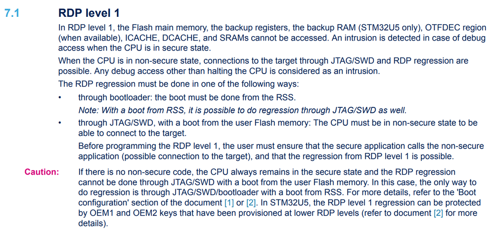

STM32CubeProgrammer gives us a brief warning, but we need to look deeper to understand why the locked state could occur. AN5347 section 7.1 has a description of how the device behaves when RDP level 1 is enabled with TrustZone®, both when executing secure and nonsecure code.
https://www.st.com/resource/en/application_note/dm00625692-stm32l5-series-trustzone-features-stmicroelectronics.pdf
As can be seen above, there are a couple of situations that can occur with RDP level 1 and TrustZone®:
  • Executing nonsecure code: In this state, the debugger is connectable.
  • Executing secure code: The debugger won't be connectable. To connect again, you must disable RDP. The only way to disable RDP since the debugger cannot be connected when executing secure code is to boot from RSS, that is, the system memory bootloader.
When executing secure code in the lock state, the only way to make the device connectable is to enter the system memory bootloader.
In this situation, avoiding a permanent lockout of the device depends on our ability to enter the system memory bootloader.
