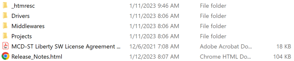

1. Package Directory Structure
The package is broken up into three major folders: drivers, middlewares, and projects.
The drivers folder contains the HAL and LL drivers for the various devices. The middlewares folder contains that EEPROM emulation software. The projects folder contains premade projects that are ready to run on STMicroelectronics development boards.

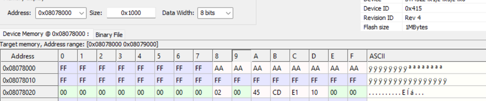

I successfully ported the emulator to my custom STM32L4 machine. I updated my parameters to the following
#define START_PAGE_ADDRESS      0x08078000
#define CYCLES_NUMBER           1U
#define GUARD_PAGES_NUMBER      2U
#define NB_OF_VARIABLES         10U
I can successfully initialize my flash and write data (and read data) if it's all within the same boot cycle. I double checked with ST-Link Utility.
ee_write_flash_16bit((uint16_t)4321, (uint16_t)0x0002);
But if I power cycle and attempt to write or read to flash again, I get error code 0x03 EE_ERROR_NOACTIVE_PAGE.

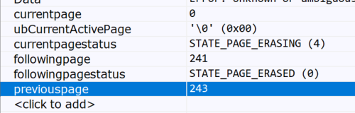

I stepped through the code my current page had the state STATE_PAGE_ERASING instead of STATE_PAGE_ACTIVE.

Just commenting to add what fixed my issue. My CRC configuration was being changed by my AES Encryption calls. So the CRC value I read from flash did not match what was initially written. I solved this by saving my CRC configuration after EE_Init, and restoring the saved configuration before every write and every read.
Working great now!
