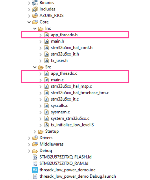

At this point in development, your project should be saved and code should be generated. After generating your project environment with C code, you should mainly be editing the “main.c” “app_threadx.c” and “app_threadx.h.”Figure 19: Project space after generating your code based on your STM32CubeMX ioc file.Figure 19: Project space after generating your code based on your STM32CubeMX ioc file.
The STM32CubMX tool automatically generates the “App_Threadx_Init” where the static memory is allocated for the entire application. A thread is created, and the semaphore is initialized to zero. Since the semaphore is initialized to zero, the main thread initially waits on the semaphore object being incremented to one before running the loop for toggling the GPIO.
Moving on to modifying our project source files, first, we make a small change for the “main.c” as shown in snippet 1. This is intended for error handling and snippet 1 is not the main subject of this article so focus your attention on snippet 2 and beyond.

Add “main.h” inside “app_threadx.h”, to use HAL drivers inside ThreadX application source file.
3.2 Edit "app_threadx.h"
Snippet 2: app_theadx.h: include main header file if not already included
#include "main.h"
/* USER CODE END Includes */
3.3 Edit "app_threadx.c"
Add macro definition and helper functional declarations inside the “app_threadx.c” file.
Snippet 3: app_threadx.c: Functions we declare and define for our low power thread application.

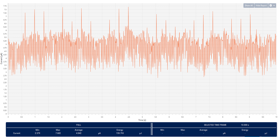

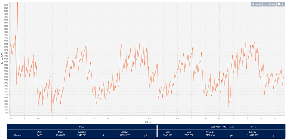

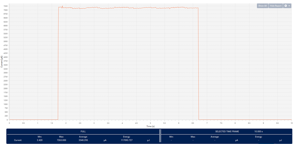

4. Test your project using STM32CubeMonitor-Power (optional)
If you are new to STM32CubeMonitor-Power, please refer to this link [8] for a detailed STMicroelectronics video on this topic. The video demonstrates using the “X-NUCLEO-LPM01A” power measuring tool, but we use the STLINK-V3PWR instead. The procedure is the same and much simpler with the STLINK-V3PWR.
We use the STLINK-V3PWR to make measurements for confirming our results. Figure 20 – 22 show the observed results. When the application is in low power mode, figure 20 is observed. When the blue user button on the Nucleo board is pressed, figure 21 and 22 (zoomed in snapshot) is observed.
Figure 20: STM32CubeMonitor-Power: Ten second time window power consumption (average 4.842uA) when idle.Figure 20: STM32CubeMonitor-Power: Ten second time window power consumption (average 4.842uA) when idle.
Figure 21: STM32CubeMonitor-Power: Ten second time window power consumption (average 3548.295uA) when blue user button pressed + also counting idle state.Figure 21: STM32CubeMonitor-Power: Ten second time window power consumption (average 3548.295uA) when blue user button pressed + also counting idle state.
Figure 22: STM32CubeMonitor-Power: Power consumption (average 7130.474uA) during the active phase of the MCU only. Idle state ignored.Figure 22: STM32CubeMonitor-Power: Power consumption (average 7130.474uA) during the active phase of the MCU only. Idle state ignored.
