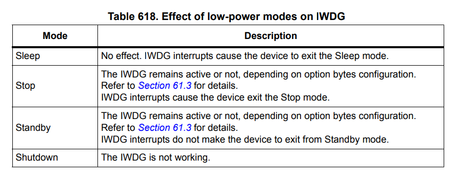

The IWDG (Independent Watchdog) offers the possibility to exit from stop modes in STM32U5. The wakeup from stop with interrupt is supported in Stop 0, Stop 1, Stop 2, and Stop 3 modes for STM32U535/545/59x/5Ax/5Fx/5Gx as described in the reference manual 0456 in table 618
Effect of LP modes on IWDGEffect of LP modes on IWDG

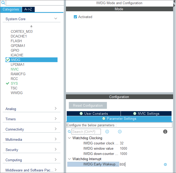

2. Activate the IWDG by checking the "Activated" box. Then, configure the "IWDG Early Wakeup" parameter as follows:
IWDG ConfigIWDG Config

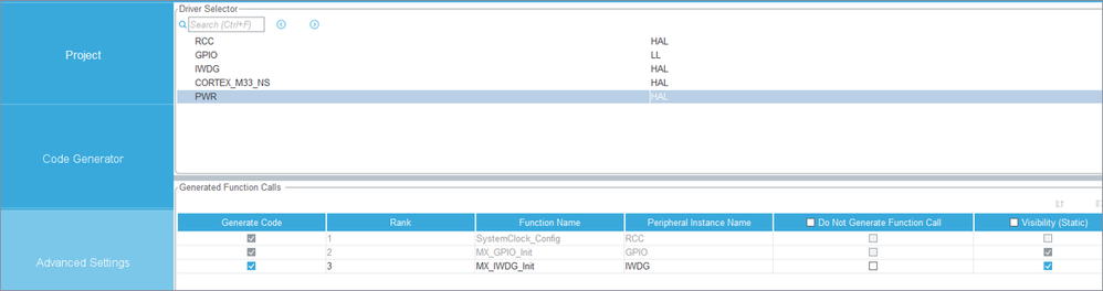

 3. For GPIO driver selector, select LL drivers
GPIO with LL driversGPIO with LL drivers
