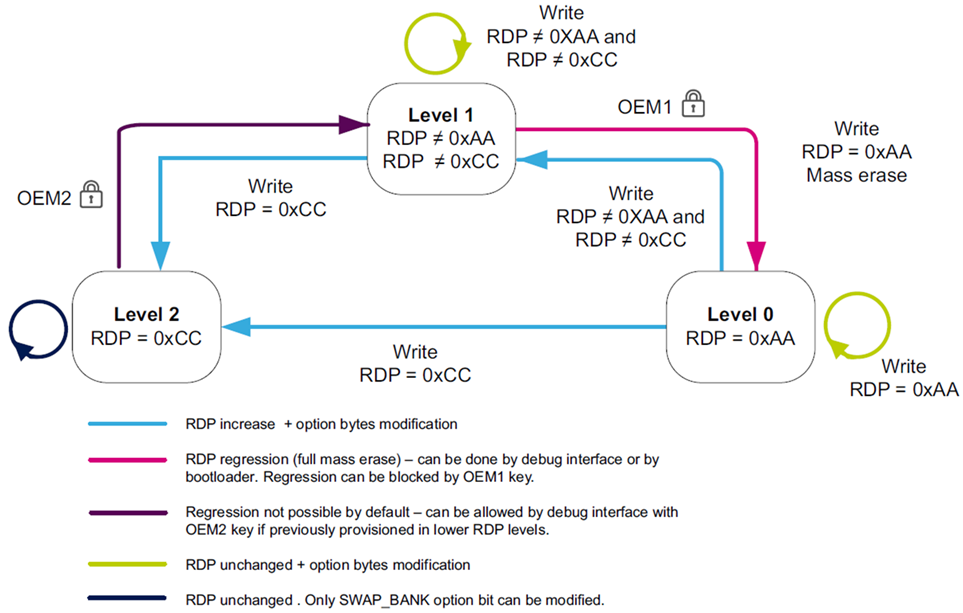

In the STM32U5 series, the RDP feature is more evolved than the older series, introducing the possibility of keyed regression, which makes it more practical to use. With the introduction of TrustZone®, we get an additional transition level called RDP L0.5. Here we explain the access permission of each level and transition and possibilities for the STM32U5 series.
1.1 Product state transition:
The STM32U5 defines product states based on RDP levels to ease the transition
1.1.1 Without TrustZone®
RDP Level 0
  • Open access: Full accessibility for development, testing, and debugging.
RDP Level 1
  • Flash protection: External access to the flash memory content is blocked.
  • Debug accessibility: RAM and CPU remain accessible via the debug port.
  • User flash updates: Allows flash content updates through user code execution.
  • Reversibility: The protection can be removed by triggering a mass erase.
RDP Level 2
  • Enhanced security: Disables the JTAG port to prevent debugging and external access.
  • User flash updates: Permits flash updates via user code.
  • Irreversibility: This protection level is permanent and can only be reversed with OEMKey2.

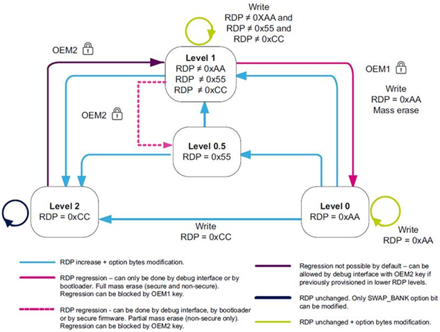

1.2 Product regression: RDP keyed regression
RDP mechanism offers the possibility for keyed regression and reopening of the product throw the provisioned OEM1 and OEM2 keys, which offer a level of flexibility while developing as well as ensuring the security of the firmware and sensitive data.
The RDP mechanism is specific to the microcontroller's flash memory and does not extend to a system-on-chip (SoC) level. It offers a binary choice between unprotected (level 0) and protected states (level 1 and level 2), with the highest level being irreversible (unless keyed regression when the OEM2 key is provisioned.) Thus, hindering certain postemployment activities such as failure analysis.

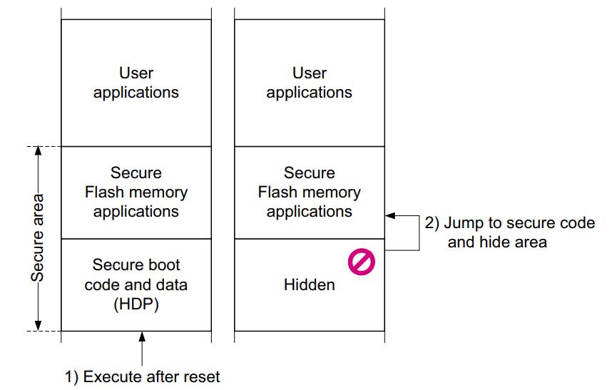

2. Hide Protection (HDP) on STM32U5:
The embedded flash memory provides a feature to define a hidden zone that can be established within each bank's watermarked-secure area, with a granularity of 8-Kbyte sectors. This HDP zone can contain code, associated data, and keys, which can be concealed from access after the system boots up and remains hidden until the system is reset. The concept of this hide protection mechanism is illustrated in the figure below from RM0456.
Flash memory secure HDP areaFlash memory secure HDP area
2.1 Transition control
When the HDPxEN and HDPx_ACCDIS bits (x = 1, 2) are set, data read, write, and
instruction fetch on the area defined by SECWMx_PSTRT and HDPx_PEND option bytes, are denied until the next device reset.
Bank erase aborts when it contains a write-protected area (WRP or HDP area).
The HDP area can be resized by a secure application if the area is not hidden, and if RDP level ≠ 2

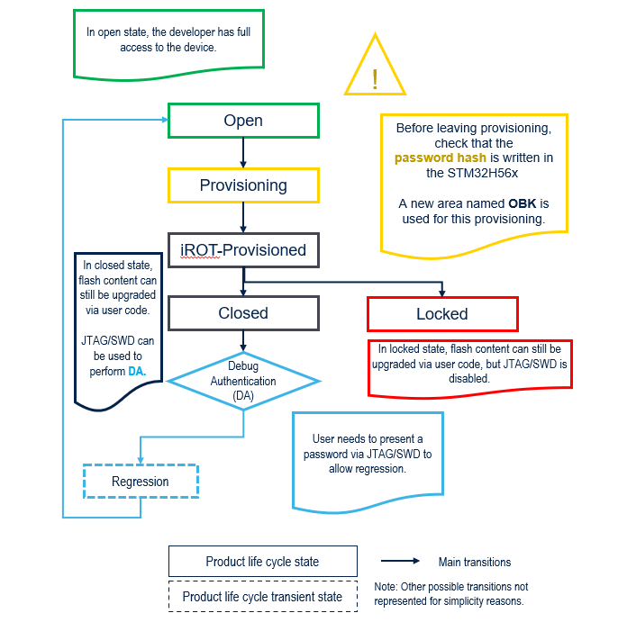

3.1.1 Without TrustZone®
  • Open State: The default state for development activities.
  • Provisioning: A new step where configuration is embedded into the device, including a password hash.
  • iROT-Provisioned: A state for when a secure boot is implemented.
  • Closed: Secures the flash content, with exit requiring password authentication.
  • Locked: A permanent state with no exit option, ensuring the highest level of security.

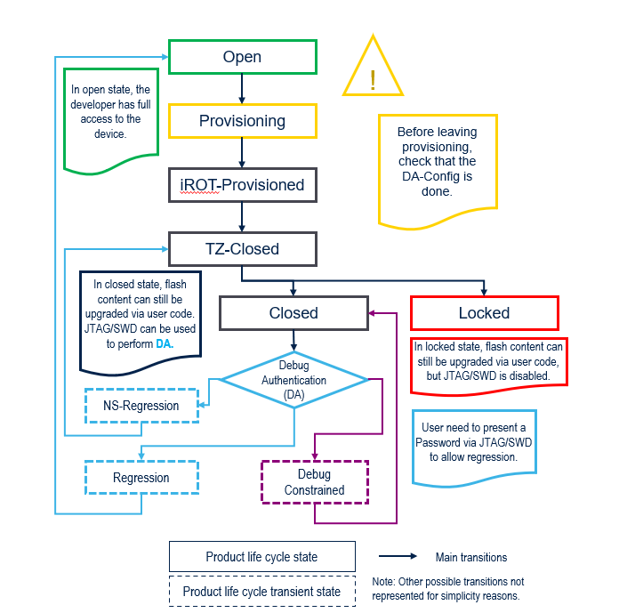

3.1.2 With TrustZone®
  • TZ-Closed: A state where the trusted domain is secured, but the non-trusted domain is still accessible for programming, erase, and debugging.
STM32H57xSTM32H57x
3.2 Product regression: Debug authentication
Password presentation: Allows the customer to present a password via JTAG/SWD to return to the open state.
This new mechanism provides a nuanced and secure method for managing the device's security throughout its life cycle. With the ability to lock and unlock states as needed, this is a key improvement over the legacy RDP feature across older families in which a miss manipulation of the option bytes can lead to a dead-locked chip.

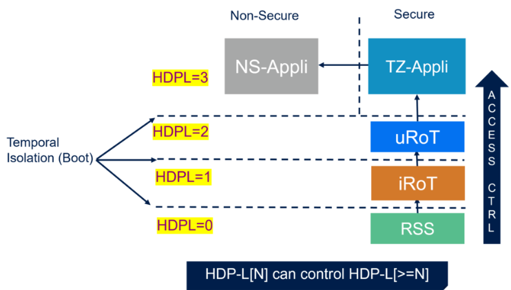

4. Hide Protection (HDP) on STM32H5: What's new?
In the STM32H5 series, HDP is extended with more defined levels ensuring different isolated BOOT stages. The hardware and software resources used to boot can be isolated. This is called temporal isolation.

4.1.2 Enhanced security levels
Unlike RDP's binary approach, HDP offers three levels, each corresponding to different stages of the secure boot process and user accessibility.
  • Level 1: Reserved for the initial secure boot stage, not user-accessible.
  • Level 2: Utilized by subsequent secure boot stages, such as the updatable Root of Trust.
  • Level 3: The final security state, post-secure boot, locking down the firmware.
