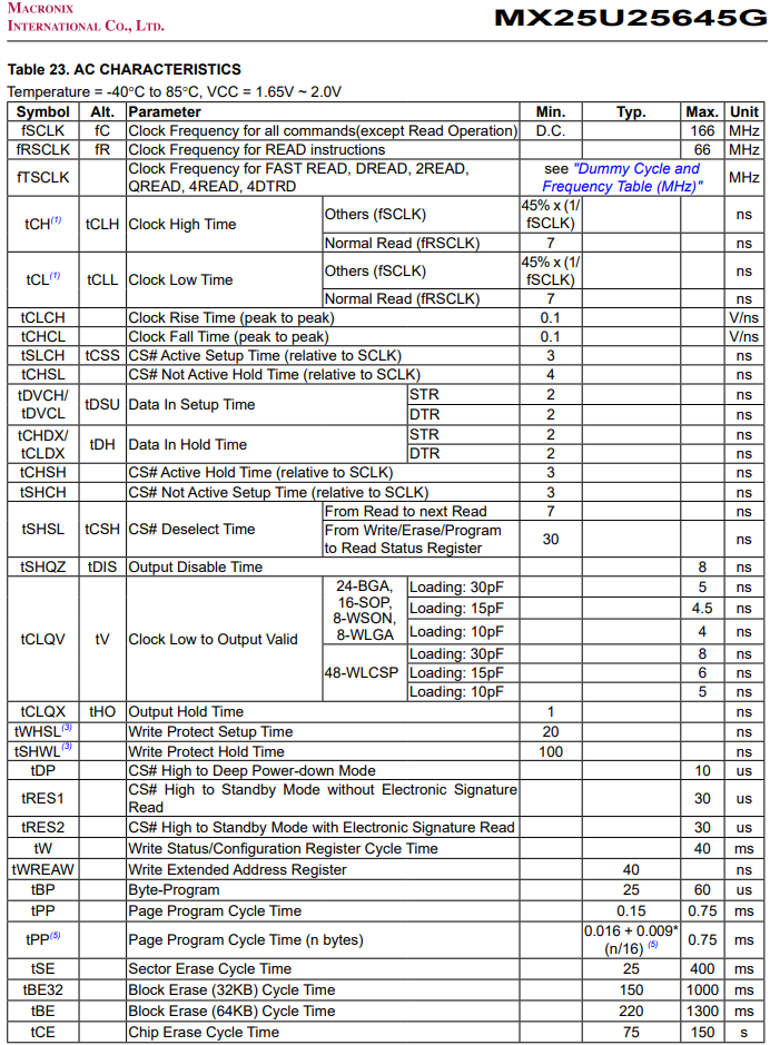

  • Below is an excerpt from the MX25U25645G datasheet (Serial Flash Device) of the AC characteristics (Table 23.) It shows the setup, hold, clock, and data valid times, among others:

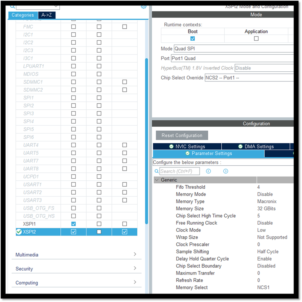

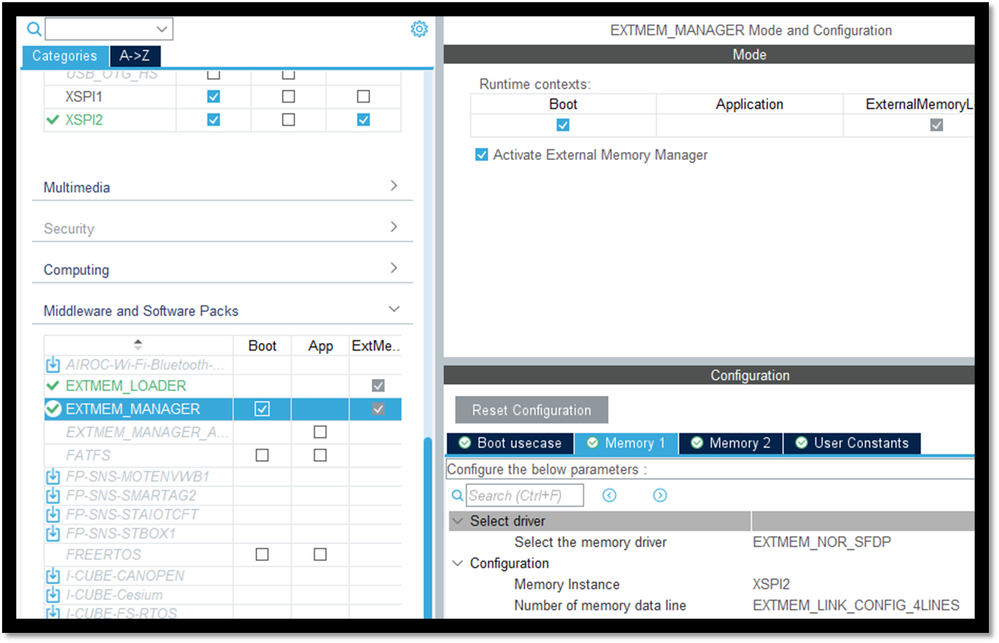

Find the screenshots of the STM32CubeMX settings for "XSPI", "External Memory Loader", and "External Memory Manager" below:

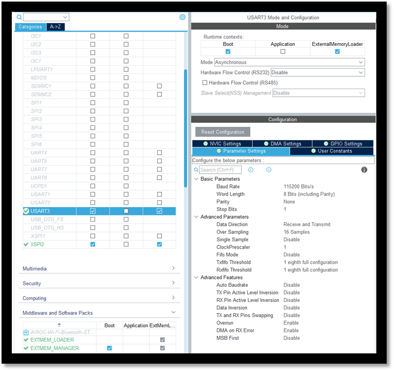

1.7 Enabling debug prints step-by-step
1.7.1 Project setup

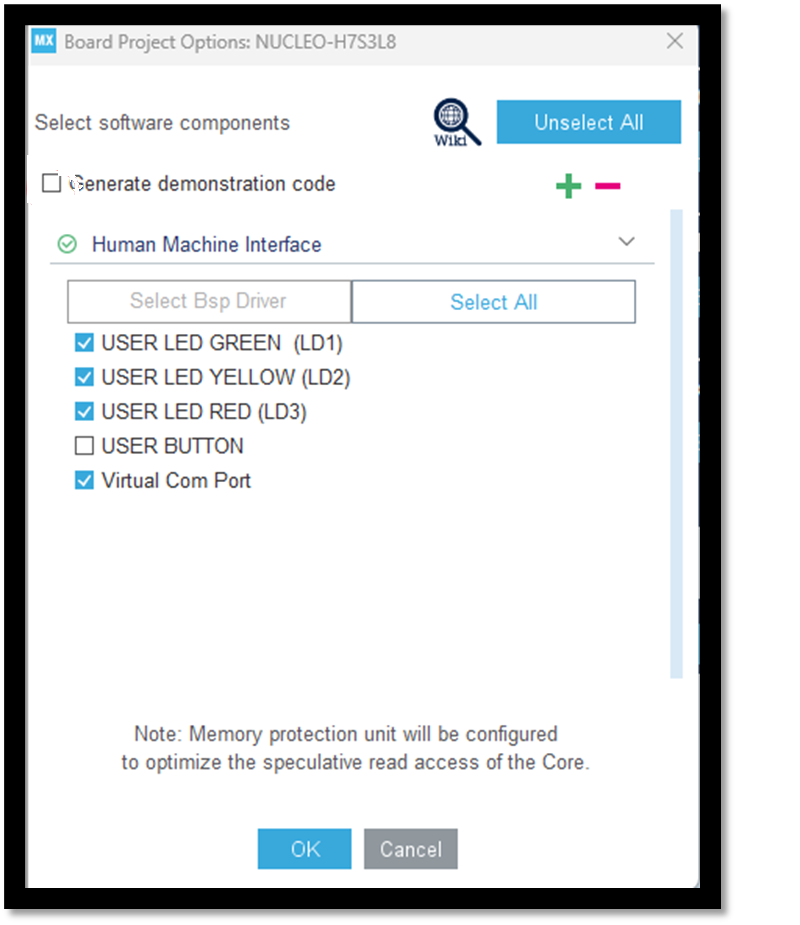

  1. Create a new project in STM32CubeMX for your target board. I chose the NUCLEO-H7S3L8. Ensure the Boot and ExternalMemoryLoader contexts are included in the project.
    Note: Untick "Generate demonstration code" for the Virtual Com Port when given the option.

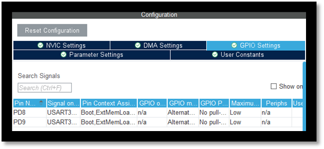

  2. Enable USART3, ensuring the pins are PD8 and PD9 for UART debug output through the Virtual Com Port.EBowdach_5-1765920891588.png EBowdach_6-1765920891591.png
  3. Enable XSPI2 for external memory interface. Refer to the example above, however for the memory on the NUCLEO-H7S3L8, octo-SPI is supported, so update accordingly.

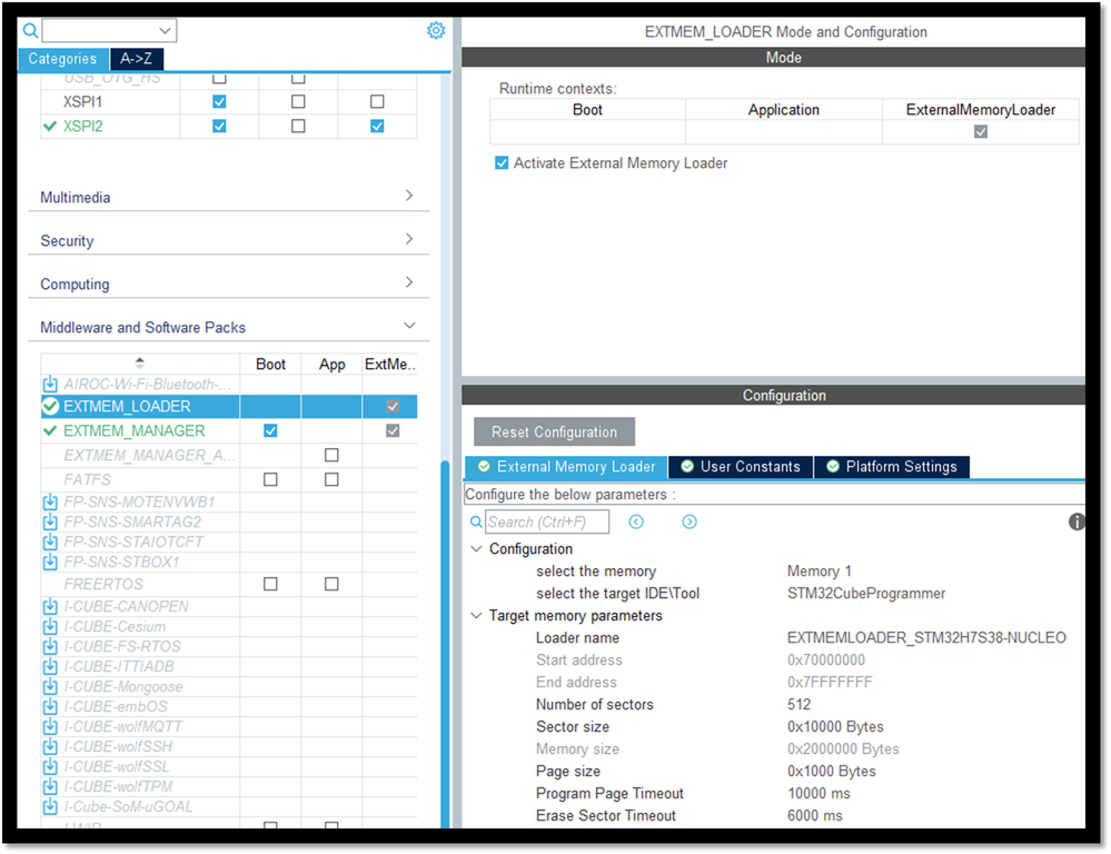

  4. Configure External Memory Manager (EMM), refer to the example above. However, the memory on NUCLEO-H7S3L8 can operate in quad-SPI or octo-SPI, so you can update the lines accordingly.
  5. Enable External Memory Loader. The loader name can be customized to your project.
  6. Generate code for your IDE; I chose STM32CubeIDE.
1.7.2 UART debug print setup in ExtMemLoader
  1. Confirm USART3 initialization and USART3 GPIO initialization.
  2. Add retargeting function to redirect printf to UART in extmemloader_init.c (ExtMemLoader project Core/Src).
  3.  Added fflush(stdout); to the EXTMEM_TRACE function in stm32_extmem.c (in Middlewares).

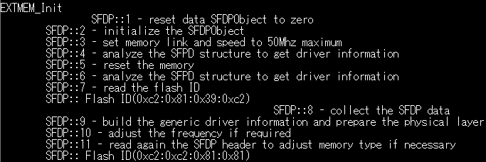

  1. Minimal tests, breakpoints, and verify output in a serial terminal like Tera Term (correct COM port, 115200 baud, 8N1).
  2. Here’s the expected output with the external memory initialization using EXTMEM_MACRO_DEBUG as described above:
Now, you can use this custom external loader for your Boot and Appli projects!
