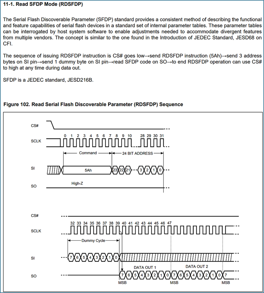

Selecting external memories that comply with these standards ensures broad compatibility, easier debugging, and access to proven software and hardware resources. As an example, here is a link and a snippet from the MX25U25645G datasheet, a 1.8 V, 256M-BIT CMOS NOR Serial Flash Memory, of the memory’s Read SFDP Mode. This memory is similar to the memory used on the NUCLEO-H7S3L8 board, MX25UW25645G. The MX25U25645G memory device complies with JEDEC standards for Serial Flash Discoverable Parameters (SFDP), which provide a standardized method to describe memory characteristics and timings.

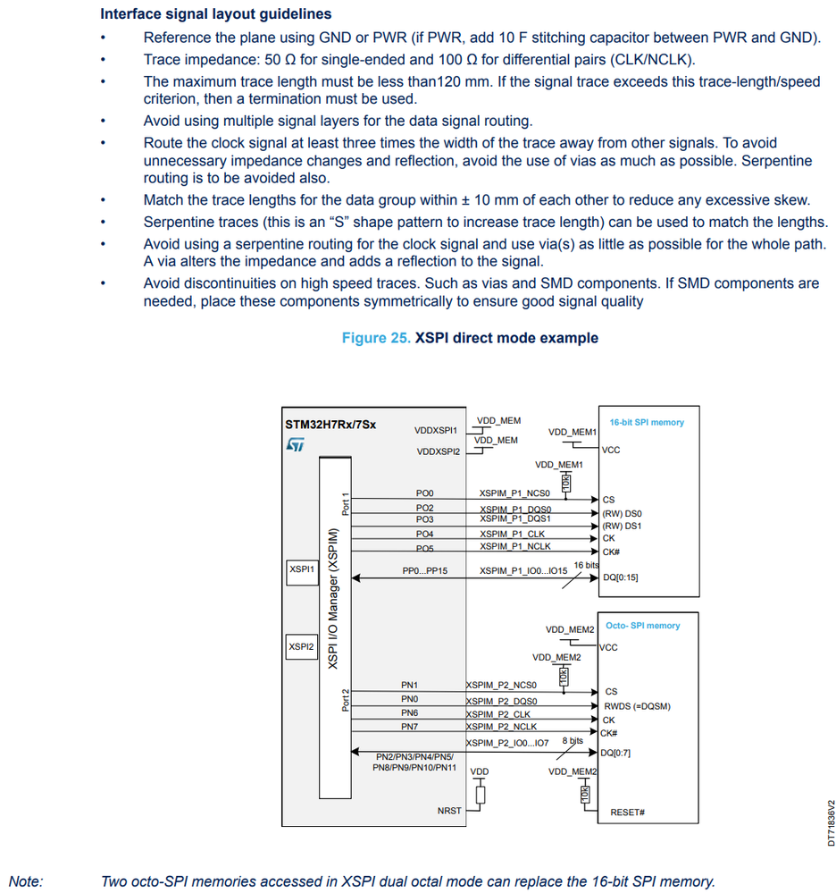

2.6 PCB layout
  • Keep high-speed traces short, matched in length, and routed with controlled impedance.
  • Avoid stubs, sharp corners, and crossing split ground planes.
  • Separate analog and digital grounds.
  • AN5935 has more details on PCB layout guidelines for high speed signal layouts for SDMMC, FMC, XSPI in section 10.4 (for the STM32H7R/S), please see XSPI details from section 10.4.3 below:
