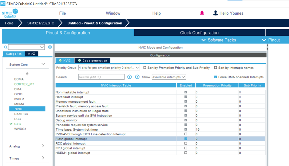

a. Create a new STM32H7 project using STM32CubeMX and enable the flash global interrupt line of NVIC.
b. In the .IOC file, go to [System Core] → [NVIC] and enable the flash global interrupt as follows:

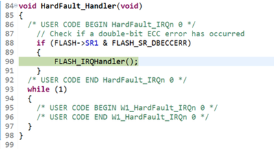

d. When a double bit ECC error occurs in flash, the HardFault handler is called instead of the flash IRQ handler. To get around this, add a check in the HardFault handler to see if a double bit error occurred in flash:
  * @brief This function handles Hard fault interrupt.
void HardFault_Handler(void)
  /* USER CODE BEGIN HardFault_IRQn 0 */
	// Check if a double-bit ECC error has occurred
	if (FLASH->SR1 & FLASH_SR_DBECCERR)
		FLASH_IRQHandler();
  /* USER CODE END HardFault_IRQn 0 */

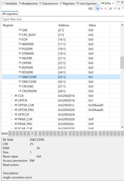

e. Debug will trigger the single error correction callback. Set a breakpoint inside the single error callback function and you can see that an ECC single error interrupt happened:
The SNECCERR flag will also be set in the FLASH_SR register to indicate a single error detection correction.

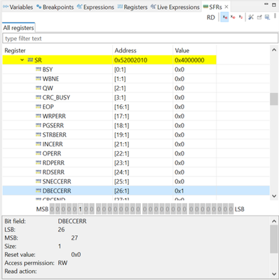

d. Debug triggers the Hardfault handler and the double error flag will be set in the FLASH_SR register to indicate a double error detection correction.

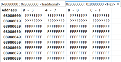

The first programming of DoubleErrorB is observed in the debug memory window below:

The flag is also set in the FLASH_SR register as follows:

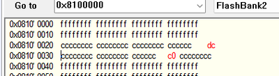

The debugger is not able to read the content of programmed 256-bit due to the double error detection. Corrupted data will be seen in the memory window at this address:
