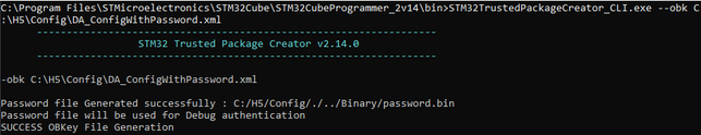

Step 1: Create the provisioning file (.obk file)
Use the CLI command below to generate the provisioning file using the path to the .xml file.
STM32TrustedPackageCreator_CLI.exe –obk <path to .xml file>
The command generates the password.bin and DA_ConfigWithPassword.obk file by default in the \binary folder, relative to the .xml file’s location in the .config file.
The command should run successfully as shown below. The successful execution logs show the location where the files are generated.
Here, the .xml file can be edited to update the password as desired. But, for this demonstration we use the file as is.

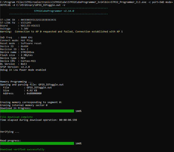

Step 2: Program the application binary
For this step, we use the STM32CubeProgrammer CLI tool. It is used to connect the utility to the board in hotplug mode and pass the file path to the application binary file. Use the command below:
STM32_Programmer_CLI.exe -c port=SWD mode=HOTPLUG -d <file path to the application binary> -v
The command should successfully run as shown below, and it should run the application code on the hardware.
Reset the board after the success message to observe the LED blinking.

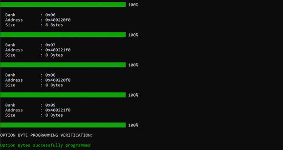

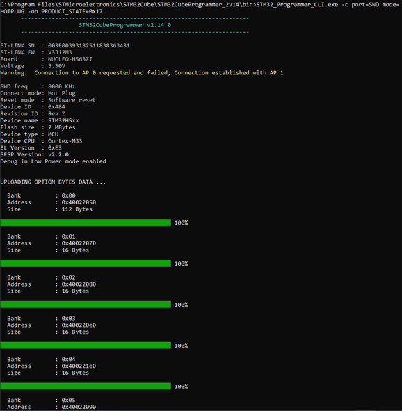

Step 3: Move to the PROVISIONING state.
Using the STM32CubeProgrammer CLI tools, we set the production state to 0x17 in the option byte configuration using the command below:
STM32_Programmer_CLI.exe -c port=SWD mode=HOTPLUG -ob PRODUCT_STATE=0x17

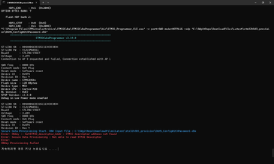

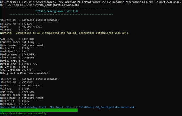

Step 4: Provisioning the .obk file
We use the STM32CubeProgrammer CLI tool to provision the previously created .obk file. We leverage the ‘-sdp’ command to start the OBKey provisioning using the .obk file path as shown in the screen capture below.
Use the command:
STM32_Programmer_CLI.exe -c port=SWD mode=HOTPLUG -sdp <.obk complete file path>
The logs show that the secure data provisioning has been completed successfully by provisioning the .obk file with the included password.

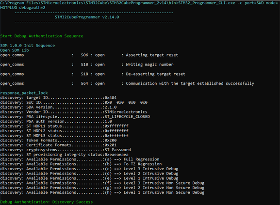

Phase 1: Discovery
To “Discover” the device, we use the command below. Setting "debugauth" to "2" allows discovery and fetches the necessary details and state of the MCU.
STM32_Programmer_CLI.exe -c port=SWD mode=HOTPLUG debugauth=2
As shown in the image above, the PSA life cycle is set to ST_LIFECYCLE_CLOSED. This confirms that the device is in the closed state and can be regressed out using the debug authentication. After verifying this, we can enter into the second phase of the process.

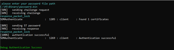

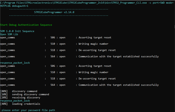

Phase 2: Regression
We use the “debugauth=1” command to provision the password binary as in the command below:
STM32_Programmer_CLI.exe -c port=SWD mode=HOTPLUG debugauth=1
As shown in the image, the tools prompt you to enter the path to the password file (password.bin by default in this case). Once that is done, the tool shows the “Debug Authentication Success” message.
After this stage, the flash will be mass erased. You will not see your application firmware running anymore. In this case, we will not see the user LED blinking anymore.

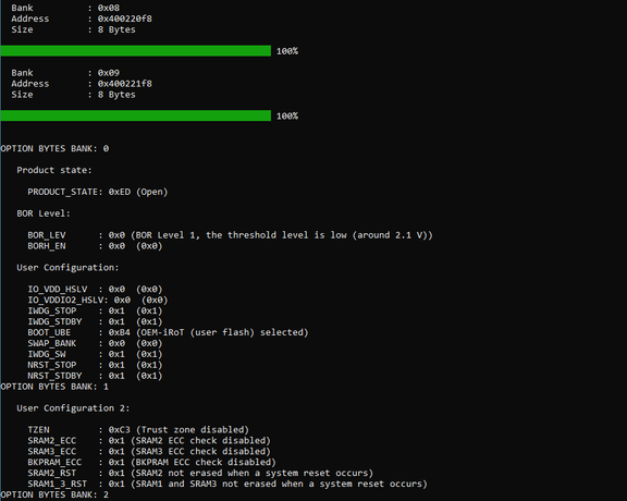

Now, we can access the MCU’s debug port again. We can verify it by checking the current product state, which is set to OPEN. You can use the command below to do the same:
STM32_Programmer_CLI.exe -c port=SWD mode=HOTPLUG -ob displ
All these steps sum up the entire process of the debug authentication for STM32H5 with TrustZone® disabled. This process can be used as a reference to be integrated with the production environment. Furthermore, to have it automated for mass production which might not be possible for the GUI based tool.

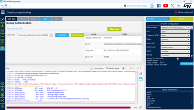

Hi, I have accidentally set the option byte PRODUCT_STATE=0x17 and the device is locked and shows the following when I do DA discover
10:58:30 : STM32CubeProgrammer API v2.17.0 | Windows-64Bits
10:58:34 : UR connection mode is defined with the HWrst reset mode
10:58:34 : ST-LINK SN  : 0006001B4741500120383733
10:58:34 : ST-LINK FW  : V3J15M6
10:58:34 : Board       : NUCLEO-H563ZI
10:58:34 : Voltage     : 3.28V
10:58:34 : Error: ST-LINK error (DEV_CONNECT_ERR)
10:58:48 : Start STLinkUpgrade...
10:59:10 : UR connection mode is defined with the HWrst reset mode
10:59:10 : ST-LINK SN  : 0006001B4741500120383733
10:59:10 : ST-LINK FW  : V3J15M6
10:59:10 : Board       : NUCLEO-H563ZI
10:59:10 : Voltage     : 3.28V
10:59:10 : Error: ST-LINK error (DEV_CONNECT_ERR)
10:59:22 : Start Debug Authentication Sequence
10:59:22 : SDMOpen                       :   602 : open       : SDM API v1.0
10:59:22 : SDMOpen                       :   603 : open       : SDM Library version v1.1.0
10:59:22 : open_comms                    :   495 : open       : Asserting target reset
10:59:22 : open_comms                    :   499 : open       : Writing magic number
10:59:22 : open_comms                    :   509 : open       : De-asserting target reset
10:59:22 : open_comms                    :   561 : open       : Communication with the target established successfully
10:59:22 : discovery: target ID.......................:0x484
10:59:22 : discovery: SoC ID..........................:0x00000000_00000000_00000000_00000000
10:59:22 : discovery: SDA version.....................:2.1.0
10:59:22 : discovery: Vendor ID.......................:STMicroelectronics
10:59:22 : discovery: PSA lifecycle...................:ST_LIFECYCLE_PROVISIONING
10:59:22 : discovery: PSA auth version................:1.0
10:59:22 : discovery: ST HDPL1 status.................:0xffffffff
10:59:22 : discovery: ST HDPL2 status.................:0xffffffff
10:59:22 : discovery: ST HDPL3 status.................:0xffffffff
10:59:22 : discovery: Token Formats...................:0x200
10:59:22 : discovery: Certificate Formats.............:0x201
10:59:22 : discovery: cryptosystems...................:ST Password
10:59:22 : discovery: ST provisioning integrity status:0xf5f5f5f5
10:59:22 : discovery: permission if authorized...........:Full Regression

11:03:08 : discovery: ST HDPL2 status.................:0xffffffff
11:03:08 : discovery: ST HDPL3 status.................:0xffffffff
11:03:08 : discovery: Token Formats...................:0x200
11:03:08 : discovery: Certificate Formats.............:0x201
11:03:08 : discovery: cryptosystems...................:ST Password
11:03:08 : discovery: ST provisioning integrity status:0xf5f5f5f5
11:03:08 : discovery: permission if authorized...........:Full Regression
11:07:08 : UR connection mode is defined with the HWrst reset mode
11:07:08 : ST-LINK SN  : 0006001B4741500120383733
11:07:08 : ST-LINK FW  : V3J15M6
11:07:08 : Board       : NUCLEO-H563ZI
11:07:08 : Voltage     : 3.28V
11:07:08 : Error: Cannot connect to access port 1!  If you are trying to connect to a device with TrustZone enabled please try to connect with HotPlug mode.  If you are trying to connect to a device which supports Debug Authentication with certificate or password, please open your device using it.
11:07:12 : UR connection mode is defined with the HWrst reset mode
11:07:12 : ST-LINK SN  : 0006001B4741500120383733
11:07:12 : ST-LINK FW  : V3J15M6
11:07:12 : Board       : NUCLEO-H563ZI
11:07:12 : Voltage     : 3.28V
11:07:12 : Error: Cannot connect to access port 1!  If you are trying to connect to a device with TrustZone enabled please try to connect with HotPlug mode.  If you are trying to connect to a device which supports Debug Authentication with certificate or password, please open your device using it.
11:07:18 : Start Debug Authentication Sequence
11:07:18 : SDMOpen                       :   602 : open       : SDM API v1.0
11:07:18 : SDMOpen                       :   603 : open       : SDM Library version v1.1.0
11:07:18 : open_comms                    :   495 : open       : Asserting target reset
11:07:18 : open_comms                    :   499 : open       : Writing magic number
11:07:18 : open_comms                    :   509 : open       : De-asserting target reset
11:07:18 : open_comms                    :   561 : open       : Communication with the target established successfully
11:07:18 : discovery: target ID.......................:0x484
11:07:18 : discovery: SoC ID..........................:0x00000000_00000000_00000000_00000000
11:07:18 : discovery: SDA version.....................:2.1.0
11:07:18 : discovery: Vendor ID.......................:STMicroelectronics
11:07:18 : discovery: PSA lifecycle...................:ST_LIFECYCLE_PROVISIONING
11:07:18 : discovery: PSA auth version................:1.0
11:07:18 : discovery: ST HDPL1 status.................:0xffffffff
11:07:18 : discovery: ST HDPL2 status.................:0xffffffff
11:07:18 : discovery: ST HDPL3 status.................:0xffffffff
11:07:18 : discovery: Token Formats...................:0x200
11:07:18 : discovery: Certificate Formats.............:0x201
11:07:18 : discovery: cryptosystems...................:ST Password
11:07:18 : discovery: ST provisioning integrity status:0xf5f5f5f5
11:07:18 : discovery: permission if authorized...........:Full Regression
 I have not provide any obk or password. How can I unlock a device from this state? We have several devices in a state like this. It will be super useful if we can recover from this.

According to the help output, I should be able to use pwd=<password_file_path> with debugauth=1
Debug Authentication options:
      [debugauth=<1|2>]               : to choose starting authentication(1) or discovery(2)
      [pwd=<password_file_path>]      : required in case of authentication with password
However, this is not working for me, the CLI tool keeps asking me to enter a password file path.
This makes it very hard (if not impossible) to use from an automated script.
It would be nice if we could pass the name of the password file (or even better: the password value itself) as a command argument.
The help output also shows this:
 -pwd                    : Start Provisioning with password
 value=<password_value>           : Password value
But that does not work either, in combination with debugauth=1

Hello @Ruchit N ,
I encountered the error "GetSTM32_descriptor_Addr: STM32 descriptor address not found" while attempting to provision an OBK (Option Byte Key) file on the STM32H503.
I confirmed that the Product State is set to 0x17 (Provisioning) in the Option Bytes.
However, when attempting to perform OBK provisioning from this state, I encountered the following error message:
Any suggestions or insights would be greatly appreciated.
This is batch file I wrote as below.
 off
setlocal enabledelayedexpansion
set "STPROGfilepath=C:\Program Files\STMicroelectronics\STM32Cube\STM32CubeProgrammer\bin\STM32_Programmer_CLI.exe"
set "STTPCfilepath=C:\Program Files\STMicroelectronics\STM32Cube\STM32CubeProgrammer\bin\STM32TrustedPackageCreator_CLI.exe"
set "xmlfilepath=C:\SWgitRepo\DownloadFiles\Latest\stm32h503_provision\DAH5_ConfigWithPassword.xml"
set "obkfilepath=C:\SWgitRepo\DownloadFiles\Latest\stm32h503_provision\DAH5_ProvisionResult.obk"
set "obkfilepath=C:\SWgitRepo\DownloadFiles\Latest\stm32h503_provision\DAH5_ConfigWithPassword.obk"
:: Step 1: Create the provisioning file (.obk file)
"%STTPCfilepath%" -obk "%xmlfilepath%" -out "%obkfilepath%"
set "CMD="!STPROGfilepath!" -c port=SWD -i
echo !CMD!
!CMD!
:: Step 3: Move to the PROVISIONING state.
set "CMD="!STPROGfilepath!" -c port=SWD mode=HOTPLUG -ob PRODUCT_STATE=0x17"
echo !CMD!
!CMD!
:: Step 4: Provisioning the .obk file
set CMD="!STPROGfilepath!" -c port=SWD mode=HOTPLUG -sdp "!obkfilepath!"
echo !CMD!
!CMD!
pause
This is xml file as below.
<Root xmlns:xsi="http://www.w3.org/2001/XMLSchema-instance" xsi:noNamespaceSchemaLocation="SCHVerif.xsd">
<Obdata>
<Info>
<Title>STM32H5 - Debug Authentication Configuration</Title>
<ObDestAddress>0x0ffd0100</ObDestAddress>
<DoEncryption>0</DoEncryption>
<GlobalAlign>16</GlobalAlign>
<MCU>STM32H5</MCU>
</Info>
<Hash> </Hash>
<DA> </DA>
<Text>
<Name>Password</Name>
<Value>0123456789abcdef</Value>
<MinWidth>4</MinWidth>
<Width>16</Width>
<Default>0000</Default>
<Tooltip>Enter password</Tooltip>
</Text>
<Data>
<Name>Reserved</Name>
<Value>0x00000000</Value>
<Width>4</Width>
<Reserved>1</Reserved>
<Default>0x00000000</Default>
</Data>
<Output>
<Name>Output File</Name>
<Value>../DAH5-ConfingWithPassword.obk</Value>
<Default>../DAH5-ConfingWithPassword.obk</Default>
<Tooltip>Enter Output OBKey File with extension .obk</Tooltip>
</Output>
</Obdata>
</Root>
Thank you.
Regards,
LloydSeo.
Has anyone successfully performed OBK file provisioning on the STM32H503?
If so, I would greatly appreciate any tips or solutions you could share!
