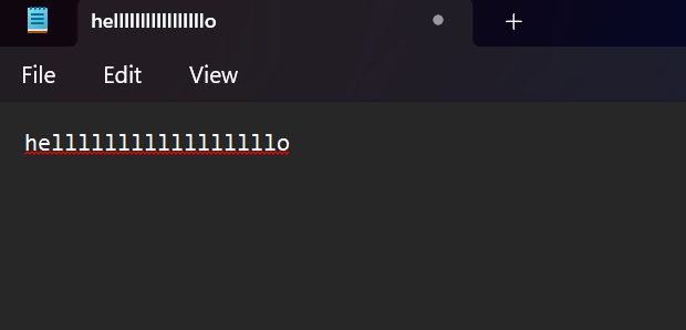

5. Expected behavior
When opening a text editor, notepad for example, then pressing the USER button on the board, you get the following result as shown in the screenshot below:
