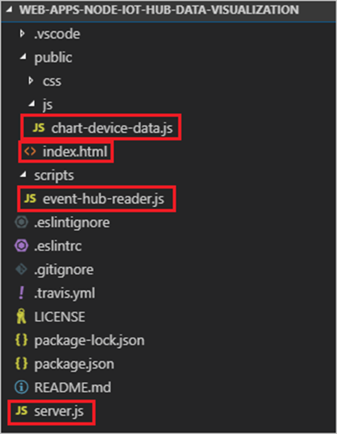

From the web-apps-node-iot-hub-data-visualization directory, open the web app in your favorite editor( I have used Visual Studio Code here for which you need to write code. ). The following shows the file structure viewed in VS Code:
Take a moment to examine the following files:
  1. Server.js is a service-side script that initializes the web socket and the Event Hub wrapper class. It provides a callback to the Event Hub wrapper class that the class uses to broadcast incoming messages to the web socket.
  2. Event-hub-reader.js is a service-side script that connects to the IoT hub's built-in endpoint using the specified connection string and consumer group. It extracts the DeviceId and EnqueuedTimeUtc from metadata on incoming messages and then relays the message using the callback method registered by server.js.
  3. Chart-device-data.js is a client-side script that listens on the web socket, keeps track of each DeviceId, and stores the last 50 points of incoming data for each device. It then binds the selected device data to the chart object.
  4. Index.html handles the UI layout for the web page and references the necessary scripts for client-side logic.

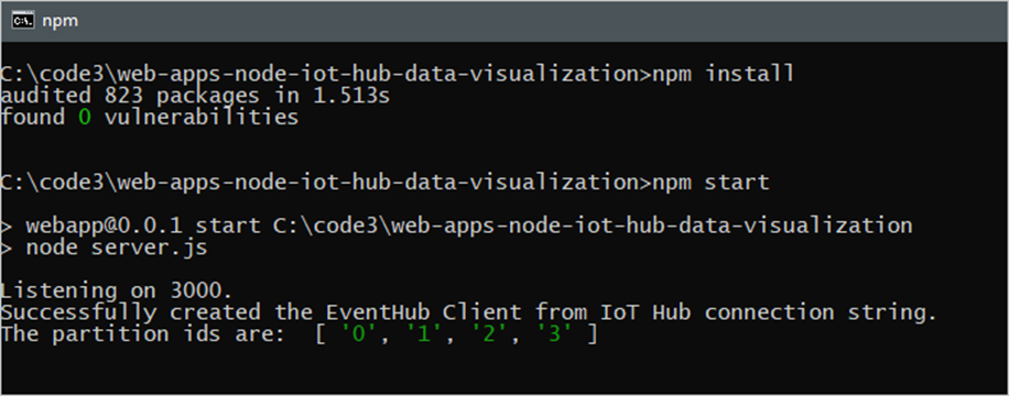

  2. In the command window, run the following lines to download and install referenced packages and start the website:
Cmd
npm install
npm start
  1. You should see output in the console that indicates that the web app has successfully connected to your IoT hub and is listening on port 3000

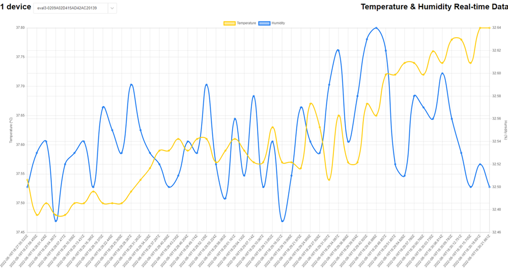

Open a browser to http://localhost:3000.
In the Select a device list, select your device to see a running plot of the last 50 temperature and humidity data points sent by the device to your IoT hub.
