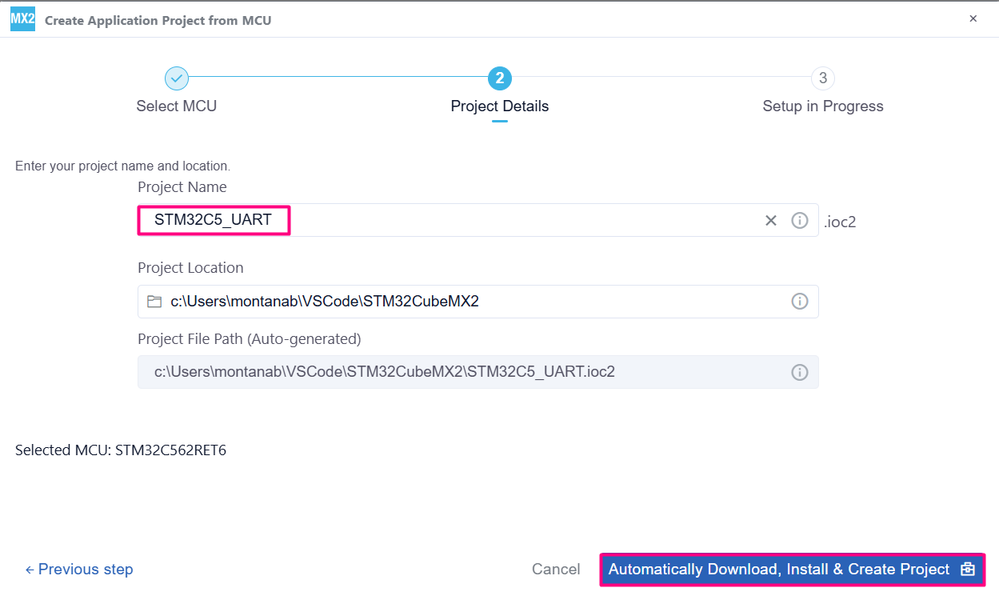

Enter the project name and location. Click [Automatically Download, Install & Create Project] to finish project creation.

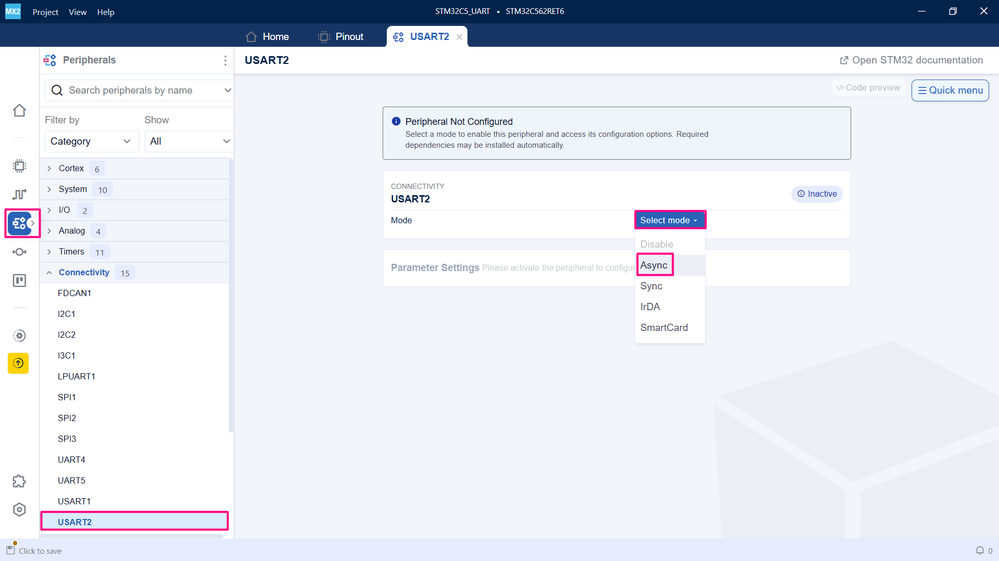

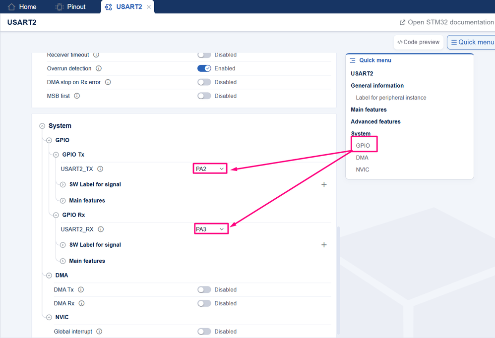

In STM32CubeMX2, go to the [Peripherals] section, then click [Connectivity]. Enable the UART by selecting the Async mode.

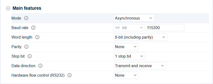

Configure the USART2 peripheral as shown in the figure:
The VCOM bridge available on the NUCLEO board uses USART2_TX and USART2_RX associated with PA2 and PA3, but these might not be the default pins selected. To change the GPIOs used, scroll down and change the GPIO Tx/Rx pins.

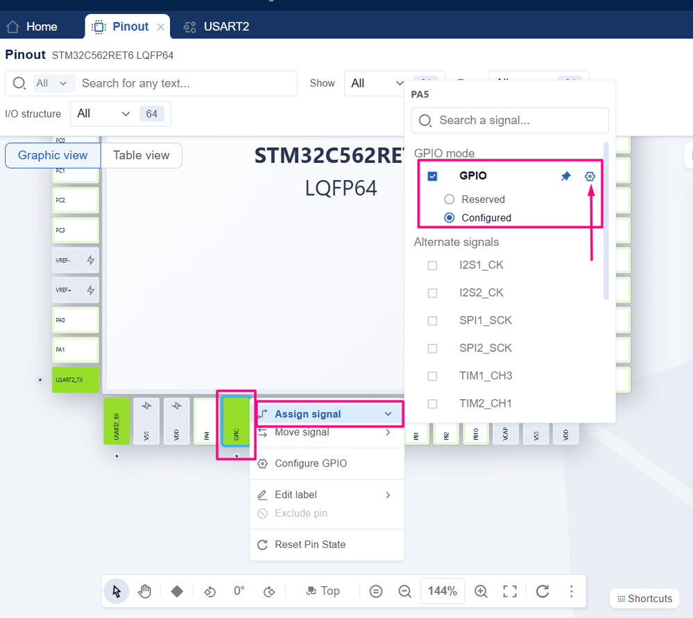

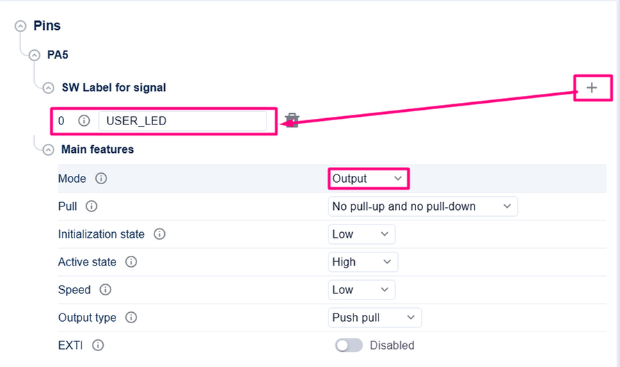

Change to the "Pinout" tab, and add the USER LED. Right-click on PA5, set it as a GPIO pin, then click the Engine icon.
The GPIO configuration tab appears. Configure the GPIO label as USER_LED and set the pin as Output Push Pull.

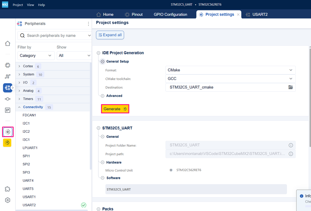

To generate the code:
  1. Click the [Project settings] icon and select the desired IDE.
  2. Click the [Generate] button.

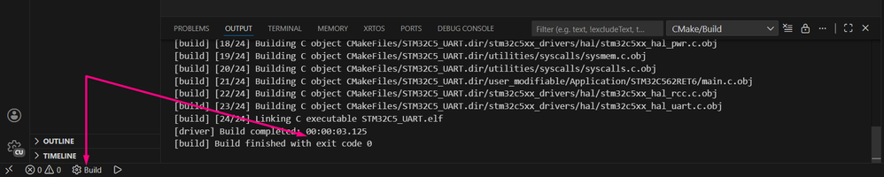

If prompted, select the configuration. If not prompted, press Ctrl+Shift+P, type CMake: Select Configure Preset, and choose the debug configuration.
Build the project to ensure everything is set, then proceed to code implementation.

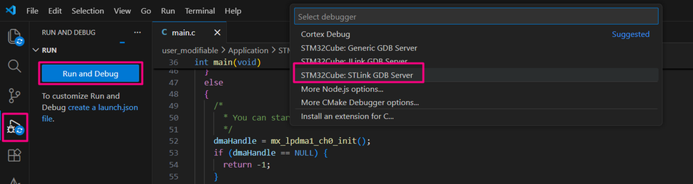

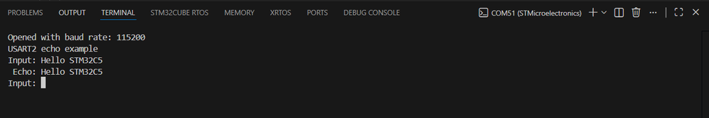

After building the application, select the [Run and Debug] icon. Create a debug session by selecting the STM32Cube: STLINK GDB Server option.
Press Ctrl+Shift+P and type [Open Serial] > COMXY (STMicroelectronics) > 115200.BMontanari_14-1769790160939.png

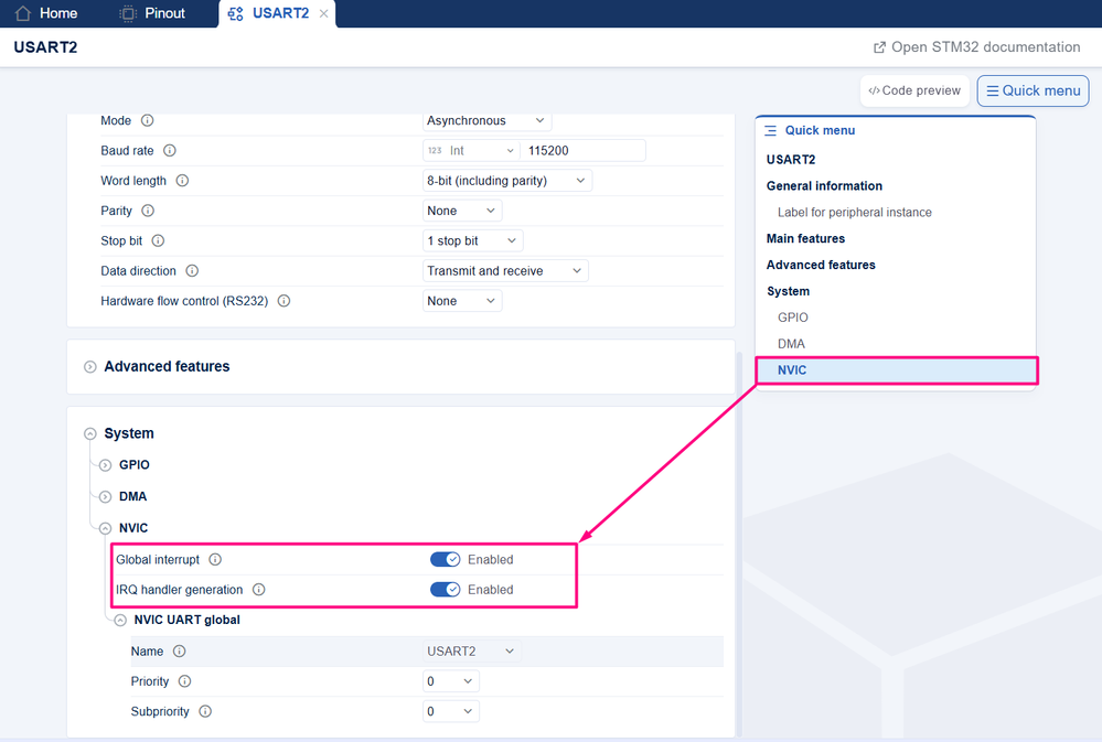

Go to the "USART2" tab in STM32CubeMX2 and scroll down to the "System" option or click [NVIC] in the Quick menu.
Regenerate your project.

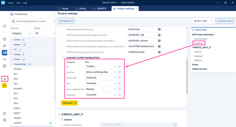

Pro-tip: You can use the advanced settings to specify how to re-generate your project. For example, it is possible to create a backup of the previous example.

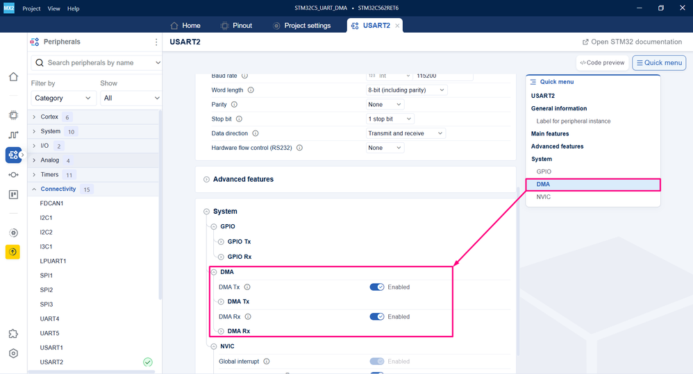

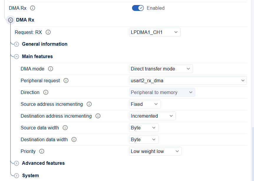

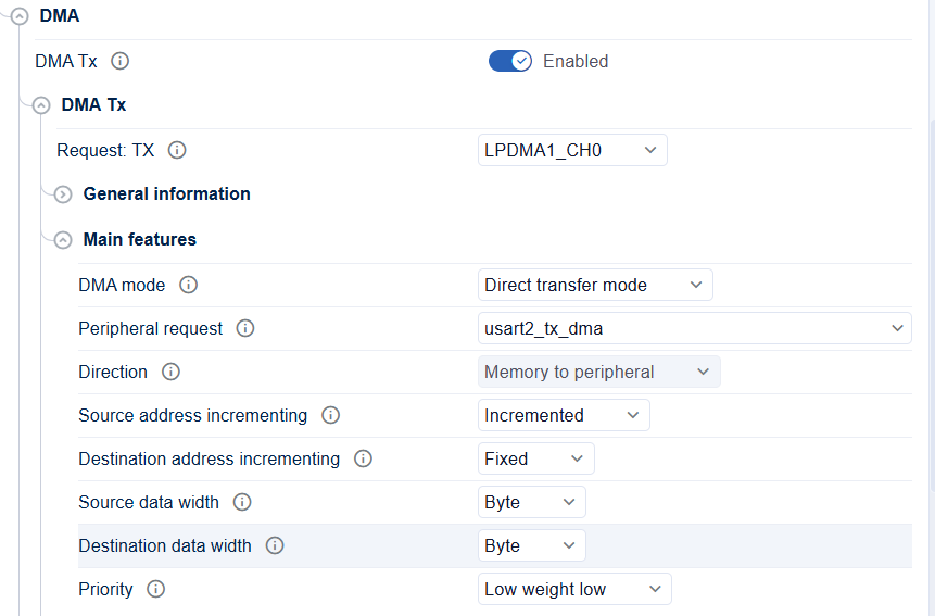

Go to the USART2 tab in STM32CubeMX2 and scroll down to the [System] option or click DMA in the Quick menu.
Enable DMA Tx and Rx and open their drop-down menus.
Regenerate your project and open it in your desired IDE.
This firmware sets up STM32 to handle UART communication asynchronously using DMA, allowing the processor to multitask. Upon startup, the system immediately activates the receiver to listen for incoming data in the background.
