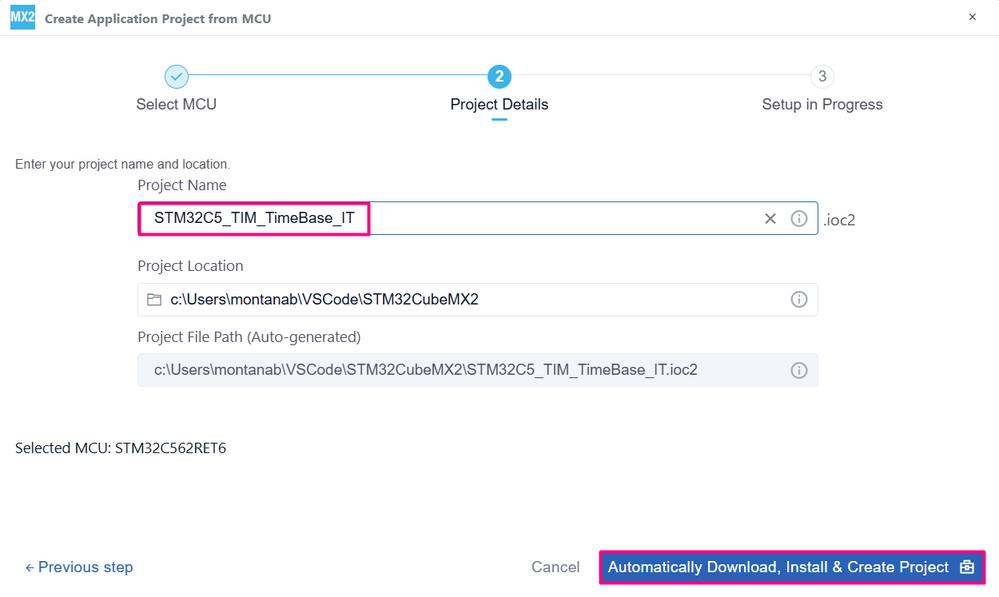

Enter the project name and location. Click [Automatically Download, Install & Create Project] to finish project creation.
Select [Launch Project] to start.

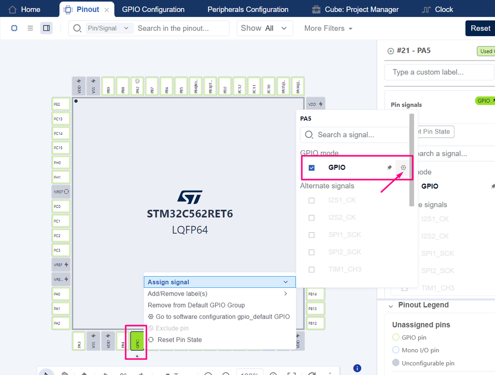

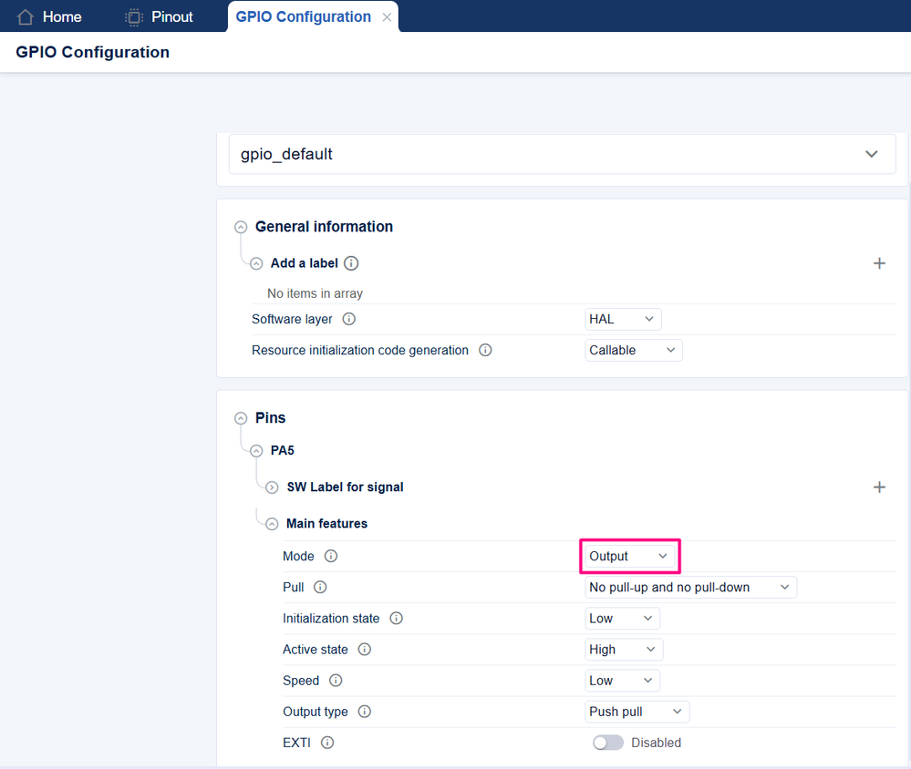

Configure the green LED, available on PA5.

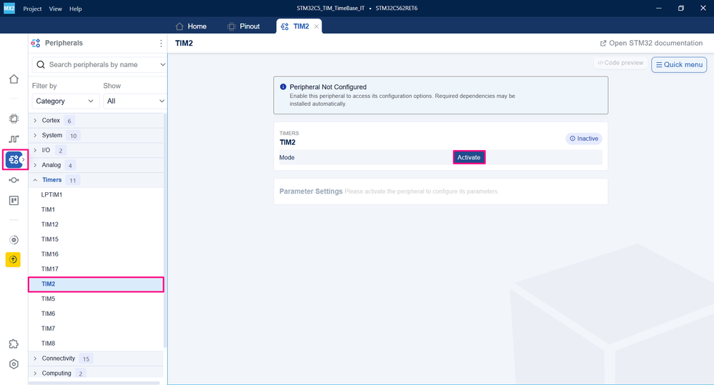

BMontanari_5-1769798930072.pngNavigate to the "Peripherals"section, then "Timers". Enable a general-purpose timer, for example, TIM2, and configure the timer mode for simple time base.

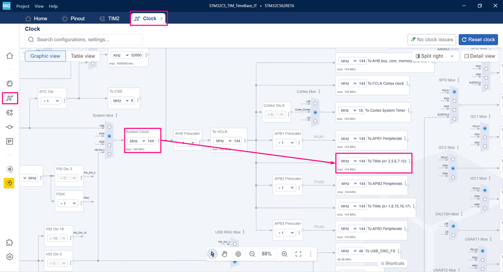

BMontanari_6-1769798930076.pngBefore setting the prescaler and counter period to define the timer frequency and period, configure the clock settings. Click the [Clock] icon and adjust the frequency as needed. For example, set the clock to its maximum of 144 MHz.

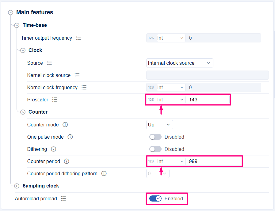

BMontanari_7-1769798930083.pngReturn to TIM and configure the prescaler to achieve a 1 ms time base. Use the standard formula:
Frequency = f_clk / [(PSC + 1) × (ARR + 1)]
Example calculation:
  • Step 1 (Prescaler): 143 + 1 = 144
  • Step 2 (Period): 999 + 1 = 1,000
  • Step 3 (Total Divisor): 144 × 1,000 = 144,000
  • Step 4 (Final Result): 144,000,000 / 144,000 = 1,000 Hz (1 kHz)

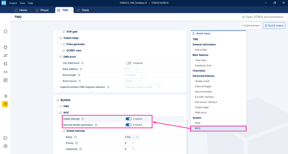

BMontanari_8-1769798930085.png Use the Quick menu to find the NVIC settings. Enable update interrupt to trigger an interrupt on timer overflow.

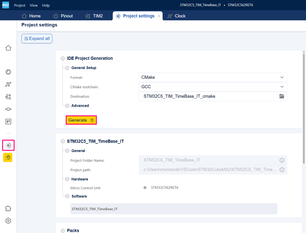

1.3 Code generation
To generate the code:
  1. Click on the [Project settings] icon and select the desired IDE.
  2. Click the Generate button.

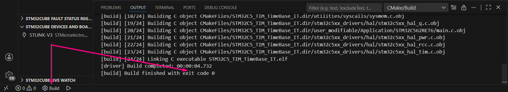

2. Configuring the project in Visual Studio Code
Open Visual Studio Code and open the project folder.
If prompted, select the configuration. If not prompted, press Ctrl+Shift+P, type CMake: Select Configure Preset, and choose the debug configuration.
Build the project to ensure everything is set, then proceed to code implementation.

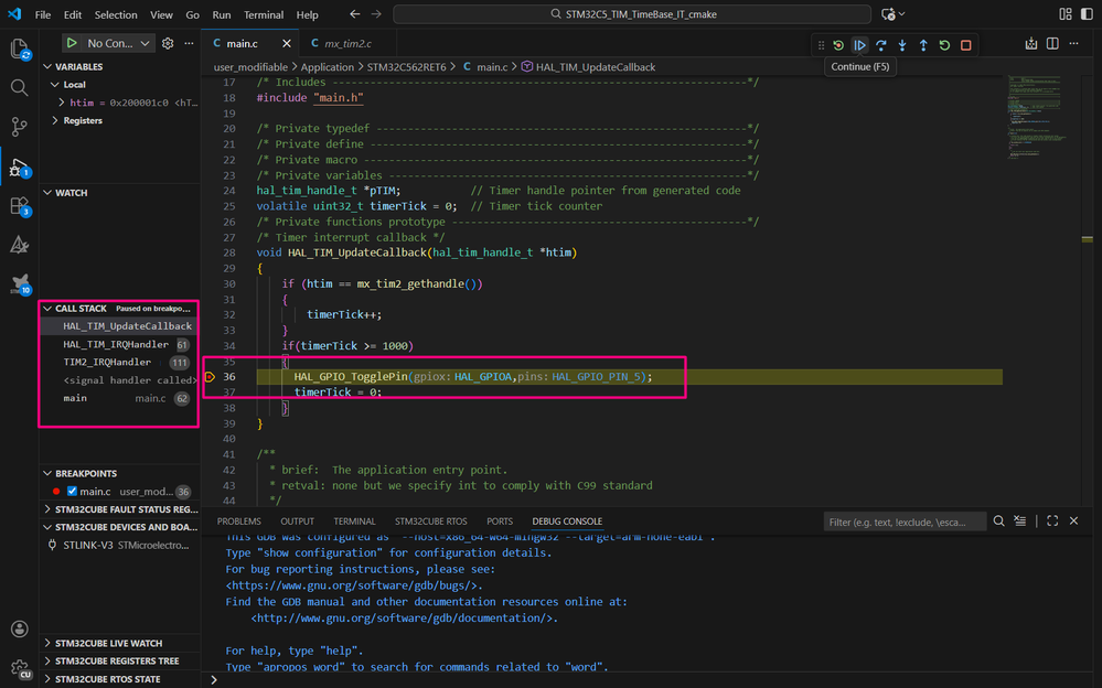

3.1 Validation

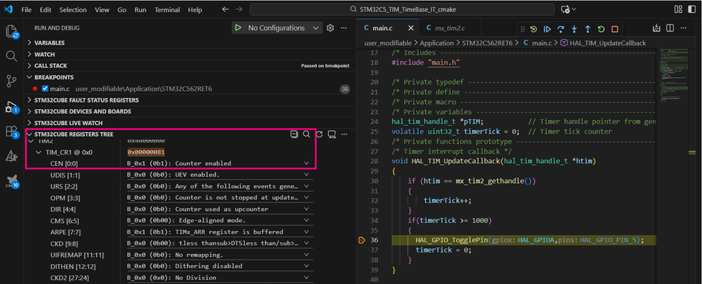

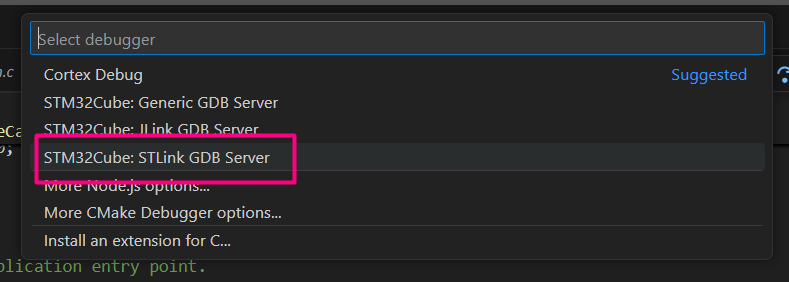

After building the application, locate the [Run and Debug] icon, create your debug session by selecting the [STM32Cube: STLINK GDB Server] option.
Once in debug mode, add a breakpoint in the callback or observe the LED blinking at a 1 second rate.
