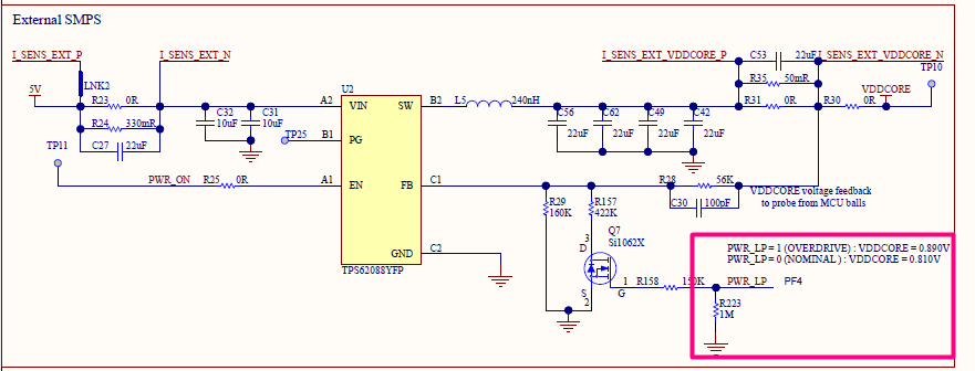

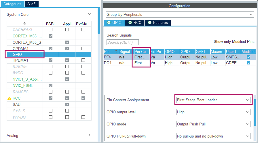

On STM32CubeMX, you need to turn on PF4 (usually turned off by default) to get the VDDCORE to 0.89 V (OVERDRIVE). This is shown in the Discovery kit schematic, on page 5.
Locate the PF4 and configure it as GPIO_Output and use the label to name it SMPS_OVD.
Also, locate the PO1 and configure it as GPIO_Output and use the label to name it GREEN_LED.
We need to assign both GPIOs to be used by the FSBL.

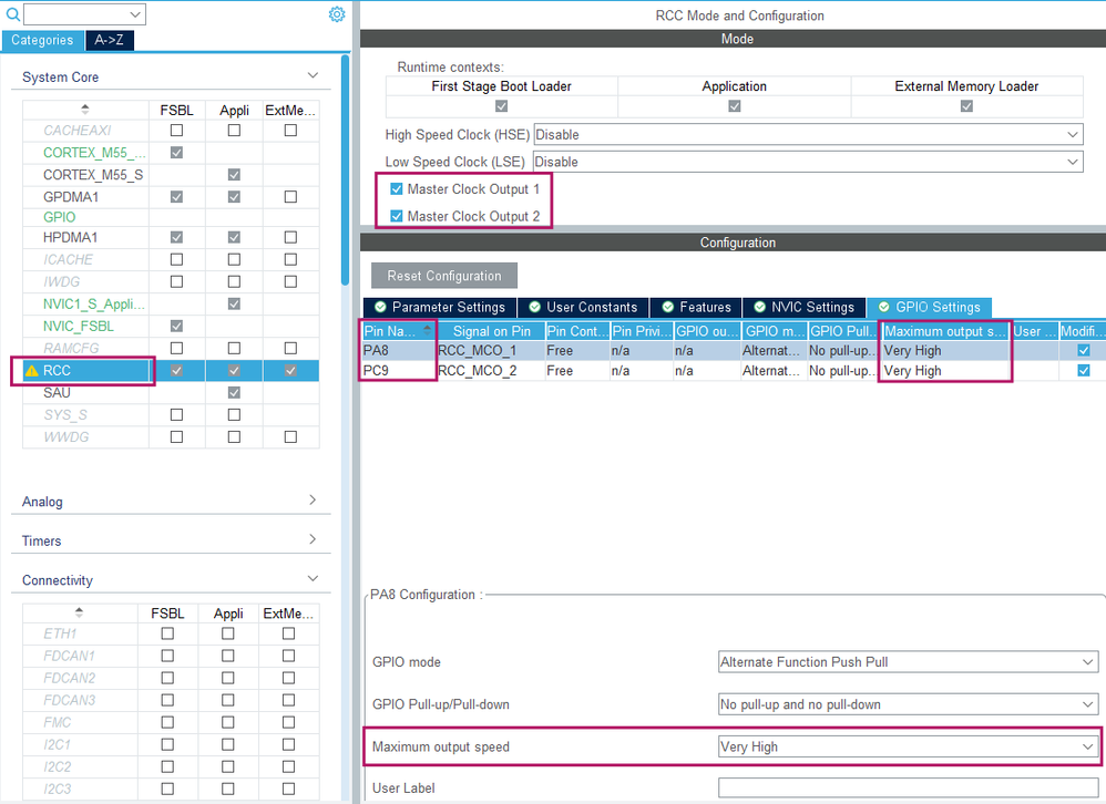

3.2 Configure the RCC and ICACHE

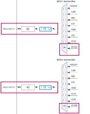

The next step is to configure the RCC by enabling the MCO1 and MCO2 (automatically assigned to PA8 and PC9, respectively). By reproducing this step, we can later confirm the desired frequency output value using an oscilloscope.
Along with that, on the “Clock Configuration” tab, activate the following:

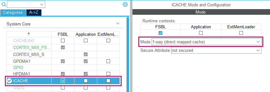

Back to the “Pinout & Configuration” tab, you need to turn on the ICACHE feature to make the most out of the overdrive mode.

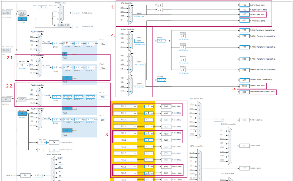

3.3 Clock configuration
Since we already set the VDDCORE to 0.89 V, the next step shows the correct clock tree configuration to have the maximum frequency output on the CPU, NPU, and AXISRAM3/4/5/6.
In STM32CubeMX’s “Clock Configuration” tab, follow according to the image below:

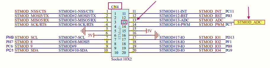

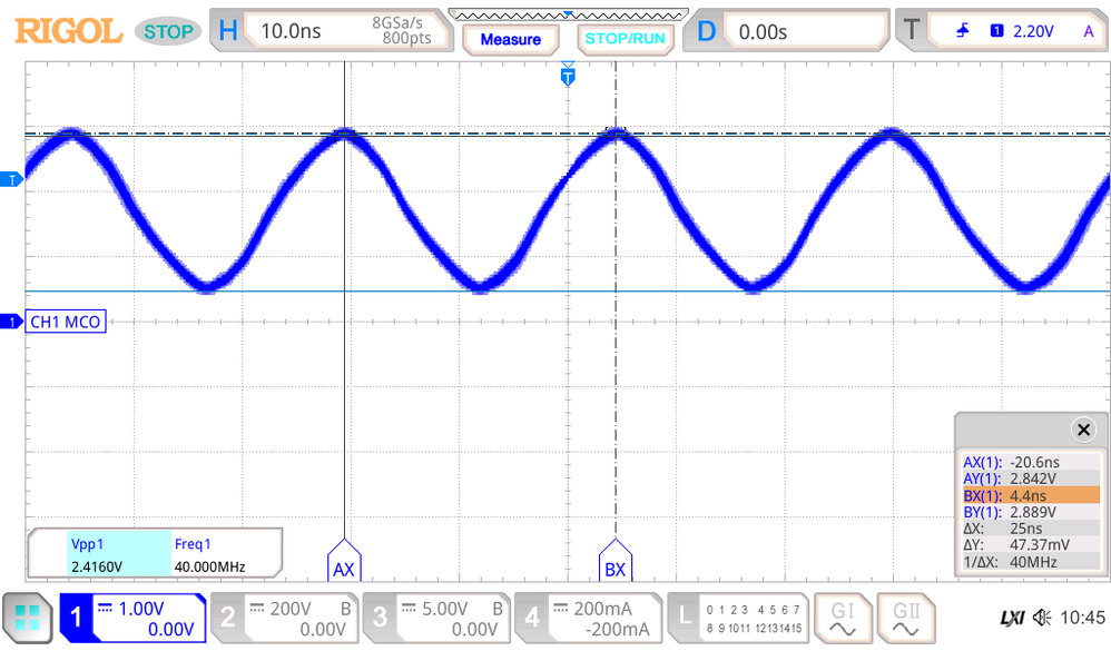

To see your application running, you can use the MCO2 pin configured before. This pin can be found in the CN4 socket, as shown in the Discovery kit schematic (page 10), or at the TP2 and TP3 test points.
Note: During the “STM32CubeMX Configuration” portion of this article, we configured the MCO2 frequency with a /10 divider. This modification allows us to measure the CPU frequency with most scopes precisely.
The final wave should be something like the following:
