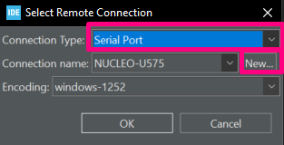

This will pop up a new window, where you can create it, make sure to select “Serial Port” and then click “New”:

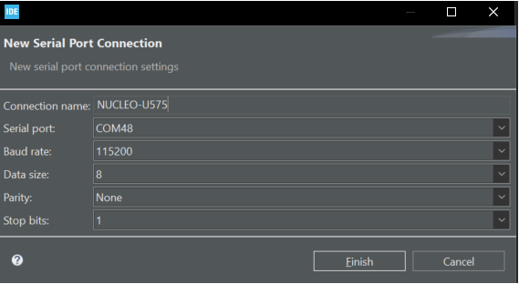

Now it is time to configure the UART parameters:
Once done, click “Finish” and then “OK”

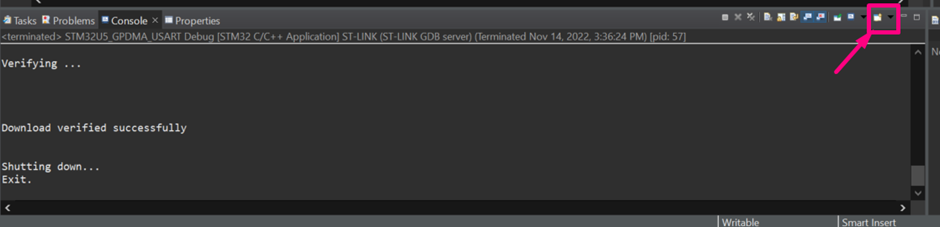

This also works while in debug mode and you can switch the “Console view” by clicking and expanding this icon:
