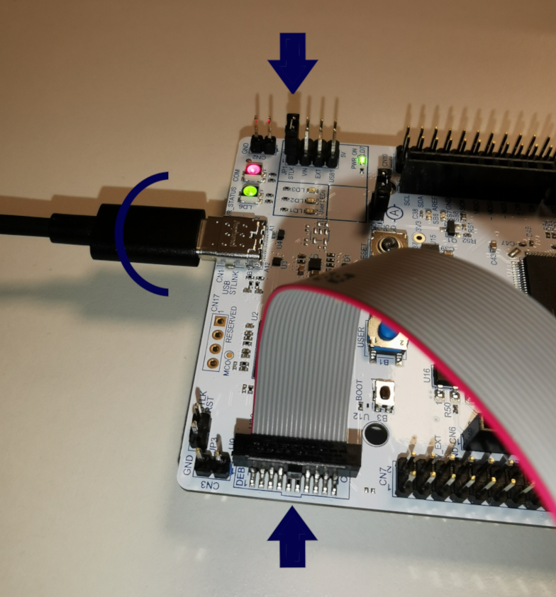

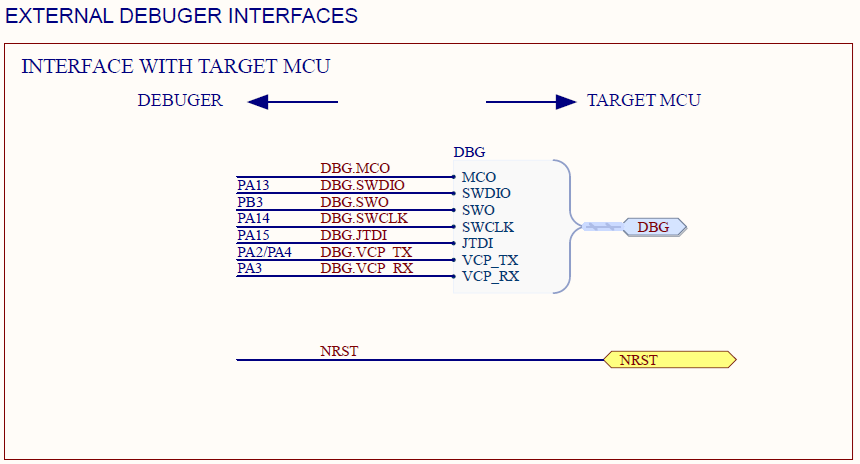

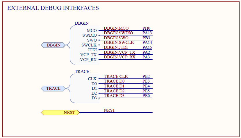

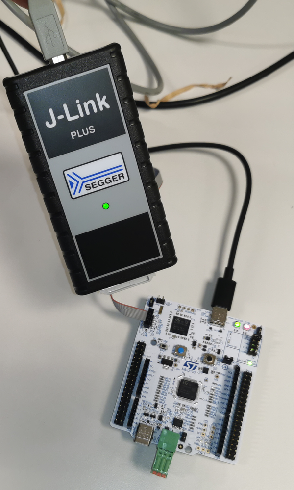

2. Setting up the Nucleo board with the Segger J-Link probe

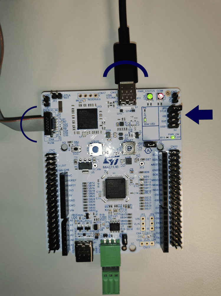

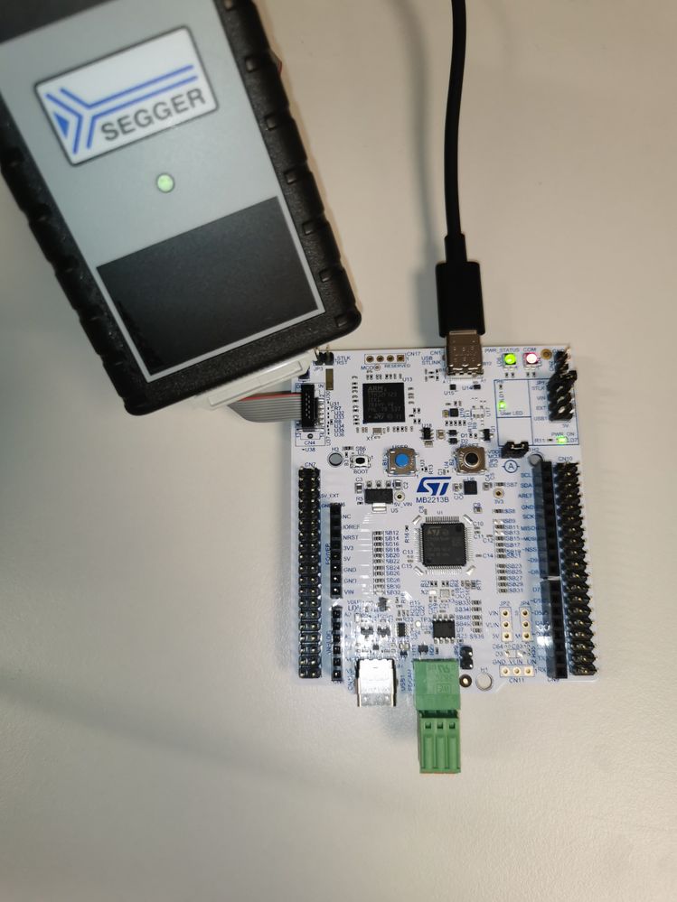

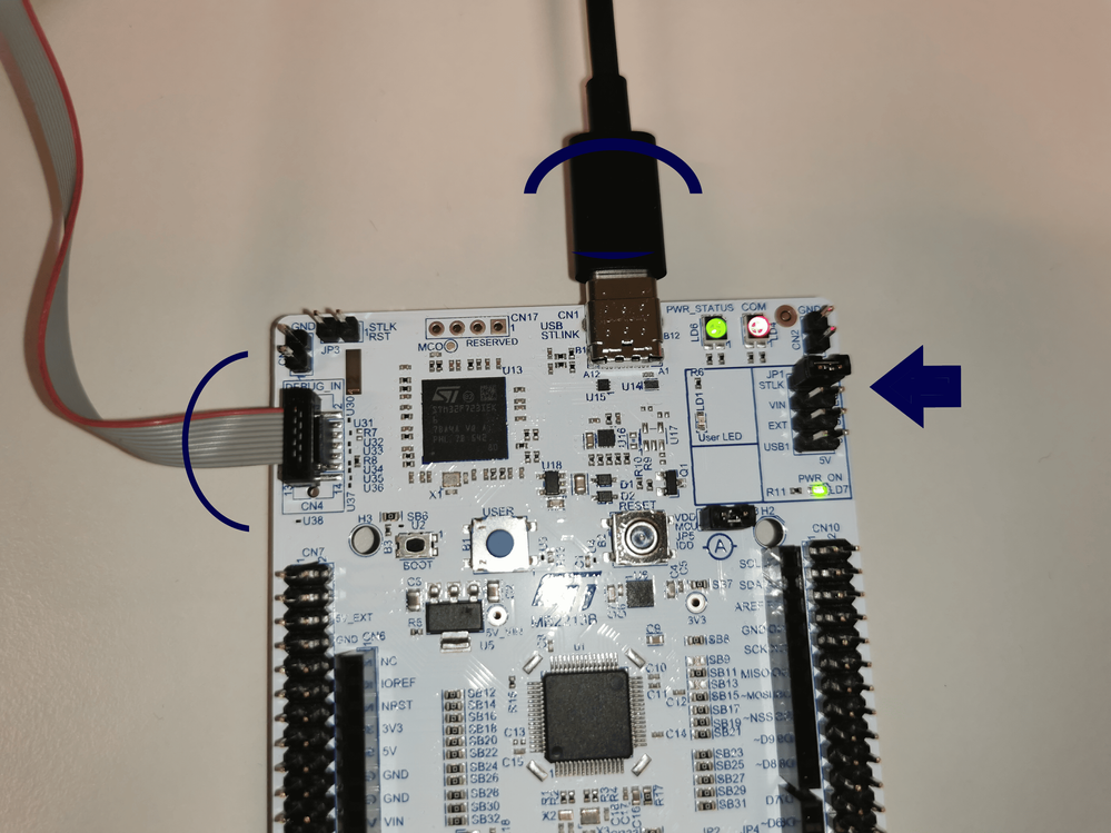

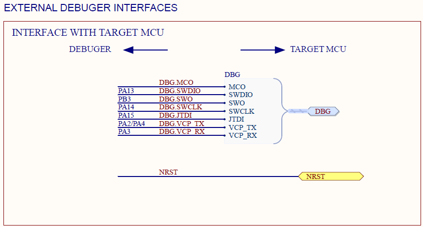

On an STLINK setup, both powering the board and debug signals are provided through the STLINK connector.
On a J-Link setup, that is, with an external probe, the debug signals are available through the "External Debug Interface" of the board. Its power supply remains available through the STLINK interface with the 5V selector jumper set to STLINK.
The next three sections showcase the setup for the following boards:
  • NUCLEO-C542RC
  • NUCLEO-C562RE
  • NUCLEO-C5A3ZG

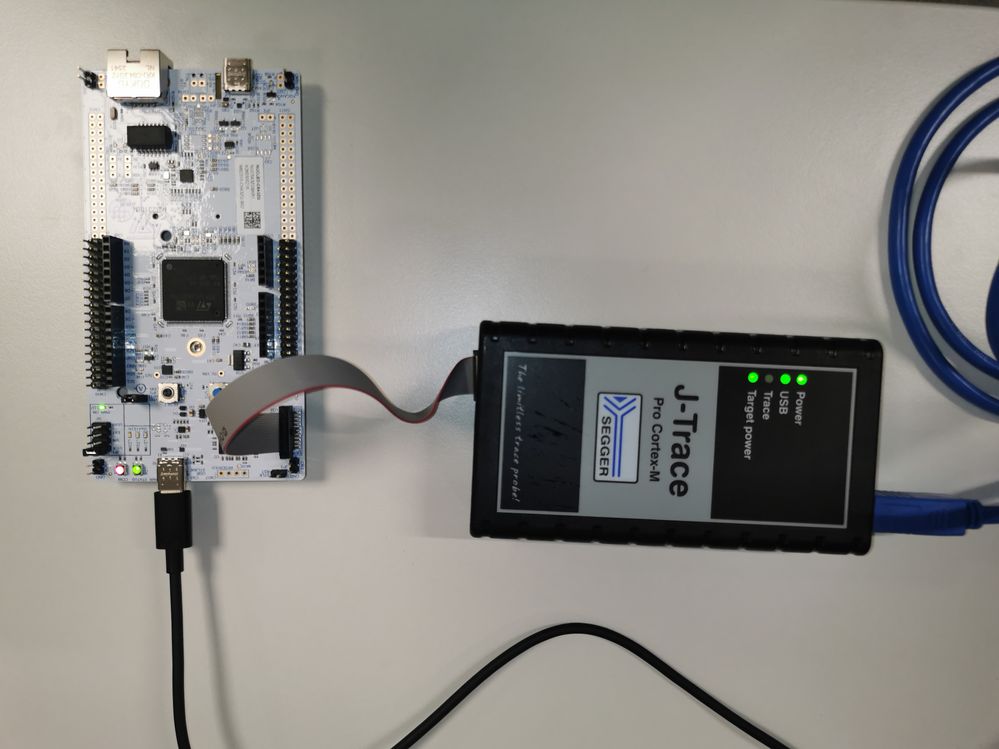

2.1 NUCLEO-C542RC setup
https://www.st.com/resource/en/schematic_pack/mb2213-c542rc-b02-schematic.pdf
2.2 NUCLEO-C562RE setup
https://www.st.com/resource/en/schematic_pack/mb2213-c562re-b02-schematic.pdf
2.3 NUCLEO-C5A3ZG setup
Note: Ensure that the MIPI‑20 ribbon cable is correctly oriented: the keyed notch on the connector must align with the key on the board header. Refer to the arrow at the bottom of the picture.

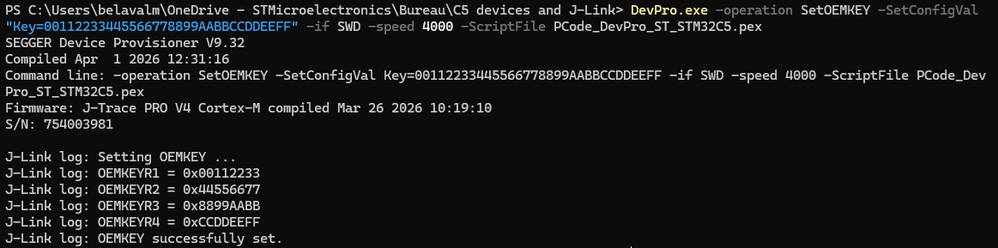

For all STM32C5 devices, the provisioning command to be executed is the same:
DevPro.exe -operation SetOEMKEY -SetConfigVal "Key=00112233445566778899AABBCCDDEEFF" -if SWD -speed 4000 -ScriptFile PCode_DevPro_ST_STM32C5.pex
Log output:

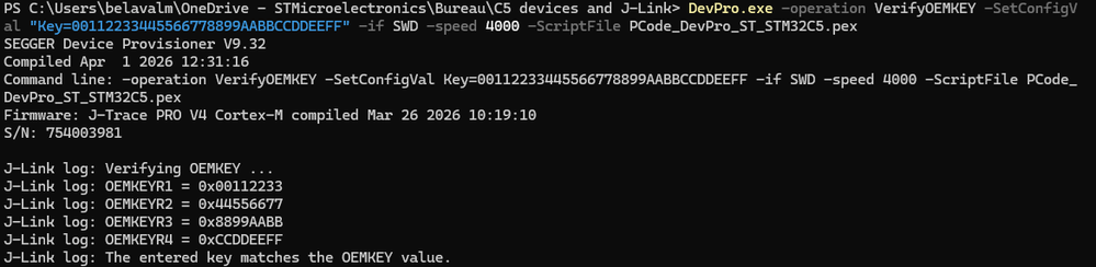

4. Verifying the OEMKEY
For all STM32C5 devices, the verify command to be executed is the same:
DevPro.exe -operation VerifyOEMKEY -SetConfigVal "Key=00112233445566778899AABBCCDDEEFF" -if SWD -speed 4000 -ScriptFile PCode_DevPro_ST_STM32C5.pex
Log output if successful:

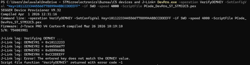

Log output if the key is not the one provisioned:

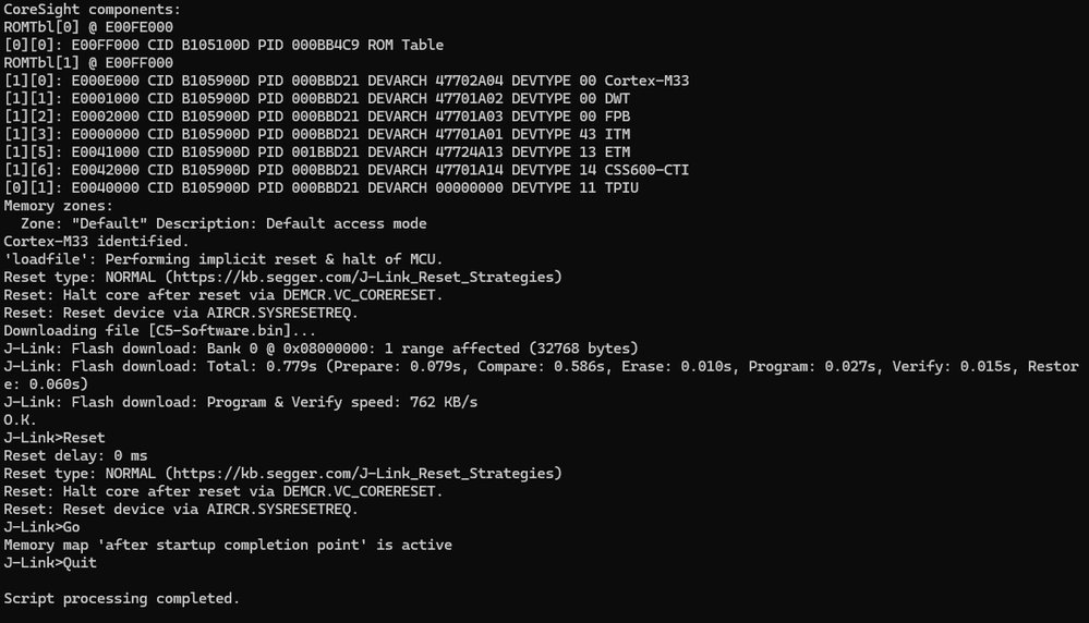

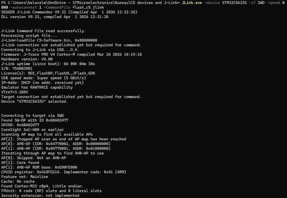

5. Programming the binary image
To program our binary image, we use a .jlink file, named “flash_c5.jlink” that contains all the information needed by J-Link Commander.
The content of this file is:
loadfile C5-Software.bin, 0x08000000
Reset
Go
Exit
The available options are all here: https://kb.segger.com/J-Link_Commander#Commands
  • Reset performs a reset of the CPU.
  • Go starts the CPU if it was halted.
  • Exit closes the J-Link connection, allowing us to execute the next command.
5.1 Programming the NUCLEO-C542RC
Execute the following command:
JLink.exe -device STM32C542RC -if SWD -speed 4000 -autoconnect 1 -CommandFile flash_c5.jlink
5.2 Programming the NUCLEO-C562RE
JLink.exe -device STM32C562RE -if SWD -speed 4000 -autoconnect 1 -CommandFile flash_c5.jlink
5.3 Programming the NUCLEO-C5A3ZG
JLink.exe -device STM32C5A3ZG -if SWD -speed 4000 -autoconnect 1 -CommandFile flash_c5.jlink
Log output:

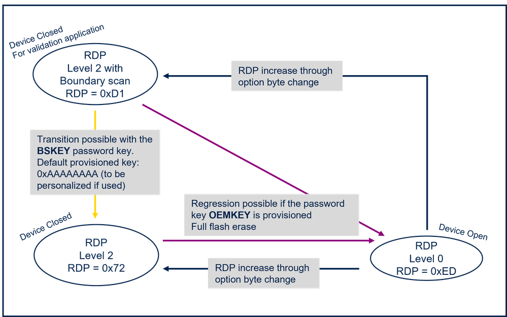

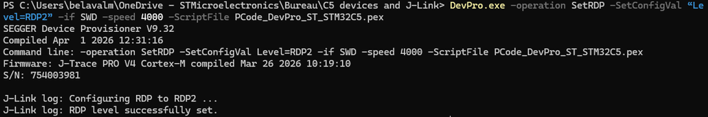

6. Closing the chip: transition from RDP level 0 to RDP level 2
For all STM32C5 devices, the lock command to be executed to set the RDP level to 2 is the same:
DevPro.exe -operation SetRDP -SetConfigVal “Level=RDP2” -if SWD -speed 4000 -ScriptFile PCode_DevPro_ST_STM32C5.pex
Important note:
  • If the RDP level 2 is set without provisioning the OEMKEY, the device remains locked in the RDP level 2 state.
  • It is impossible to retrieve the regression OEMKEY in RDP level 2, so make sure to store this key safely and do not lose it.
Log output:

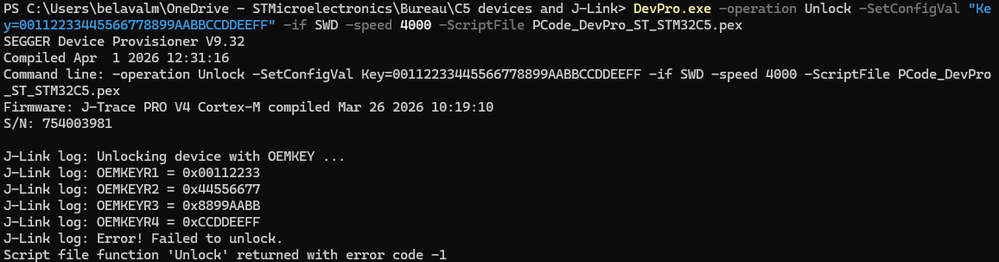

7. Performing the regression from RDP level 2 to RDP level 0
In this article, the key used is: 00112233445566778899AABBCCDDEEFF.

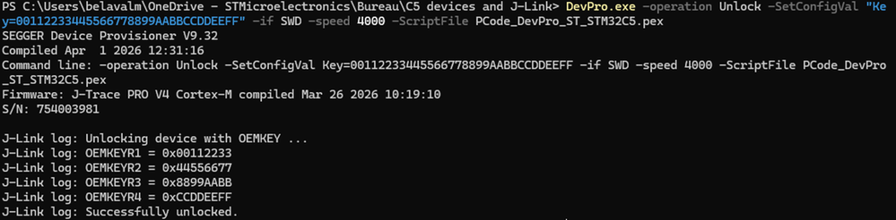

For all STM32C5 devices, the unlock command to be executed to perform the RDP regression from Level 2 to Level 0 is the same:
DevPro.exe -operation Unlock -SetConfigVal "Key=00112233445566778899AABBCCDDEEFF" -if SWD -speed 4000 -ScriptFile PCode_DevPro_ST_STM32C5.pex
Important note:
  • The regression performs a mass erase of the chip.
  • After closing the chip, before executing the Unlock command, you must perform a power-off/power-on cycle to ensure that the regression completes successfully.
Log output when successful:
Log output when the key is correct but a power-off / power-on cycle is missing:
