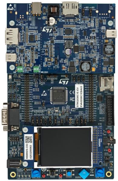

    • STM32G0C1E-EV Evaluation board

The ST Open Bootloader is part of the STM32Cube Library package. This example uses the STM32G0C1 eval board and the Open Bootloader can be found here:
STM32Cube_FW_G0_Vx.x.x\Projects\STM32G0C1E-EV\Applications\OpenBootloader

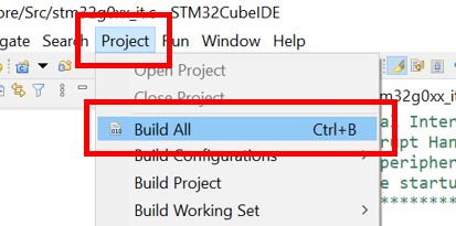

  1. Build the project, enter debug mode and run the code

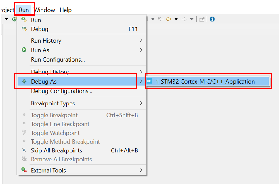

Enter Debug session: this programs the code into the flash and then starts the debug session
Exit the Debug Session by terminating it.

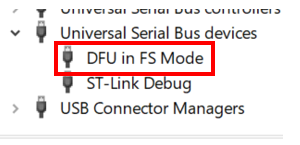

Plug in the USB Type C cable to the CN7 daughter board that is connected to the STM32G0 mother board. The USB host will begin communications enumerating the board as a USB DFU Device as confirmed in the Device Manager:

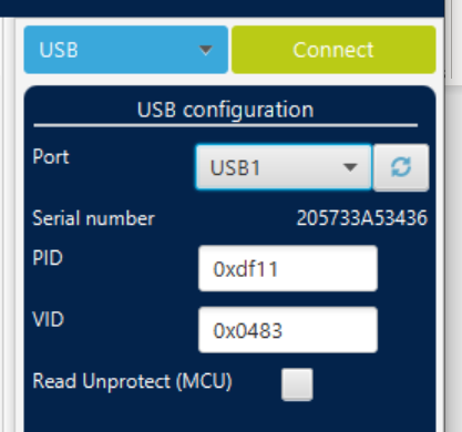

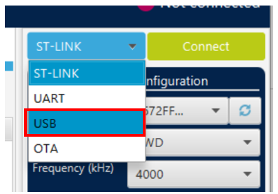

Open STM32CubeProgammer and select the USB Interface in the STM32CubeProgrammer to establish the connection through USB:
Confirm the USB connection is established as shown below. If it is not, click on the refresh button 1918.png:
Now, connect by clicking on the Connect button:

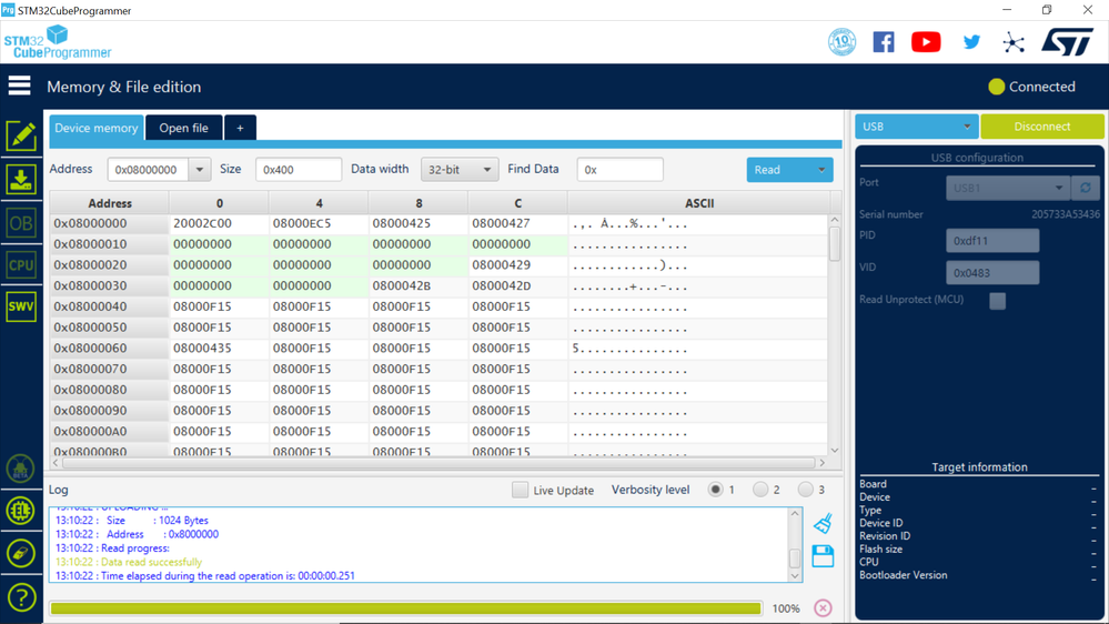

Once the connection is made, the content of the flash will be displayed as shown below:
While the flash can now be read, erased or written, the primary objective is to upload a new application image into the STM32G0.

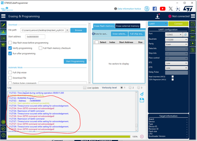

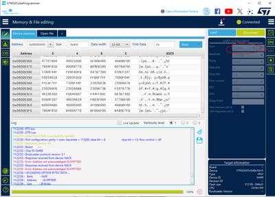

Hello @ST AME Support NF , @Laurids_PETERSEN ,
I have tried the tutorial of youtube video from the links of
https://github.com/STMicroelectronics/stm32wl-openbl-apps
with a stm32g474 eval board.

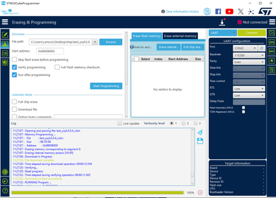

I can get connected with a uart1 (a usb-uart bridge) to the board from stm32 programmer as below
and i prepared an APP program and set the flash address to 0x8008000.
then I use stm32 programmer to download the APP bin file to 0x8008000.
it can be downloaded but can not run exactly as below.
after I reset the board, the program start from 0x08000000, it can not start from 0x08008000.
so what is the problem?
Thanks.
