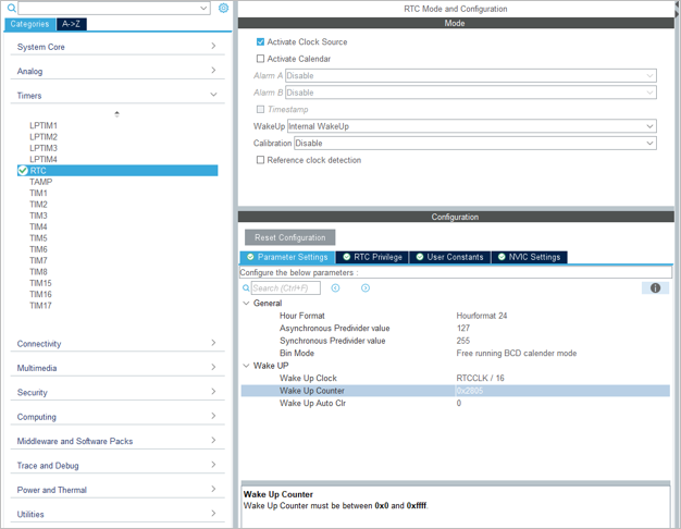

4.1. RTC Configuration
For this example, we’ll configure the RTC to wake-up the system every 5 seconds, and calculate the elapsed time.
Start a new project in STM32CubeMX, choosing the NUCLEO-U575ZI-Q in the board selector.
To activate the RTC, in the timers tab, configure the RTC clock source as follows:
  • Click [Activate Clock Source]
  • In [WakeUp], select [Internal WakeUp], as we won’t be using an external pin as a wake-up signal
RTC configurationRTC configuration
The RTC (real-time clock) in STM32 microcontrollers requires a 1 Hz clock to keep accurate time. Its clock source derives from various sources such as LSE (Low-Speed external), LSI (Low-Speed internal), or HSE (High-Speed external) divided by 32. The prescalers are used to divide the input clock down to 1 Hz.
In this example, we use the internal LSI clock as the RTC clock source. Considering the LSI oscillator, which runs at 32,768 Hz, to achieve a 1 Hz clock for the RTC, we need to divide the 32 kHz clock to 1.
So, in the parameters settings tab, set:
The asynchronous prescaler to 127 (to divide the input clock by 128 (127+1)): It helps balance power consumption and the accuracy of the RTC.
The synchronous prescaler to 255 (to divide the input clock by 256 (255+1)): It’s necessary for accurate timekeeping.
For the wake-up configuration, we have three parameters:
Wake-up clock: Determines the interval after which the wake-up timer interrupt is generated.
Wake-up counter: Determines the frequency at which the wake-up counter is decremented.
Wake-up auto clr: Automatically clears the wake-up timer counter after the wake-up event.
For this example, the RTC clock is divided by 16, the wake-up counter is set to 0x2805, and the wake-up auto clr is set to 0.
The value of the wake-up counter is calculated accordingly to achieve the 5 second wake-up interval.
  • Enable the RTC interrupt
RTC Interrupt EnableRTC Interrupt Enable

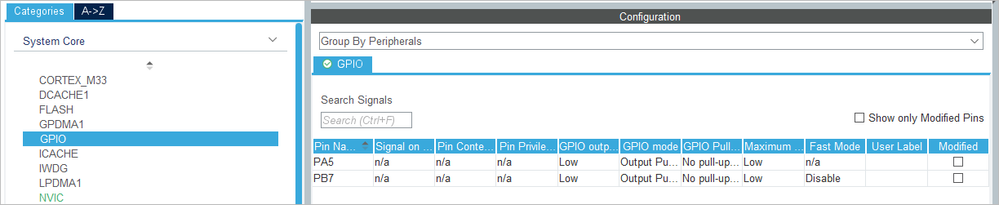

4.2. GPIO configuration
In this example, we'll be using an LED (PA5) to indicate the wake-up event and another LED to indicate an error (PB7). Configure these pins in the GPIO configuration.
  • GPIO configurationGPIO configurationGenerate the code
