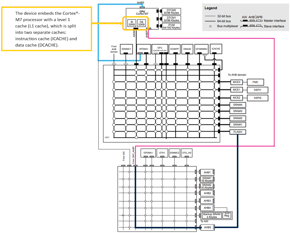

High-performance STM32 MCUs, which includes STM32F7, STM32H7, STM32N6, offer substantial performance gains, largely attributed to their integrated level 1 (L1) ICACHE and DCACHE. These caches minimize memory latency by storing frequently used instruction and data close to the CPU. However, this performance enhancement introduces a critical challenge known as cache coherency, especially in systems where multiple bus masters, such as the CPU and DMA controllers, access the same memory regions.
Figure 1. STM32H7Rx/7Sx system architecture, AN6062Figure 1. STM32H7Rx/7Sx system architecture, AN6062
1. Understanding cache and the coherency problem
  • Instruction cache (ICACHE): Stores recently fetched instructions. Speeds up code execution, especially loops.
  • Data cache (DCACHE): Stores recently accessed data. Accelerates data reads and writes. STM32 typically uses a write-back policy by default for cached SRAM, meaning writes might only update the cache initially, not the underlying RAM immediately.
