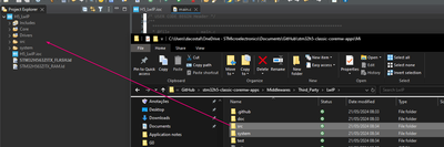

Start by downloading the stm32h5-classic-coremw package available on the GitHub link here, or at the beginning of the article. Make sure to perform a Git Clone, otherwise the required files are not downloaded.
Unzip the cloned file and move to the following folder ..\stm32h5-classic-coremw-apps\Middlewares\Third_Party\LwIP. [Ctrl + left click] to select both the “src” and “system” folders, then drag and drop it to your newly created project, as illustrated below:
Figure 6 - Add LwIP step 1Figure 6 - Add LwIP step 1

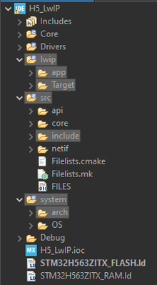

As none of the Ethernet protocols are used for this simple demonstration, we should delete the ‘src/apps’ folder before proceeding.
Create a new source folder called ‘lwip’, and inside it create normal folders named ‘app’ and ‘target’. These are going to be the user code folders for the middleware, maintaining a similar folder structure provided in our other series for the LwIP.
Figure 9 - Add LwIP step 4Figure 9 - Add LwIP step 4
The application files must be imported from the stm32h5-classic-coremw package. Following this path ..\stm32h5-classic-coremw-apps-main\Projects\NUCLEO-H563ZI\Applications\LwIP\LwIP_TCP_Echo_Server\LWIP\Target, import all the ‘target’ folder files to the ‘target’ folder in your project. In the “app” folder, create lwip.c and lwip.h files.
Figure 10 - Add LwIP step 5Figure 10 - Add LwIP step 5

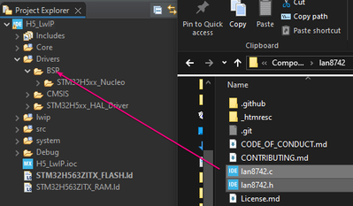

Finally, from ..\stm32h5-classic-coremw-apps-main\Drivers\BSP\Components\lan8742 path, import both lan8742.c and lan8742.h to the “BSP” folder.
Figure 11 - Add LwIP step 6Figure 11 - Add LwIP step 6
The next step is to add all header files to the include path. Select the highlighted folders using [Ctrl + left click], then [right click] any of them and select “add/remove from include path”. Press [OK] on the pop-up tab.
Figure 12 - Add LwIP step 7Figure 12 - Add LwIP step 7

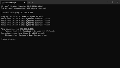

To make sure the board is connected and working, you can open the cmd.exe or similar and issue a ping command, as illustrated below:
Figure 14 - Optional CommandFigure 14 - Optional Command

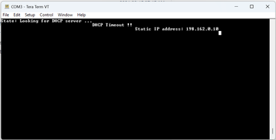

Hi
I get static IP : from print : Static IP address: 198.162.0.1
What I miss?

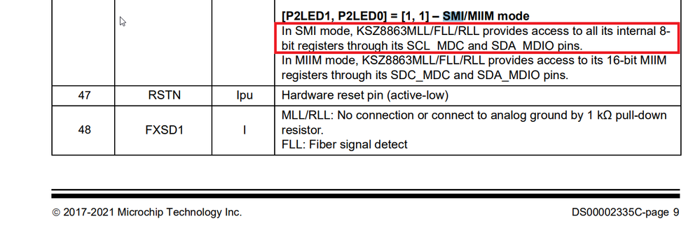

I would also be interested in something similar as @Peter3718, i'm trying to interface with the KSZ8863 PHY. CubeMX generates the MDC and MDIO pins no option to disable them. Any suggestions how to implement the settings of the phy by I2C trough the H5?
Thank you in advance.

The KSZ8863 has an SMI interface, see here:
I am using a single pair Ethernet switch with an integrated virtual PHY from microchip and it works great together with the STM32 MAC.
Regards,

I'm having access to all the registers trough I2C, I need to configure register 198[3] to set the correct clock mode [5] of the KSZ8863. Switch functionality works. But now I'm facing the challenge on how to change the STM32 LAN8742 driver to use I2C to setup the KSZ8863? Which is normally done automatically by Cube by generating the MDIO and MDC pins in combination with the LAN8742 driver?. Or am I missing something?
Any advice would be super helpful.

I dove into the LAN8742.c file a few hours ago, and noticed (as you where saying) its a simple interface. I just did the setup of the KSZ8863 trough I2C and commented most part of the LAN8742_Init MIIM (MDC/MDIO) stuff out. And set the status to LAN8742_STATUS_OK.
After this it initializes correctly and I'm able to ping.

In LAN8742.c, there is a code to read REG then decide PHY address. I think you need to change these code, otherwise wrong VPHY address will be set.

I am using the H563 and the H573. In the driver lan8742.c the first think done is to search the PHY using the special mode register. Maybe this fails, but I have set the MDIO address to 0 of the LAN9373, so zero it is the right one :)

I don't understand why you need any I2C. As I told you the KSZ8863 can be connected to the MDIO.

@Peter3718My HW connection is good so RMII is always connected to the controller, I always let it return the 100MBITS FULLDUPLEX status. If I need more I port it to I2C.
@RomThiTrue, but I need I2C to setup Clock Mode 5 (enable bit 198[3]) and need to access some more settings which are only accessible over I2C.
