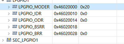

Gautham19
Associate II
Hello @Sarra.S ,
I have configured LPGPIO_PIN_5 as output it is updated in LPGPIO1->MODER, but during run time the LPGPIO1->ODR, LPGPIO1->BSRR, LPGPIO1->BRR is not  getting updated.
