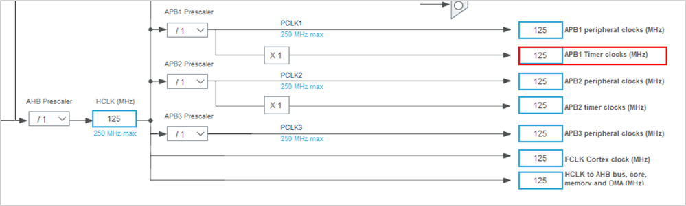

Step 1: Configure the clock
In this example, the HCLK clock is set to 125MHz. Timer2 is connected to APB1 (always refer to the block diagram in the datasheet to check the timer clock).
Clock configurationClock configuration

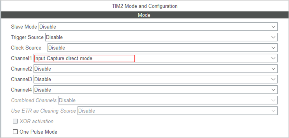

  • Select TIM2 and choose Input capture direct mode for Channel 1.
Choose input capture modeChoose input capture mode

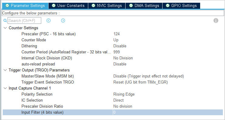

  • Set the Prescaler to adjust the timer clock frequency.
  • Set the Counter Mode to Up.
  • Set the Period value.
  • In the Channel 1 settings, set the IC Polarity to Rising (or Falling depending on your requirement).
  • Set the IC Selection to Direct.
  • Set the IC Prescaler to No division.
  • Set the IC Filter to 0 (or adjust as needed to filter noise).
TIM2 configurationTIM2 configuration
The formula below determines the timer's counter clock frequency (CK_CNT):
CK_CNT= HCLK / (PSC+1)
Where:
  • HCLK is the system clock frequency (125 MHz in this case).
  • PSC is the prescaler value.
The timer period is determined by the auto-reload register (ARR) value and the counter clock frequency, the formula is:
Period = (ARR+1) * (1/ CK_CNT)
Where:
  • ARR is the auto-reload register value.
  • CK_CNT is the counter clock frequency.
For a desired period of 1 ms for example, and CK_CNT=1MHz, we can choose PSC=124, this divides the clock by 125. Using the period formula, ARR=1000-1 =999
