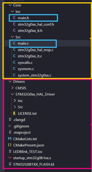

1.1 HAL1
On the HAL1 side:
The yellow block is the Core folder:
  • Core/Inc with headers such as:
    • main.h
    • stm32zyxx_hal_conf.h
    • stm32zyxx_it.h
  • Core/Src with sources such as:
    • main.c
    • stm32zyxx_hal_msp.c
    • stm32zyxx_it.c
    • syscalls.c, sysmem.c
    • system_stm32zyxx.c
The pink block is the Drivers folder:
    • Drivers/CMSIS/...
    • Drivers/STM32ZYxx_HAL_Driver/Inc
    • Drivers/STM32ZYxx_HAL_Driver/Src
In this layout, main.c is in Core/Src, mixed in with all the other generated files. The HAL drivers are "project local" inside Drivers and there is no explicit separation between:
    • generator‑owned code,
    • device/driver packages,
    • user‑owned code.
The tool typically regenerates the contents of Core, including main.c and stm32zyxx_it.c, and you rely on /* USER CODE */ regions inside these files.

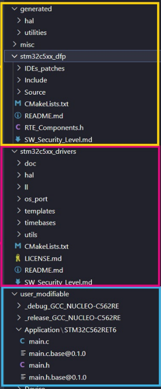

On the HAL2 side, the project is split into three clear layers.
Generated layer and DFP (yellow box)
The yellow box covers a top‑level generated directory (with hal, utilities, misc, etc.) and the stm32c5xx_dfp directory.
This is the generator + Device Family Pack layer:
  • generated/ contains code produced from your configuration:
    • HAL init and setup code (mx_... sources, helper utilities).
  • stm32c5xx_dfp/ (name is family‑specific) contains the DFP:
    • Include/ and Source/ with device headers and startup.
    • CMakeLists.txt and RTE_Components.h.
    • IDE patches and metadata.

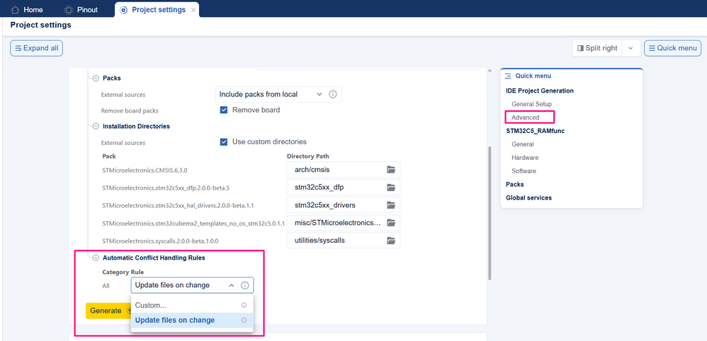

This area is considered tool‑owned: STM32CubeMX2 can regenerate or update it without touching your application logic. There is an option to show the difference when regenerating the code.
In the "Project settings" tab of STM32CubeMX2, click [Advanced] and specify the Category Rule for the generation.
HAL driver package (pink box)
The pink box surrounds stm32c5xx_drivers:
  • Inside you see:
    • hal/, ll/
    • os_port/, timebases/, templates/, utils/
    • CMakeLists.txt, LICENSE.md, README.md
This is the HAL2 driver pack for the family, separated from the project itself:
  • It behaves like a package that your project uses.
  • It is not meant for per‑project editing.
  • It can be shared across different projects targeting the same family.
This is roughly the evolution of what used to be Drivers/STM32ZYxx_HAL_Driver in HAL1, but now clearly packaged and versioned.
User‑modifiable application code (blue box)
The blue box is where the biggest conceptual change shows up. It contains a user_modifiable directory.
  • Build directories (_debug_GCC_NUCLEO..., _release_GCC_NUCLEO...).
  • The Application\STM32C5xx... folder.
  • Crucially, several versions of main.c:
    • main.c
    • main.base@0.1.0
    • main.h
    • main.base@0.1.0.h
This area is explicitly marked as user_modifiable:
  • main.c here is your file.
  • The main.base@... versions are backing copies / templates created by the tools to help with migration or comparison, but not where you build your logic.
  • When you edit application code, you do it in:
    • user_modifiable/main.c
    • Any other sources that you add under the user area.

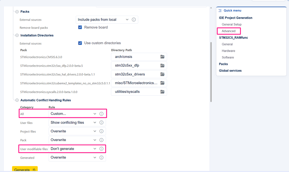

To prevent an overwrite in the main.c file, it is recommended changing the category rule to [Custom]. Set "User Modifiable files" to [Don’t generate] or [Backup].
The important difference from HAL1 is that main.c is no longer buried inside a generator‑owned Core/Src tree. Instead, it sits in a separate, clearly labeled user area, and the HAL2 tooling is designed not to overwrite this file on regeneration.

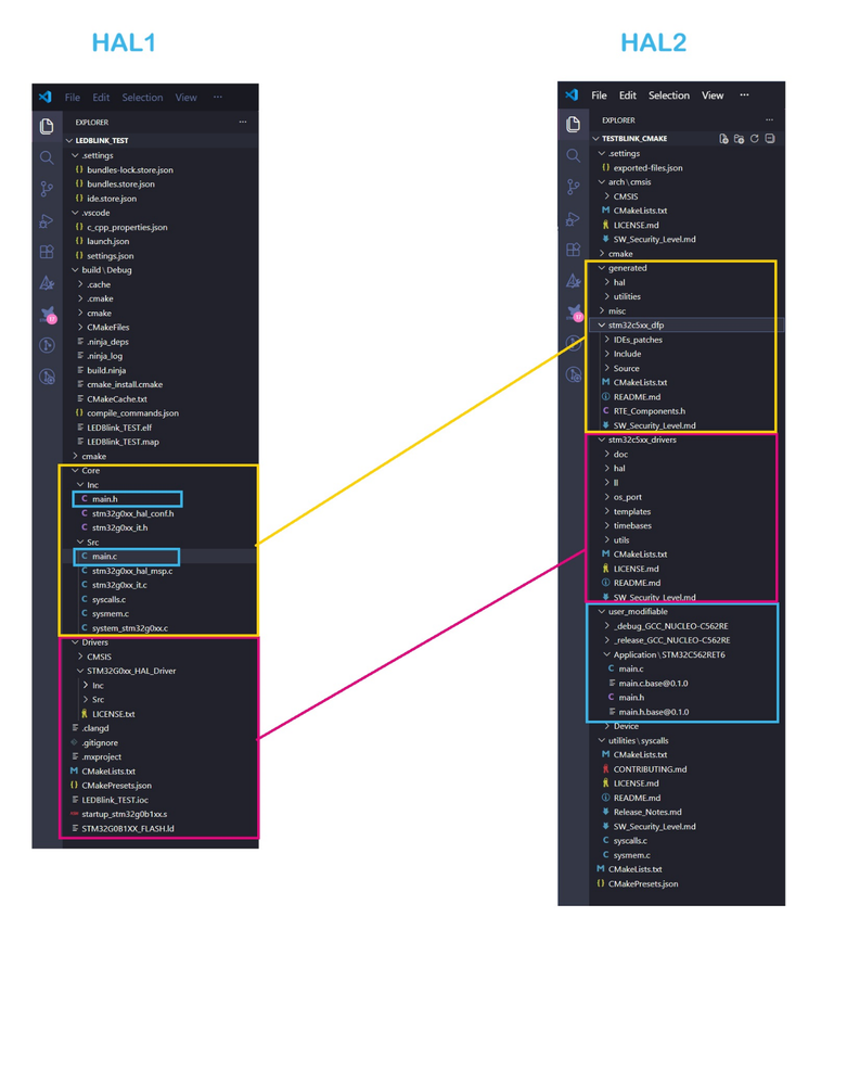

1.3 Comparison between HAL1 and HAL2
HAL1
  • Project code, generated code, and user modifications are all intertwined under Core and Drivers.
  • main.c is generated and regenerated, with user code living in USER CODE markers.
  • The HAL driver code is “just another folder” under Drivers.
HAL2
  • The tree is split into three clean layers:
  1. generated + stm32c5xx_dfp: configuration‑dependent, generator‑owned code.
  2. stm32c5xx_drivers: the HAL2/LL driver package for that family.
  3. user_modifiable: the application layer, including main.c, which is treated as user code.
  • Regeneration focuses on generated and package metadata; your user_modifiable sources are preserved.
  • It is immediately apparent from the VS Code explorer which folders are intended for modification and which should remain unchanged.
In short, the image shows how HAL2 turns what used to be a single mixed project tree (HAL1) into a layered structure: device package, generated HAL, and a clearly isolated, user‑owned application area with main.c at its core.
