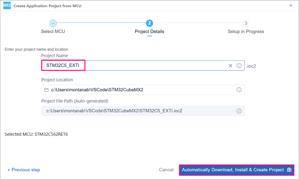

Open STM32CubeMX2. On the Home page, click the MCU square to create a new project.
In the search field under MCU name, enter STM32C562RE and select the MCU. Click [Continue].
Enter the project name and location. Click [Automatically Download, Install & Create Project] to finish project creation.
Select [Launch Project] to start.

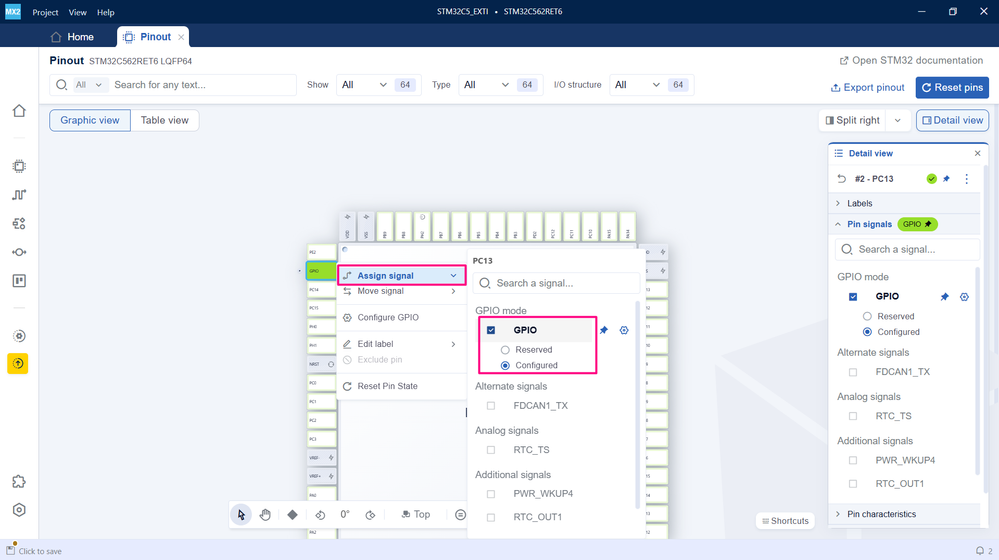

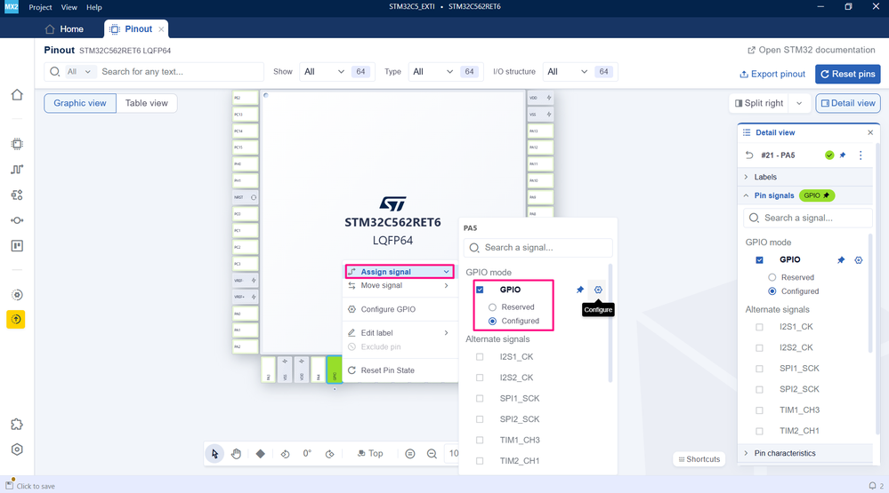

  1. In the Pinout view, click the [PA5] pin. In the menu, hover over [Assign Signal] to reveal additional options. In the GPIO mode section, check the box for [GPIO], and select [Configured].
  1. Right-click the [PC13] pin and repeat the previous step.

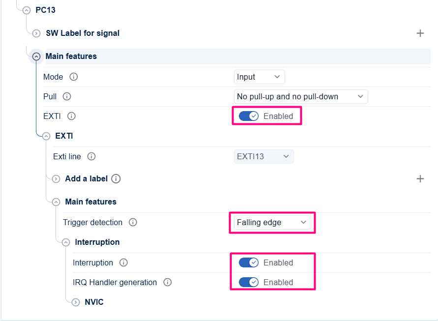

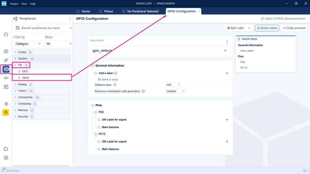

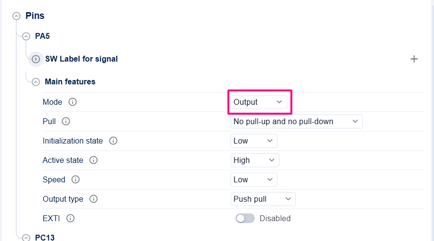

  1. In the GPIO Settings, select the Pins drop-down menu. Configure the main features for each selected pin.
  • Select [PA5]. In the "Main features" tab, set "Mode" to [Output].
  • Select [PC13]. In the "Main features tab", set "Mode" to [Input]. In  "EXTI" → "Exti line" → "Main features" section, set "Trigger Detection" to [Falling Edge]. In the "Interruption" tab, enable [Enabled interruption] and [IRQ Handler Generation].

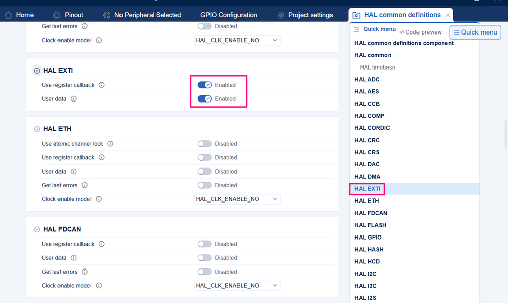

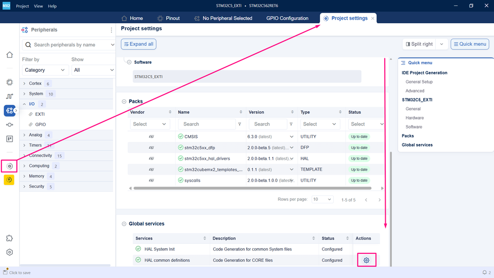

  1. Select the "Project settings" icon. In the HAL common definitions section, under HAL EXTI configuration, enable [Use Register Callback] and [User Data]. This configuration allows generation of the EXTI files.

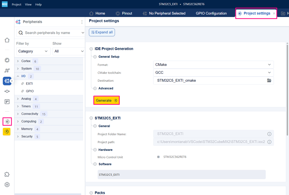

  1. Click on the [Project settings] icon and select the desired IDE.
  2. Click the [Generate] button.

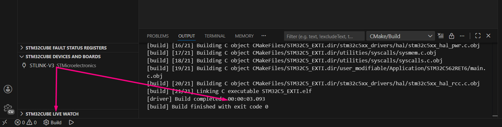

2. Configuring the project in Visual Studio Code
Open Visual Studio Code and open the project folder.
If prompted, select the configuration. If not prompted, press Ctrl+Shift+P, type CMake: Select Configure Preset, and choose the debug configuration.
Build the project to ensure everything is set, then proceed to code implementation.

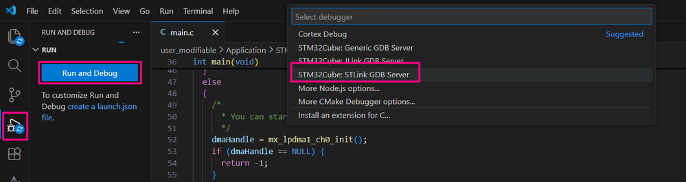

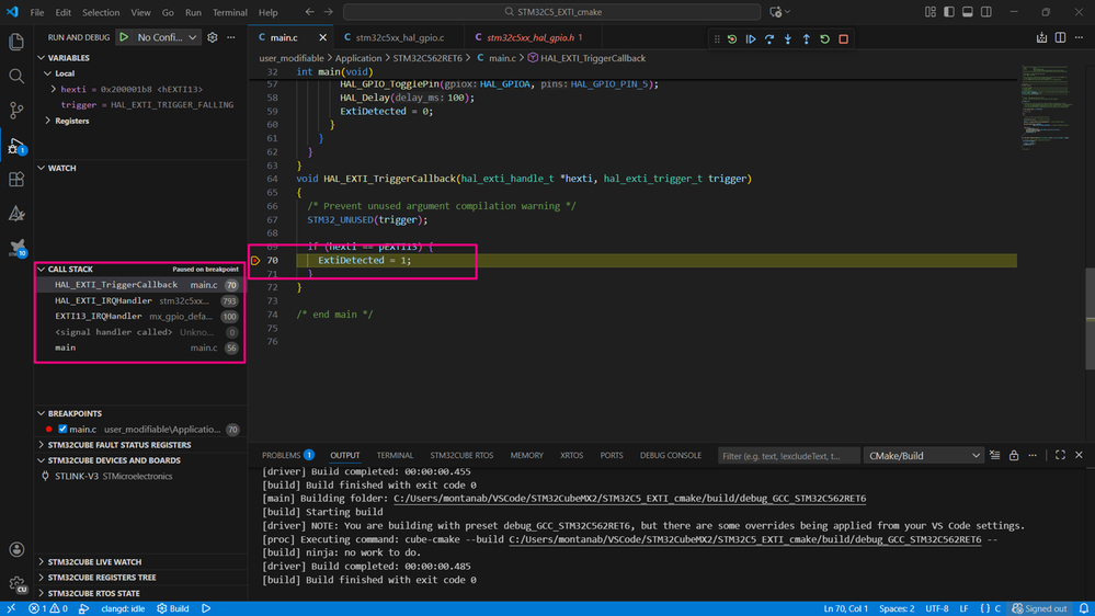

After building the application, select the [Run and Debug] icon. Create a debug session by selecting the [STM32Cube: STLINK GDB Server] option.
The USER_LED is off at the beginning of program execution. Pressing the USER_BUTTON toggles the LED state.
Insert a breakpoint inside HAL_EXTI_TriggerCallback to verify that the interrupt is triggered only when the button is pressed.
