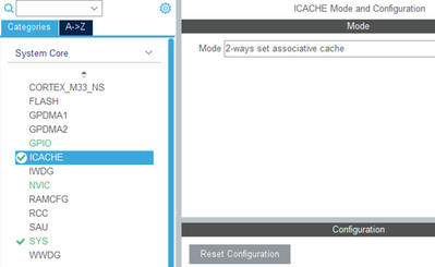

Once the project creation is done, enable the USB Peripheral in Device only mode and activate its interrupt in the NVIC Settings tab.

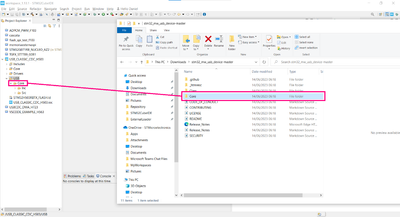

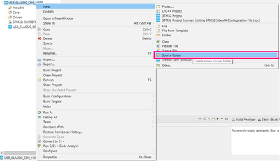

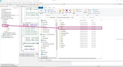

Once the code is generated, create a source folder in your project called USB.
Download the USB Device package from the GitHub (the same link presented in the introduction of this article). Open the software pack folder and import the Core folder into the created ‘USB’ folder.
Now, create another folder called ‘Class’ and import the desired classes to your project, in this case, the CDC is the only one selected.

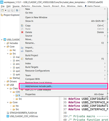

Add the path to the include reference. Right click in the ‘Inc’ folder inside the USB/Class/CDC/.. path, then select `Add/remove include path…` option, and in the pop-up menu, press OK. Perform the same steps for the USB/Core/Inc as well.

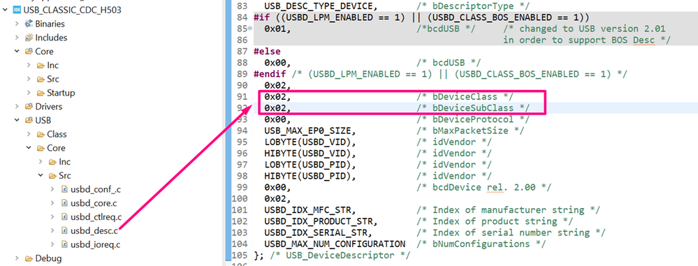

And change the descriptor settings, so the VCOM class can work properly (the lines 12 and 13 are the only ones that change from default):
__ALIGN_BEGIN uint8_t USBD_DeviceDesc[USB_LEN_DEV_DESC] __ALIGN_END =
  0x12,                       /* bLength */
  USB_DESC_TYPE_DEVICE,       /* bDescriptorType */
#if ((USBD_LPM_ENABLED == 1) || (USBD_CLASS_BOS_ENABLED == 1))
  0x01,                       /*bcdUSB */     /* changed to USB version 2.01
                                              in order to support BOS Desc */
#else
  0x00,                       /* bcdUSB */
#endif /* (USBD_LPM_ENABLED == 1) || (USBD_CLASS_BOS_ENABLED == 1) */
  0x02,
  0x02,                       /* bDeviceClass */
  0x02,                       /* bDeviceSubClass */
  0x00,                       /* bDeviceProtocol */
  USB_MAX_EP0_SIZE,           /* bMaxPacketSize */
  LOBYTE(USBD_VID),           /* idVendor */
  HIBYTE(USBD_VID),           /* idVendor */
  LOBYTE(USBD_PID),           /* idVendor */
  HIBYTE(USBD_PID),           /* idVendor */
  0x00,                       /* bcdDevice rel. 2.00 */
  0x02,
  USBD_IDX_MFC_STR,           /* Index of manufacturer string */
  USBD_IDX_PRODUCT_STR,       /* Index of product string */
  USBD_IDX_SERIAL_STR,        /* Index of serial number string */
  USBD_MAX_NUM_CONFIGURATION  /* bNumConfigurations */
}; /* USB_DeviceDescriptor */

uint8_t *USBD_Class_DeviceDescriptor(USBD_SpeedTypeDef speed, uint16_t *length);
 to:
uint8_t *USBD_CDC_DeviceDescriptor(USBD_SpeedTypeDef speed, uint16_t *length);
Make sure to update all the references related to these resources to avoid compiling warnings and errors.
Doing that, the editions in the usbd_desc.c are done, save this file and open the usbd_desc.h. In this file, edit the USBD_DescriptorsTypeDef exporting line to reflect the variable declared in the usbd_desc.c file. Since we did not change the resources name in this file, to make it easier to be followed, the standard name is used:
/* Exported functions ------------------------------------------------------- */
extern USBD_DescriptorsTypeDef Class_Desc; /* Replace 'XXX_Desc' with your active USB device class, ex: HID_Desc */
You can save and close both usbd_desc.h/.c files and move to the next one. In the following step, we need to rename the USB/Class/CDC/Inc/usbd_cdc_if_template.h and USB/Class/CDC/Src/usbd_cdc_if_template.c to usbd_cdc_if.h/.c. In the usbd_cdc_if.h file, add the following defines:

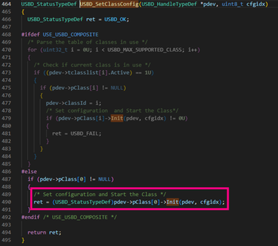

if(USBD_Init(&hUsbDeviceFS, &Class_Desc, 0) != USBD_OK)
      Error_Handler();
if (USBD_RegisterClass(&hUsbDeviceFS, &USBD_CDC) != USBD_OK)
      Error_Handler();
if(USBD_CDC_RegisterInterface(&hUsbDeviceFS, &USBD_CDC_Template_fops) != USBD_OK)
      Error_Handler();
if(USBD_Start(&hUsbDeviceFS) != USBD_OK)
      Error_Handler();
/* USER CODE END USB_Init 2 */

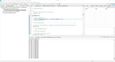

Now that you know how the demo works, let us try it. So, build (you should get zero errors and zero warnings) then click on the Debug button and wait for the debug session to be opened. Your STLINK might request to be updated. You can do so and then issue to debug again once it is completed.
Wait until the code reaches the breakpoint in the first line of the main function:
Then click on Resume, or press F8 to let the application start to run:

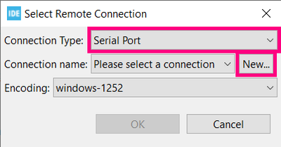

Let us open a terminal in the STM32CubeIDE to see the application running. For that, click o New  Shell console:
In the opened menu, select Serial Port for the Connection Type, then click on New…

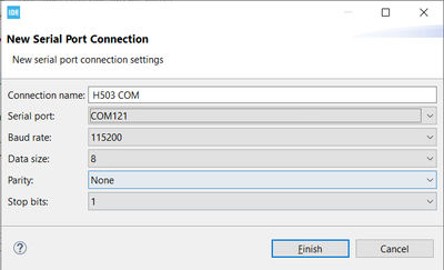

In the new menu, create a connection for your board. Make sure to select the proper Serial Port, then click Finish and finally OK:
Doing that, a console with a Virtual COM Port terminal opens and we can see our application running, printing the message on every 500 ms. If you type ‘1’ the User LED should be turned ON and ‘0’ will turn it OFF.

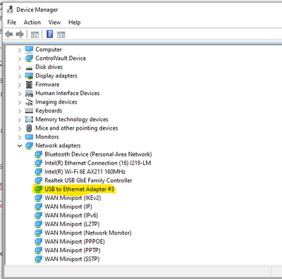

I have created a nucleo-h503 project and follow your descriptions, then every thing compiled/burn OK, but when I plug it into a win11 machine, it shows unknown device. I have checked again and nothing wrong. Could you create you project in Github and share it for comparison ? it will help a lot, thank you !
B.Montanari
Hi @Andy Tsai ,
I failed to add one step to allow the Windows recognize the driver properly. I'll update the article, but if you go to the usbd_desc.c, please change the descriptor to be like this:
I've added the code in my personal github as well, but I'll upload this to our hotspot as soon as possible.
Again, sorry for the missing step and thanks for reporting the problem.

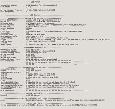

Andy Tsai
Associate II
Hi @B.Montanari ,
Thank you for your code. I clone your project and it runs perfectly. Then I try to figure out why my code has issues there. I modify the bDeviceClass & bDeviceSubClass as you mentioned. But it still not work. After many tries, finally I found it's the ICACHE issue.
In your code, if I enable the ICACHE in CubeMX and re-generate the project, the USB device enumeration will be failed. Using "USB Device Tree Viewer.exe V3.8.6", we can see:
Then if I disable the ICACHE and regenerate, and everything goes back.
My code was generated by CubeMX using nucleo-h503,  the default MCU running under 250MHz and the ICACHE was default enabled, but your code was generate by CubeMX by bare metal STM32H503, it's 32MHz and ICACHE disabled, that's why my code always failed even followed your instructions.
So my question is how to make the CDC run with the ICACHE enabled ?

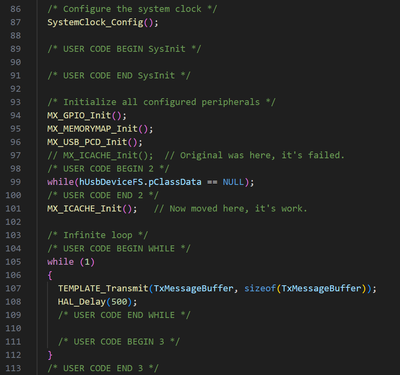

Andy Tsai
Associate II
Using @B.Montanari 's project and enable the ICACHE, We get the code of main() in main.c:
The MX_ICACHE_Init() generated by the CubeMX was in line#97, in this case, the USB enumeration failed. Now I move the line manually to line#101, then the USB works. I don't know why.

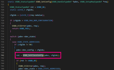

Great work @B.Montanari , I am porting to a H563 but I seem to be missing something with the USBD_CDC_Init.
This function is where pClassData is assigned to a Non-NULL value, but it is never called from the initialization routines. This causes me to hang up at  while(hUsbDeviceFS.pClassData == NULL); in main.c .
I realize USBD_CDC_Init is set up as a call back and is magically called somewhere in the depths of the init routines.  I have set a breakpoint in USBD_CDC_Init and it is never hit.
Any suggestions?  Help is appreciated.

Associate II
Attached is a working build for USB CDC for the NUCLEO-H563ZI.
It was built using STMCubeIDE version 1.14.1
I used terraterm to connect to the USB on the NUCLEO-144 PCB.
I have also included the CUBEMX .ioc file.
This is provided without warrantee or guarantee.  Do your own due diligence.   Don't expect the edited code to fall within the boundaries that CUBEMX requires for updatable code.
Cheers!
J
Greg Horler
Associate III
@JerryK Many thanks for providing this project, I am pleased to confirm it works as per the tutorial of @B.Montanari .
I will now compare my attempt with yours to try and establish where I have gone wrong.
Thanks again:beaming_face_with_smiling_eyes:
NikhilP
Associate II
@JerryK I Tried the code and it was working Properly. Thanks.

v_dimitrov
Associate II
@gbm Would you elaborate (or even better - provide example code) where you inserted the delay loop? I've tried doing it before
hcdc->RxLength = USBD_LL_GetRxDataSize(pdev, epnum);
in the USBD_CDC_DataOut function (usdb_cdc.c file), but to no avail.
@JerryK , @NikhilP , @ACand.3 , What you're fighting is exactly the bug gbm is speaking about, although JerryK circumvented the problem just by disabling the ICache resulting in slower code execution.
I implemented a delay (needs >= 8 ms with HAL) before the ICache init and placed it after the
hUsbDeviceFS.pClassData == NULL line which also solves the problem, but with the ICache working properly.
  MX_GPIO_Init();
  MX_USB_PCD_Init();
  /* USER CODE BEGIN 2 */
  /* USER CODE END 2 */
  HAL_Delay(8); // Minimum needed delay
  MX_ICACHE_Init();
Thanks again to @gbm for the troubleshooting and tracing the problem to the errata. Surely saved me lots of trouble and probably weeks worth of time.

D.Botelho
Hello @LukeJang522@NikhilP@ACand.3@JerryK!!!
Let me explain the usage of the function below:
 This is the simplest code that you can implement to wait the CDC Class to be initialized before doing any USB actions. To make the article as easy as possible to be understood and with a simple implementation, I've added a transmit code within the while(1) looping. But if the code reaches to this line before all the setup is done (enumeration phase) we will experience a Hard Fault as mentioned in some comments in this article. Since the CDC Class was not initialized before the pointer to the Class will be null, and access to it will fall into unknown addresses.
The implemented while looping will hold the code until the class is initialized. Of course it's not the better way to do that, but to present a simple example I thought it would work well.
Now, let me explain when this statement becomes false, allowing the code to continue.
When you connect the USB to your computer, it will start communicating to negotiate all the needed information to stablish the communication. During this phase, a Setup Stage will be issued to the Device side. At this time, the code will fall in the following callback:
Going through:
Again...:
And finally:
At this point, the USBD_CDC_Init(..) function will be called, fill the pClassData information and your application will be ready to go!
Given that, you know all the expected flow to get the communication working and pass through the strange while.
I.E.: This while should be stepped automatically after you connect your device to a host and the enumeration phase succeeds. If even you are connecting the USB to a host and the enumeration is not happening, there is another problem in your implementation, and probably is not related to this while.
Hope the information help guys!

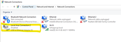

sai_sankar_rao_R
Associate II
@B.Montanari
I hope this email finds you well. I am reaching out to discuss a technical challenge we are facing with the STM32L072CZY3TR microcontroller. Our goal is to implement Ethernet over USB functionality.
From my research, I understand that the CDC-RNDIS or CDC-ECM protocol can be used to carry Ethernet frames over USB, creating a virtual network connection.
so, for that I used the stack from STM32 GitHub repository. "GitHub - STMicroelectronics/stm32_mw_usb_device at 2022e75b01a499b17acd17d28691b1ed5bbef2dc"
but I landed with an issue where USB port is detecting network adaptor in device manger but disabled in network sharing options.
so please suggest some other approach to meet the ethernet over USB functionality or how to clear the issue.

After implementing the MX_ICACHE_Init() move and adding the 8ms delay the code seems to work pretty good.
I have yet to implement the CRS (clock Recovery system) suggestions from @JerryK as I'm not sure what problem this solves since the MX_ICACHE_Init() move seemed to resolve any early issues I had with getting this code working.
However, a remaining issue I have is if I pull the USB cable then plug it back it the program hard faults (on reinsertion.
HardFault_Handler() at stm32h5xx_it.c:85 0x8000de4
<signal handler called>() at 0xffffffb0
Get_SerialNum() at usbd_desc.c:382 0x800b394
USBD_Class_SerialStrDescriptor() at usbd_desc.c:328 0x800b2fe
USBD_GetDescriptor() at usbd_ctlreq.c:526 0x800abec
USBD_StdDevReq() at usbd_ctlreq.c:119 0x800a5ec
USBD_LL_SetupStage() at usbd_core.c:559 0x800a032
HAL_PCD_SetupStageCallback() at usbd_conf.c:39 0x8009a54
PCD_EP_ISR_Handler() at stm32h5xx_hal_pcd.c:1,783 0x80024d4
HAL_PCD_IRQHandler() at stm32h5xx_hal_pcd.c:1,015 0x8001ddc
USB_DRD_FS_IRQHandler() at stm32h5xx_it.c:209 0x8000e46
<signal handler called>() at 0xffffffa8
HAL_Delay() at stm32h5xx_hal.c:424 0x8001280
main() at main.c:195 0x800062a
This is the same place the code was hard faulting for me before I moved the ICACHE init code and added the delay:

Andy Tsai
Associate II
@J.Christ, hope this link can help you understand why:
https://community.st.com/t5/stm32-mcus/how-to-avoid-a-hard-fault-when-icache-is-enabled-on-the-stm32h5/ta-p/630085
In short, your reading deviceserial0 from a FLASH address after ICACHE enabled will cause a hardfault.
I met same condition before. My solution is to read it before ICACHE enabled and store it on a RAM variable,
In Get_SerialNum(void) I just get it from the RAM variable.
