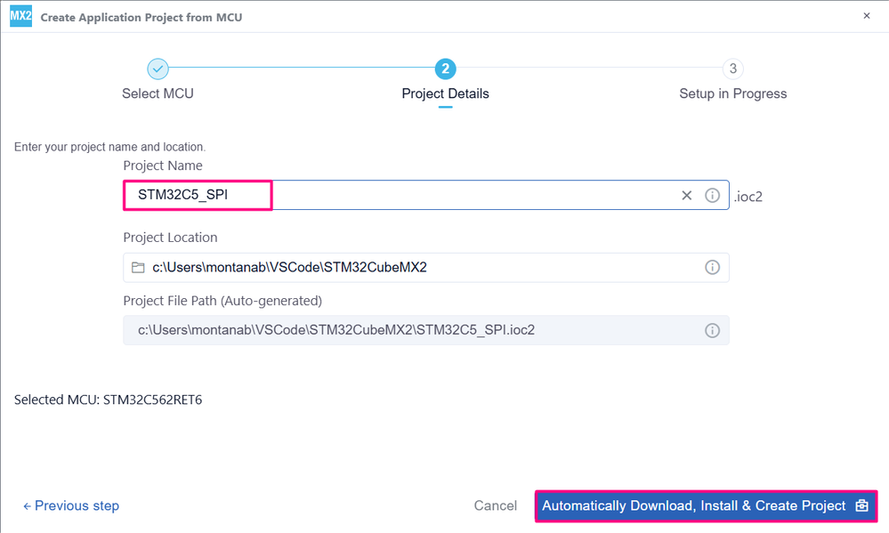

1.1 Project creation
Open STM32CubeMX2. On the "Home" page, click the [MCU square] to create a new project.
In the search field under MCU name, enter STM32C562RE and select the MCU. Click [Continue].
Enter the project name and location. Click [Automatically Download, Install & Create Project] to finish project creation.
Select [Launch Project] to start.

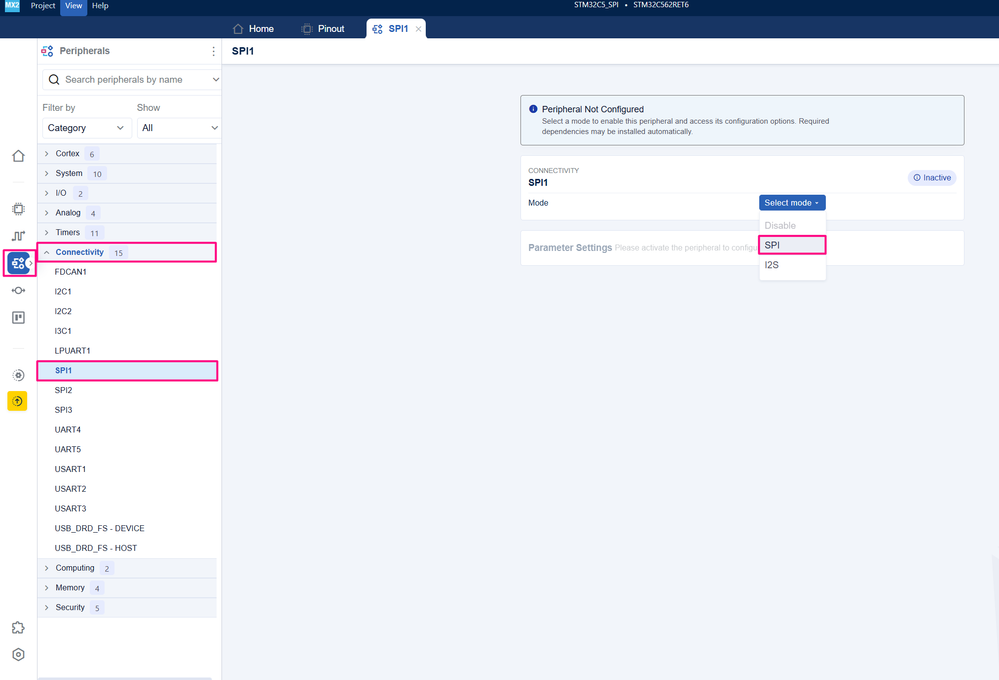

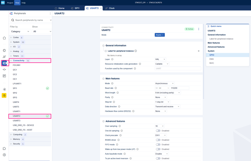

Navigate to the "Peripherals" section, then "Connectivity".

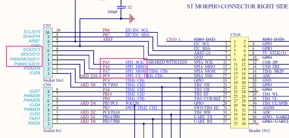

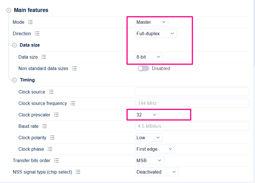

Enable the desired SPI peripheral, for example, SPI1 in SPI protocol and ensure the pins used. This tutorial uses SPI1, since it’s readily available in the connectors CN5 or CN10 via PA5 [SPI1_SCK], PA6 [SPI11_MISO] and PA7 [SPI1_MOSI]:
This demo will not reconfigure the clock, so the core and IPs run at 144 MHz. Configure SPI in Full-Duplex Master mode and set the clock polarity (CPOL), clock phase (CPHA), data size, and baud rate prescaler according to your application requirements. In this case, it is as shown below:

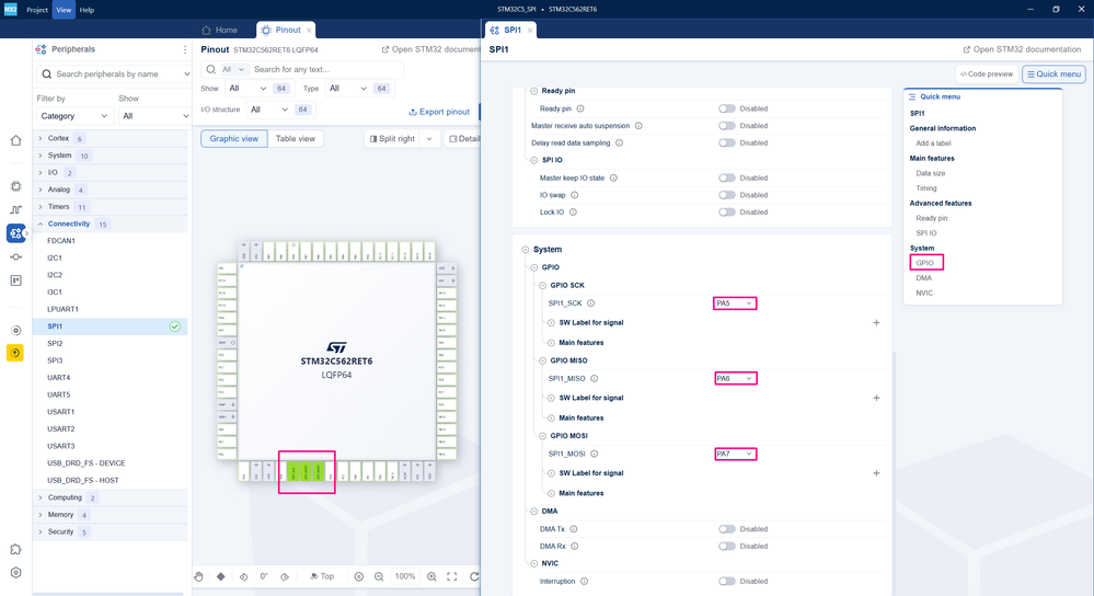

In the "Pinout" tab, SPI pins (SCK, MISO, MOSI, NSS) are already assigned. Optionally, configure an additional GPIO like LED or UART for status indication. In this case, a simple printf is used, so UART2 with PA2/PA3 is added.

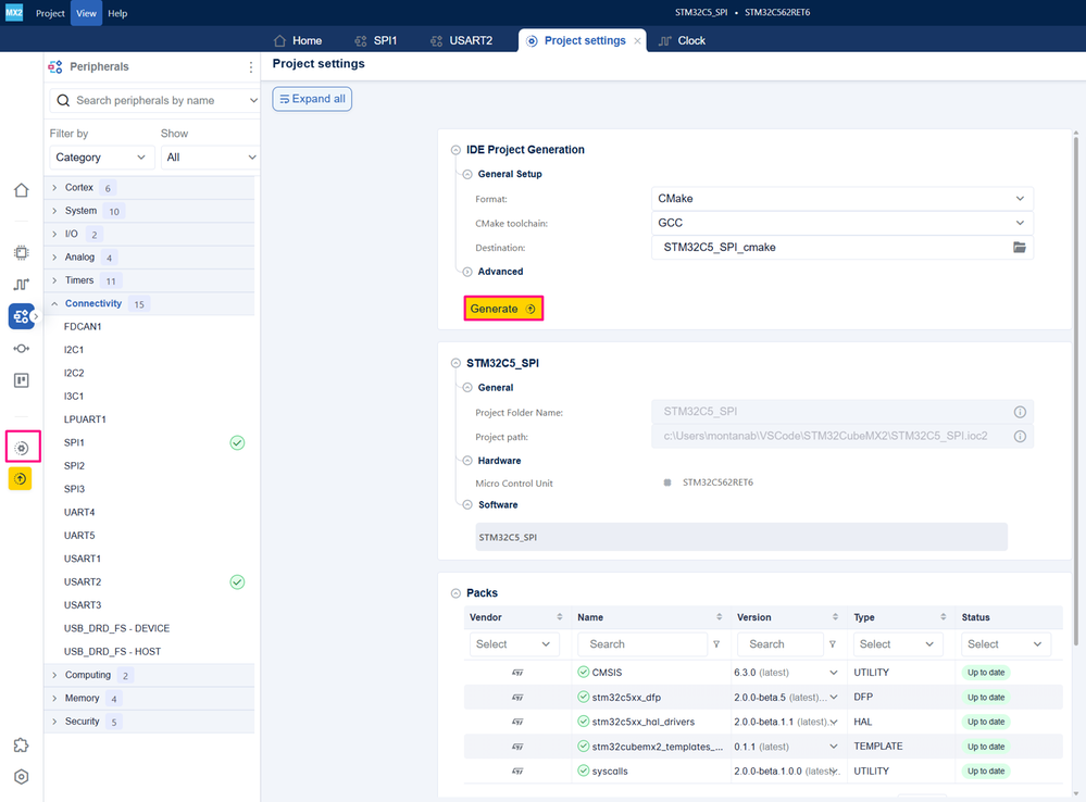

1.3 Code generation
To generate the code:

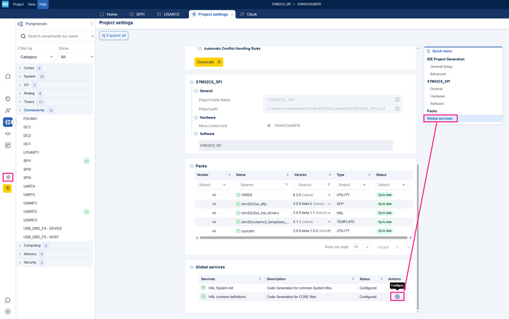

  1. Click the [Project settings] icon and select the desired IDE.
  2. Click the [Generate] button.

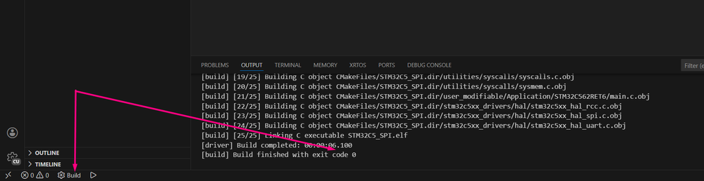

Build the project to ensure everything is set, then proceed to code implementation.

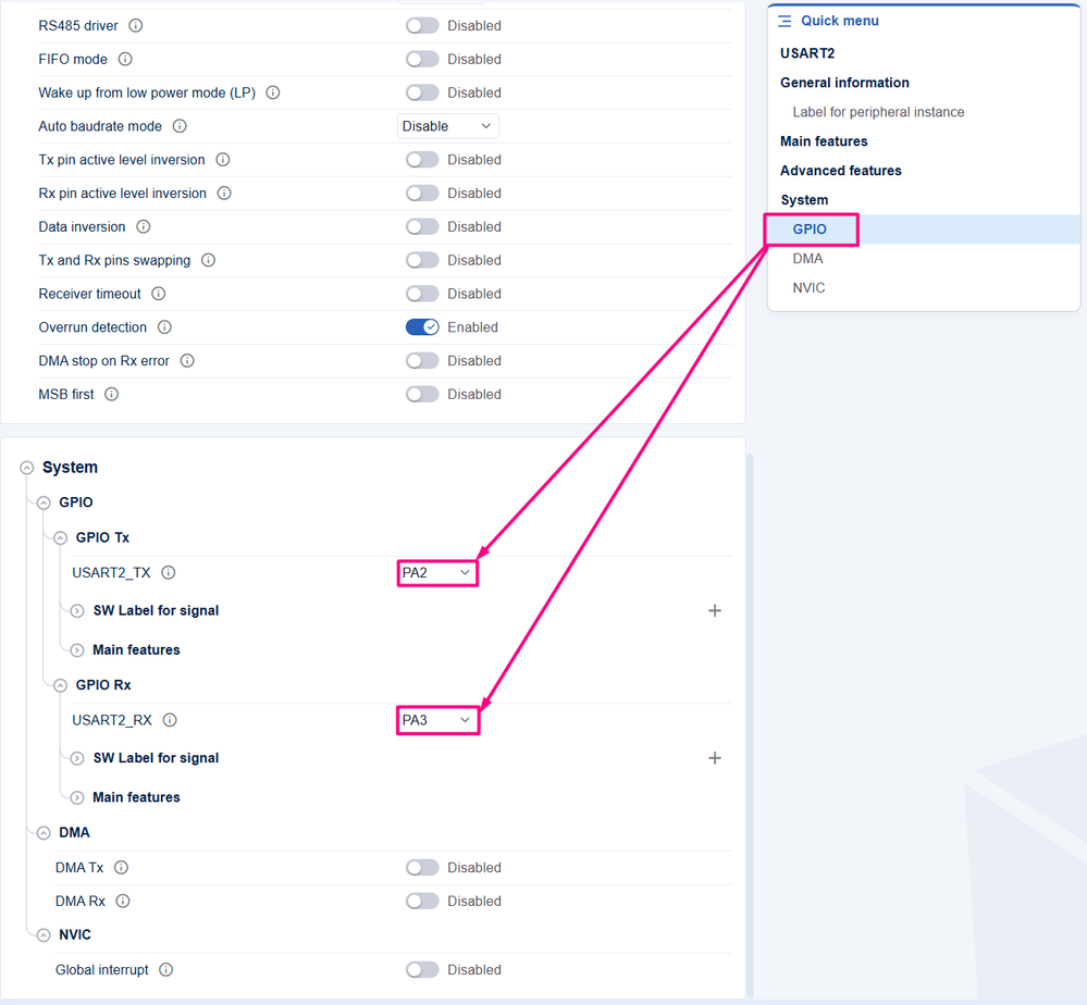

  HAL_UART_Transmit(mx_usart2_uart_gethandle(), (uint8_t *)&ch, 1, 100);

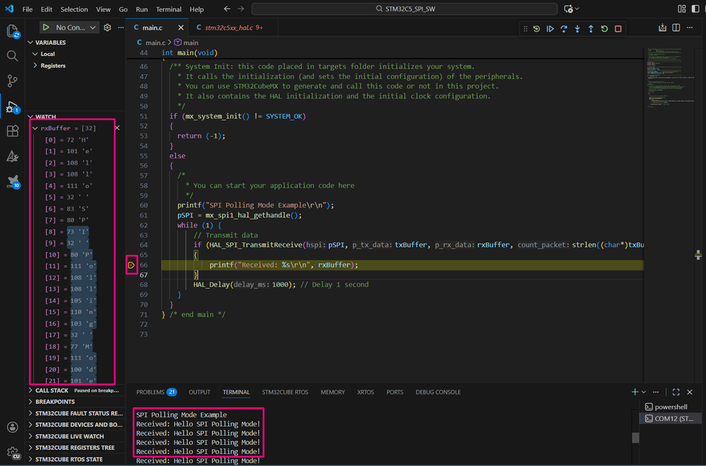

3.1.1 Validation

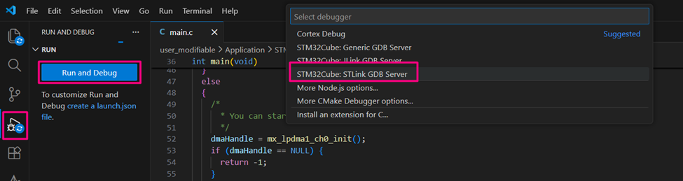

After building the application, locate the [Run and Debug] icon, create your debug session by selecting the STM32Cube: STLINK GDB Server option:
Once in debug mode and before running the code, press Ctrl+Shift+P and type [Open Serial] > COM40 (STMicroelectronics) > 115200.

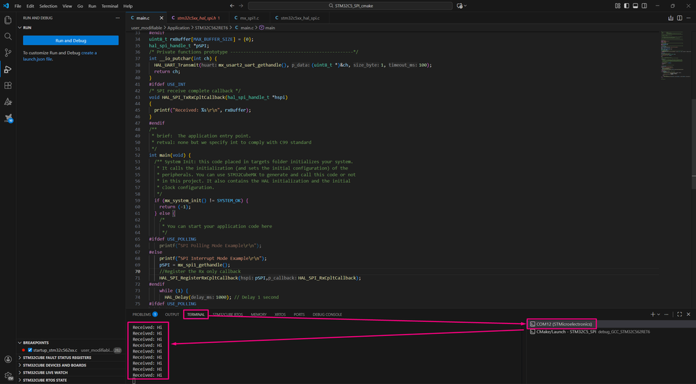

3.2 Code snippets (interrupt mode)
SPI can be used with interrupts to avoid blocking the CPU during data transfer. This is a simple example with a printf within the IRQ Handler, not ideal for real applications, but poses as a simple way to demonstrate the callback and interrupt functionality.

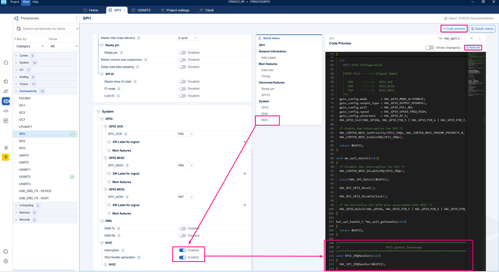

3.2.1 STM32CubeMX2 configuration

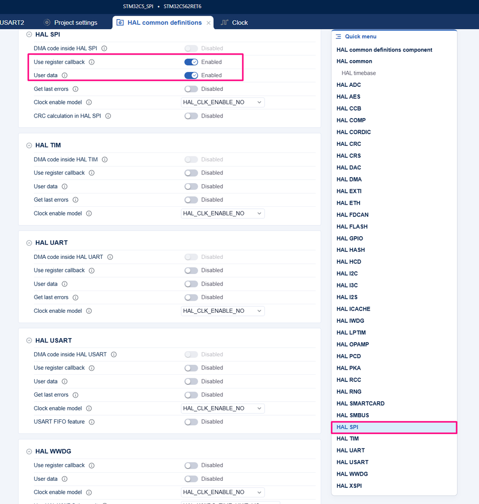

Enable [Global Interrupt] and [IRQ handler generation] under the "System" tab.
Assigning the interrupt callback.

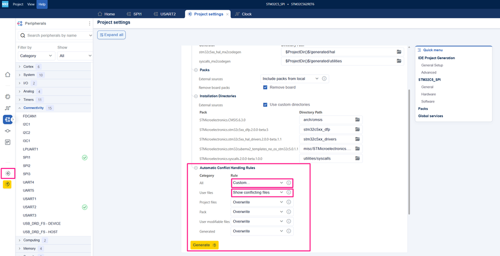

Generate the code with the updates. It is possible to keep the current main.c content by editing the Conflicting Handling Rules.

To validate the example, compile and enter in debug mode. The terminal should already be opened. Make sure to select it on the right side of the Terminal tab.

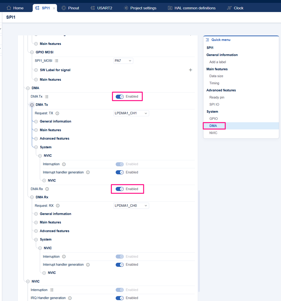

3.3.1 STM32CubeMX2 Configuration

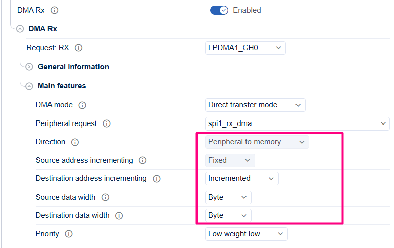

Enable DMA for SPI Tx and Rx in the System → DMA section. Enable [Global Interrupt] and [IRQ handler generation] for DMA.
The main features should be properly populated, such as the direction, address incrementing, and data width.
Upon making the changes, regenerate the project.

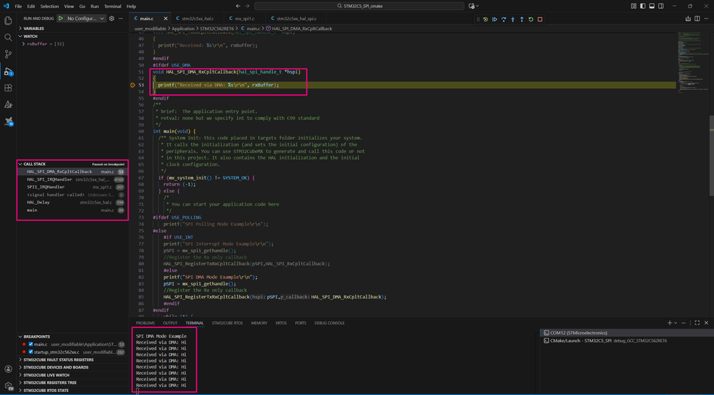

Once built, enter in debug mode, open the terminal, and check the message. A breakpoint can be added in the custom callback.
