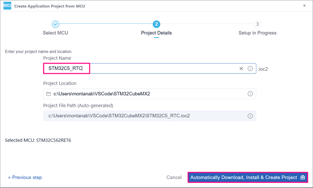

Enter your project name and location. Click [Automatically Download, Install & Create Project] to finish project creation.

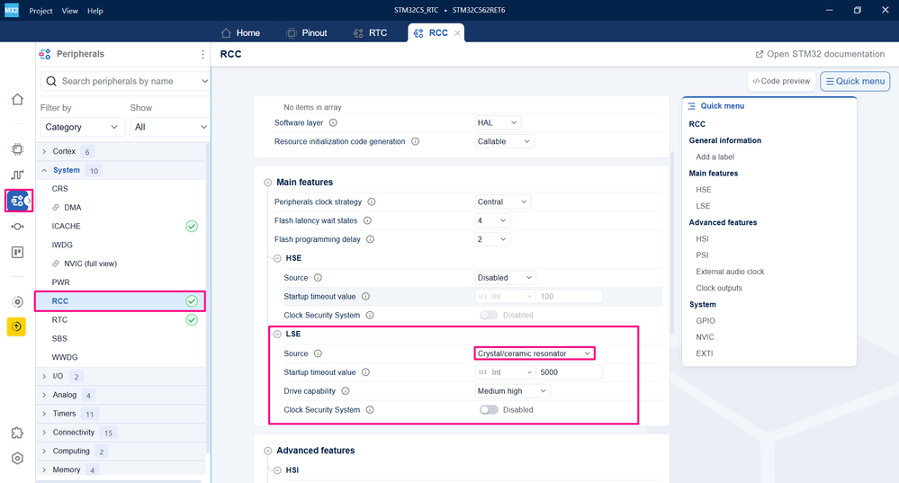

1.2 LSE configuration

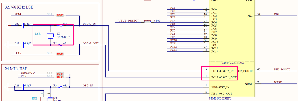

The LSE (Low Speed External) peripheral allows for the use of an external crystal or ceramic oscillator as a clock for RTC and other peripherals. The NUCLEO-C562RE is equipped with a 32.678 kHz LSE crystal oscillator.
Select the [Peripheral] icon. In the System drop-down list, select [RCC] and Enable the LSE by selecting the Source as Crystal/ceramic resonator.

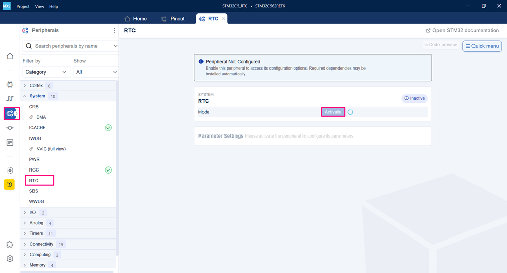

1.3 RTC configuration

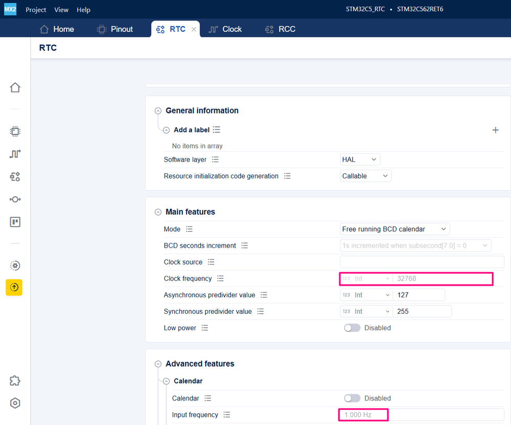

Enable and configure RTC in STM32CubeMX2. Navigate to the Peripherals tab. Open the System drop-down list and select [RTC]. A new page called RTC opens. In this page, select the [Activate] button to enable RTC.

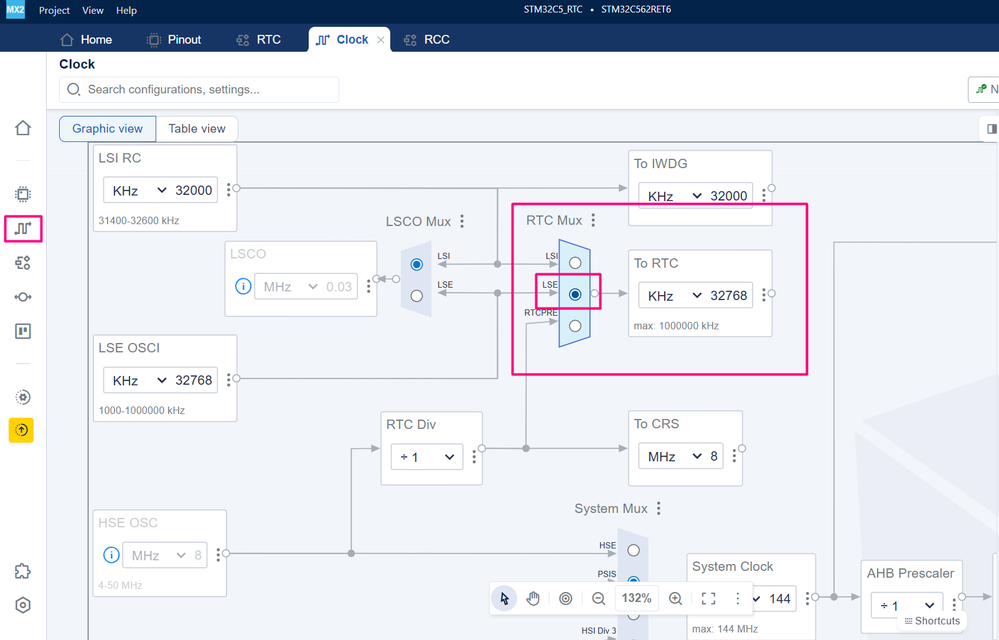

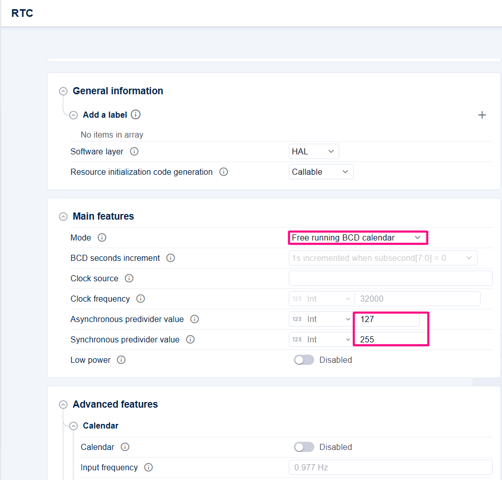

The default settings can be used, considering the Mode as Free running BCD calendar and the Asynchronous and Synchronous dividers with 127 and 255. You might notice that the Input frequency now is not 1 Hz, but rather 0.977 Hz. This happens because the clock source is still LSI. Once the RTC configuration is done, the LSE is added.
To use the embedded 32.678 kHz LSE crystal oscillator from the NUCLEO-C562RE board, go to the Clock tab and assign the LSE as the RTC clock input.
Go back to the RTC tab and observe the change in the clock frequency and input frequency.

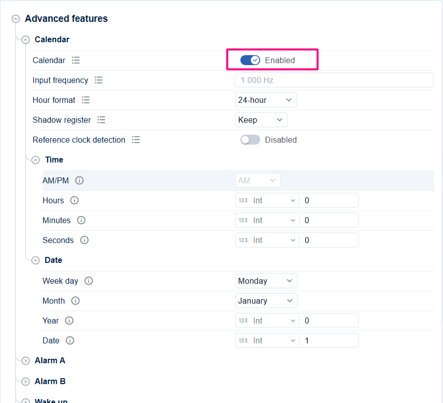

In the "Advanced features" section, go to Calendar and toggle it on. The default time and date will be kept for simplicity

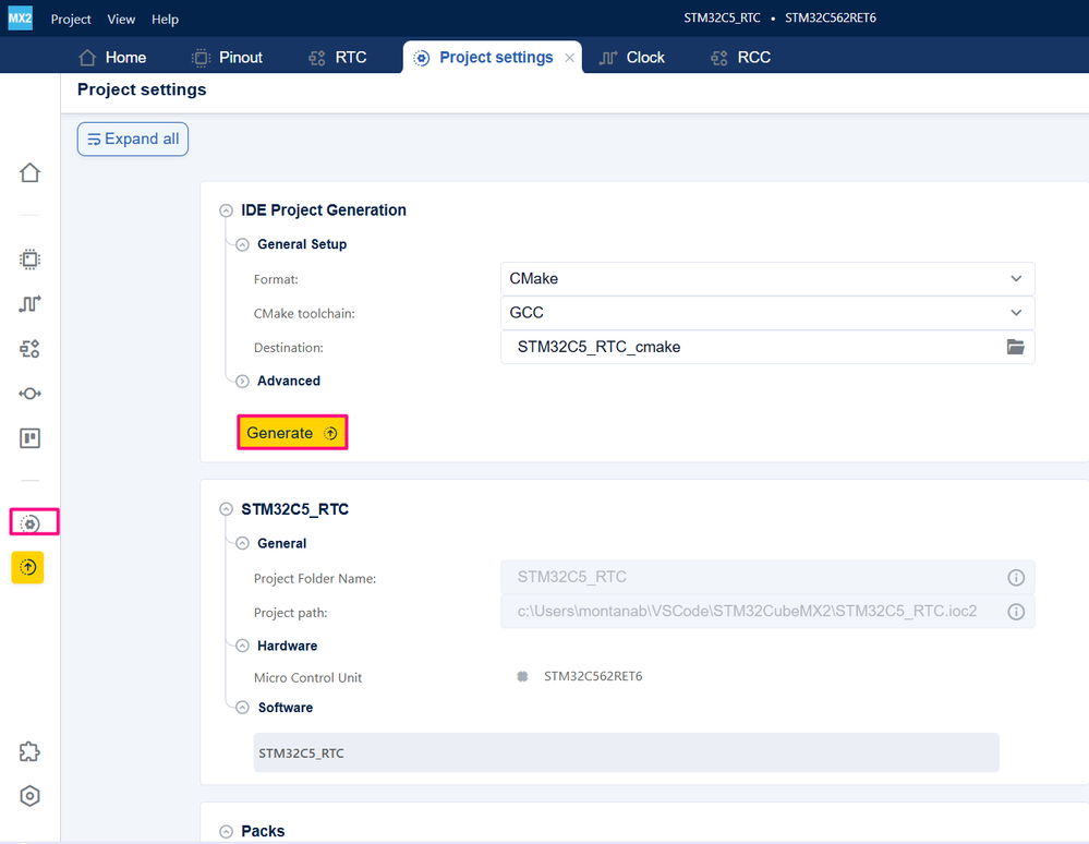

1.4 Generate project
To generate the code:
  1. Click on the [Project settings icon] and select the desired IDE.
  2. Click the [Generate] button.

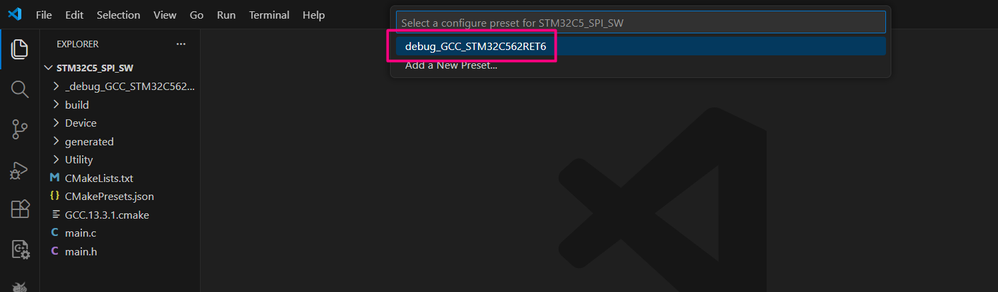

If prompted, select the configuration. If not prompted, press Ctrl+Shift+P, type CMake: Select Configure Preset, and choose the debug configuration.

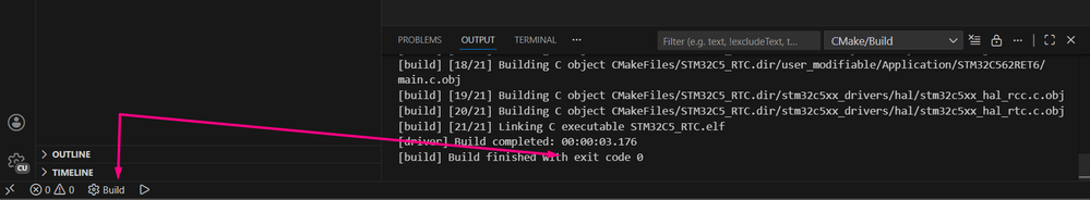

BMontanari_12-1769630329938.pngBuild the project to ensure everything is set, then proceed to code implementation.

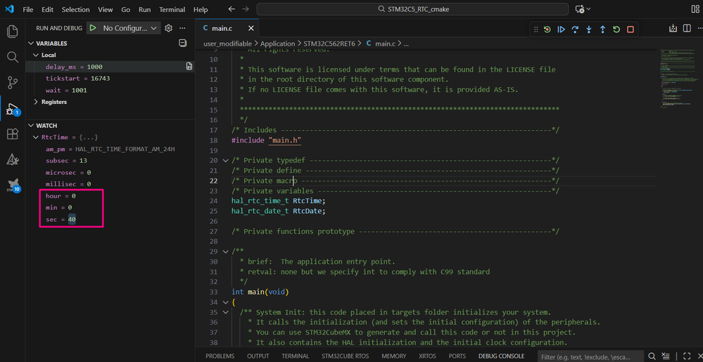

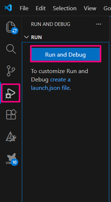

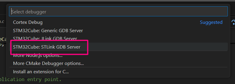

After building the application, select the Run and Debug icon. Create a debug session by selecting the STLINK GDB Server option:
Use the Watch feature in Visual Studio Code’s Run and Debug tab to monitor the RTC date and time variables. Set a breakpoint inside the while loop. Note: RTC continues to run in the background even when the debug session is paused.
